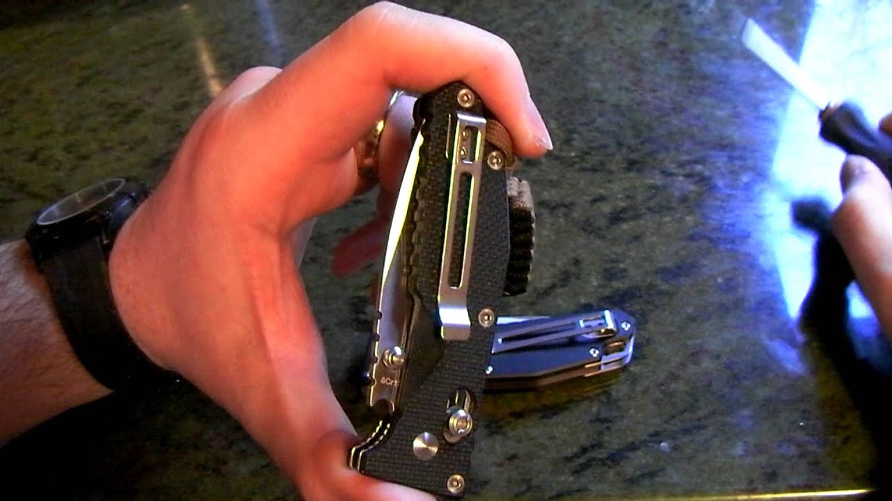

I wrote to Lazy Lizard who supplied my knife and e has a video about this.
It worked for me :slight_smile:
