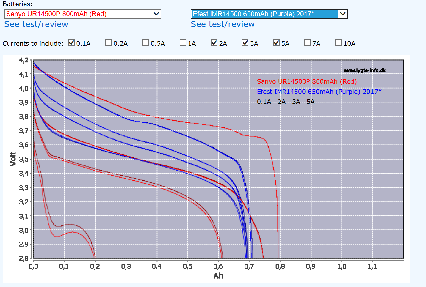

OP’s question was in context of Olight s15r which has max output of 280 lumen. I cant imagine this light wanting to draw more current than the UR14500P can provide - probably no more than about 1A. The OEM olight cell provided with this light is not a high drain cell either, looking at HKJ’s test results.
And yes as you say Pete7874, my idea is to know what type of performance I need. If my S15R use 1A maximum there is no point to choose a new battery based on they capacity to handle a 2A drain.
So you think the S15R should not drain more than 1A?
The Efest and the Sanyo will always be quite a nice improvement compared to the Olight battery.

@JohnnyBravo, what is this battery? It says "Sanyo" but the Sanyo is 800mAh, not 840mAh.
Thank you for the information g_sintornillos. My misunderstanding was not between Sanyo and Panasonic because I know they are the same, but about the value. And yes 840mAh is the typical capacity while 800mAh is the minimal capacity, that makes sense.
Regarding to the tests I will go for a Sanyo or Sanyo based (with protection). I just need to find a place to buy a good genuine one.
