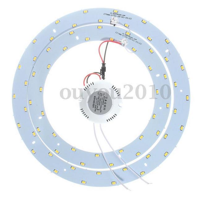

can some help locate a replacement for my ceiling light led driver . its round and has this letters C D L class 2 power supply model xps560fm14y input:ac 120v 60hz 24w output dc33v 650mA made by c RU us e353929

It is rare to see round LED drivers unless they come with the light. It is a matter of finding a driver that will fit the space inside the housing even if it is rectangular. What you really need is a constant current driver and one that is rated for 24 watts. I see them in 20W and 30W versions but nothing in between. Use the 30W driver.
Those little letters at the end of the description (CE RU us) are for rating agencies that are the Chinese equivalent of Underwriter Laboratories. When you see UL on an American light it signifies it has been tested for safety and accepted by Underwriter Laboratories. The Chinese version is the backwards RU. FCC means it will not interfere with TV and radio. CE stands for China Export and allows the product to be sold in the European Union. They are not the name of the manufacturer.
It might be simpler to just buy a complete retrofit kit for the light as long as it is not one that is on a dimming circuit. The lights that are rated for universal world voltage AC 110-220 can not be used on a dimmer circuit. You can find them on eBay. The one shown below is 24W and the price with shipping is $11.02 That’s not much more than you would pay for the driver alone.
eBay description: “Round led module 12w18w24w36w40w replace ceiling lamp retrofit Light 110V-220V”

thanks , let me understand what you refer. do you mean that i should unscrew all the circle led boards from the fixture chassis and just screw on this ebay led plate that include driver and leds 48 of them??? but the diameter total is 170 mm = 6.6 inches and my fixture is 13” diameter. so you recommend it anyway
OK, i got it you are right thanks a million
Yes, remove the existing LED parts and use the new ones in their place. The new parts have strong magnets attached to the back of the plate so you just stick it in place and connect the wires.
I used a couple of these to replace the incandescent bulbs in ceiling lights. You can get them in various light levels. Some of the newer lamps with SMD 5630 LEDs may be brighter than the older lights that used smaller SMD 3528 LEDs. An alternative design is called “annular ceiling light” and may be closer to the design you already have. Just be sure to choose one that uses 110V.
Just enter “annular LED ceiling light” in the eBay search box and use the “price + shipping lowest” in the sort box
