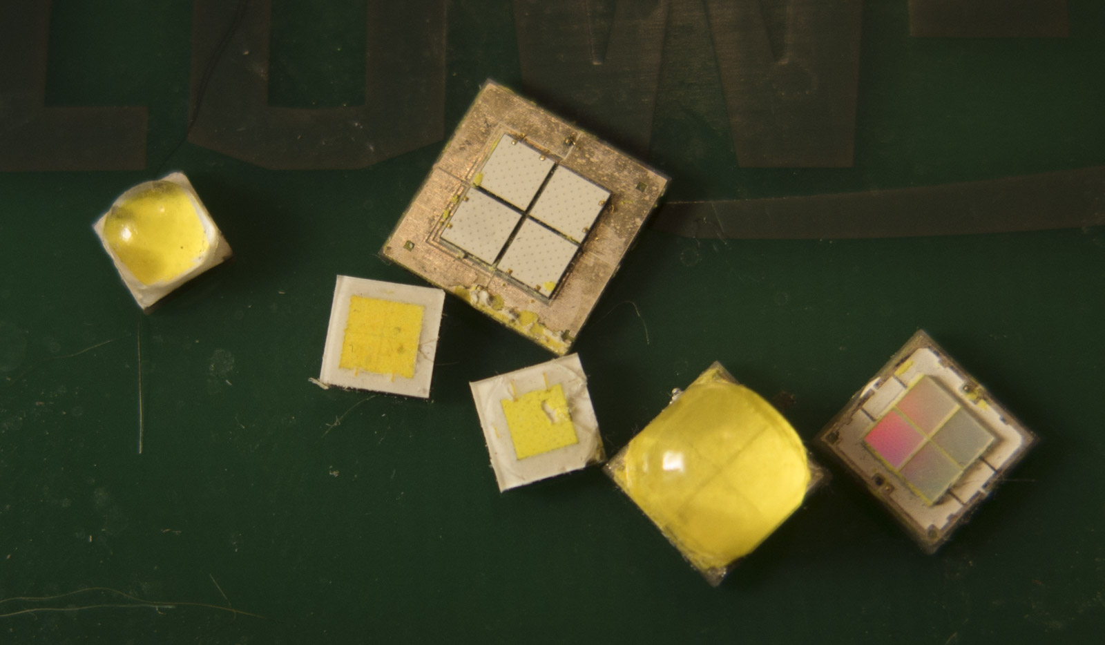

some LEDs from flashlight repairs from my customers
test bench XHP50 which had some while ago som dirt on dome and now burned itself deeply into the dome

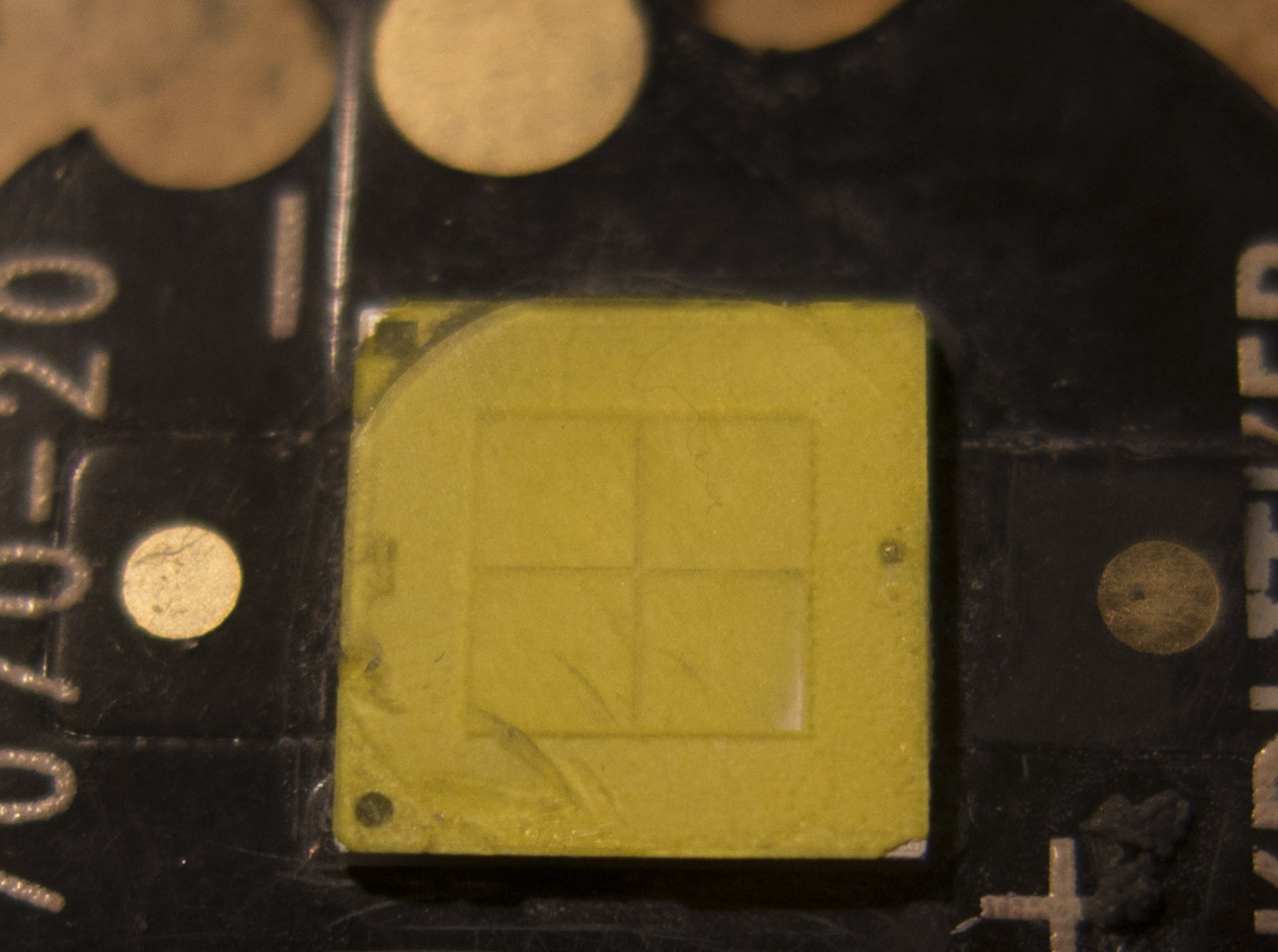

dedome fail XHP70
first attempts of domepolish, washer too flat sanded bond wires through

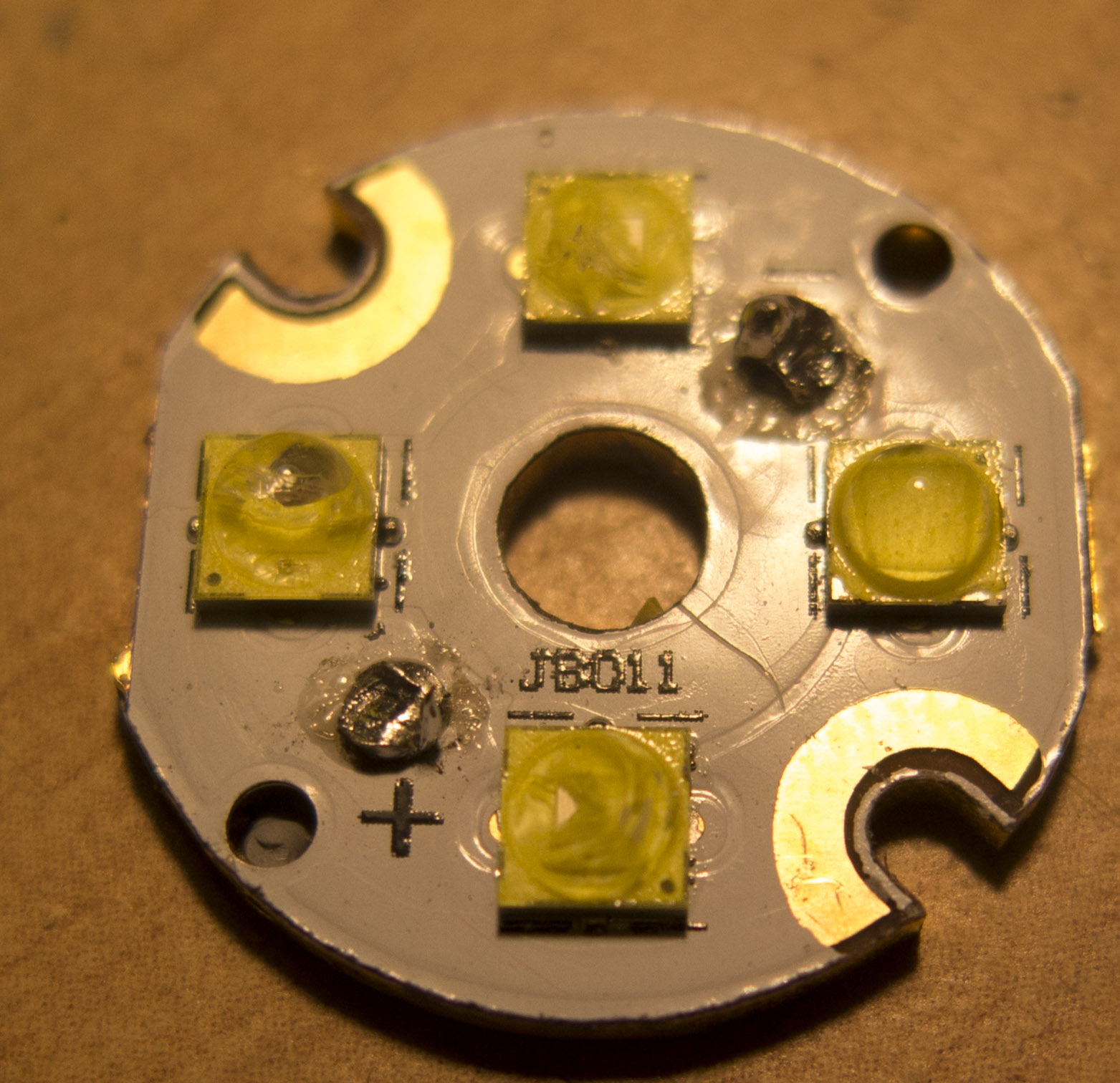

Someone put 2 18350 in his modded Eagle Eye X6 and blew the bond wires
someone damaged his XPG3 in his Astrolux S42
XHP70.2 dedome fail, cutting the dome made ruptures in silicone all the way down to the die, polishing failed

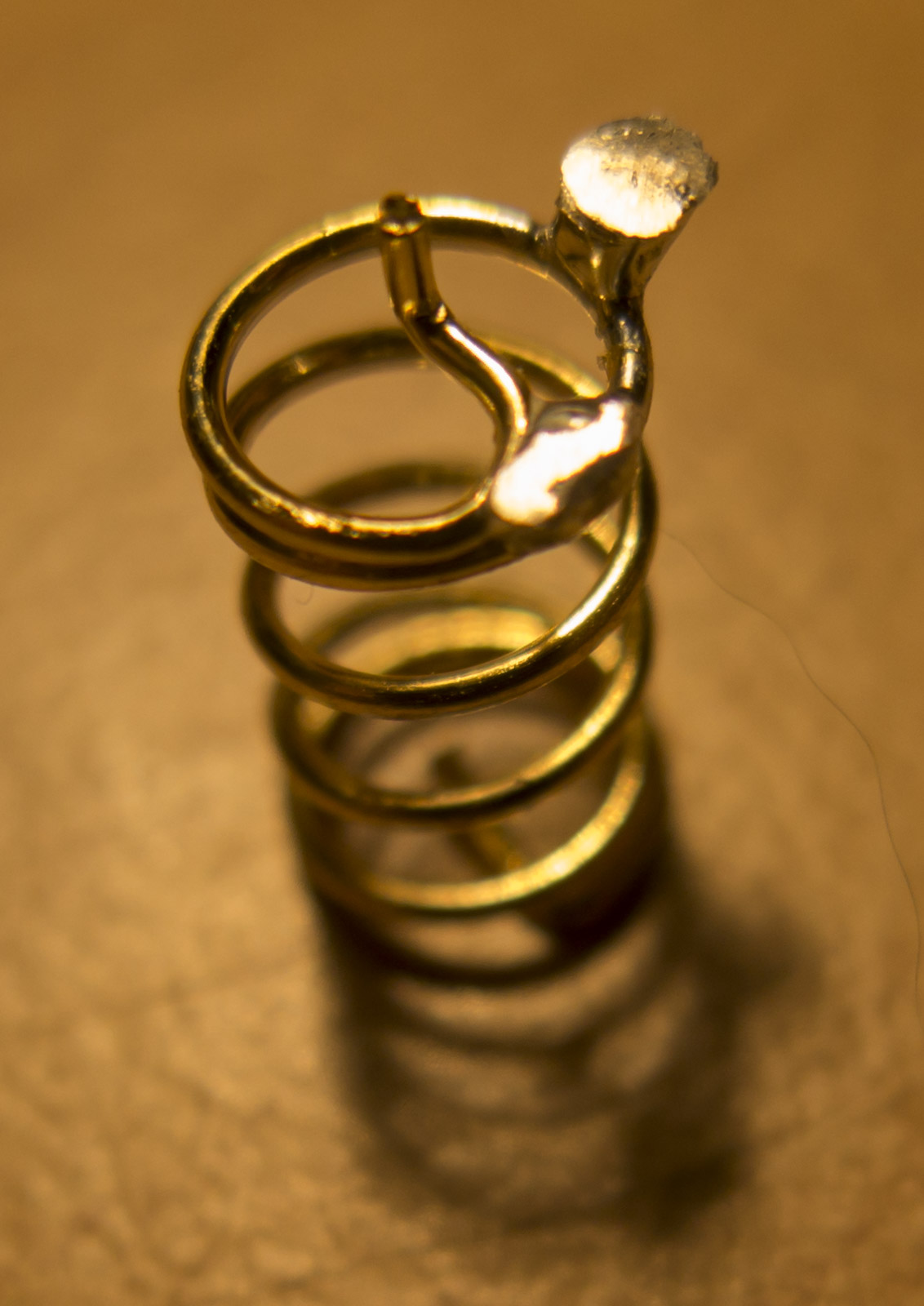

Imalent driver spring fail

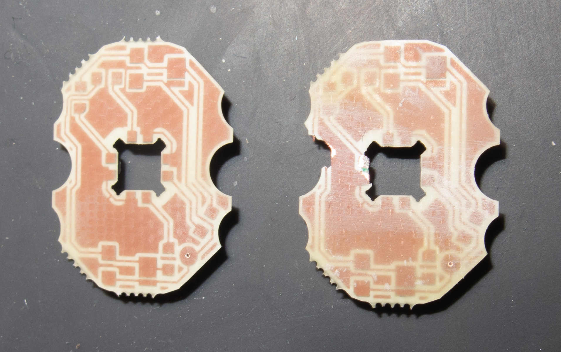

TA driver short abetween Ground and LED-pads through bad placed vises

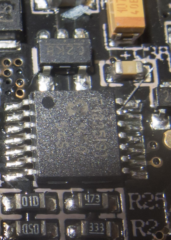

Klarus G35 driver fail after a chip was on board shorting power between cap and MCU
