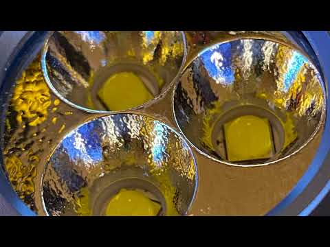

Since the review I’ve had a go at measuring Lumens with a lightbox.
Rather pleased that I recorded very close to the headline figure ![]()
But just look at the output after 30 seconds ![]()
| Make | Model | LED | Battery | Driver | Optic/Reflector | Mode | PEAK OTF lm | @ 30 sec OTF lm |
| Lumintop | FW21 Pro | XHP50.2 x 3 | Samsung 30T | Stock Anduril | OP | Turbo | 9,603 | 935 |
High mode seems to work much better and a lot more stable, even well beyond 30secs. But a huge difference between Turbo and High.
| Lumintop | FW21 Pro | XHP50.2 x 3 | Samsung 30T | Stock Anduril | OP | High | 1,380 | 1,351 |
Mine isn’t performing as well as it should be. I tried cleaning the contacts and head but it hasn’t made much difference. The cell could be degrading but I tried it in an E07 and while it performed slightly worse than a few months ago the difference wasn’t nearly as large as with this light. I want to clean the tailcap contacts but I’ve heard it can fall apart when opened. Apparently they’ve fixed the falling apart issue but some people still don’t recommend opening it. What should I do? Is there a safe way to open it?
Why does your review look like a video game
cant u just try a newer 30t or 40t to see if any difference ? perhaps the light is ok afterall.
There were problems with the first release of the FW3A but I believe it was addressed. I have 4 FW lights including the FW21 Pro and all have a retaining ring holding the tailcap parts in. I’ve removed the tailcaps on all 4 lights multiple times with no problem. If it makes you feel safer, remove the battery from the head end first, then remove the tailcap while keeping the light vertical. When reinstalling, tighten the tailcap very tight before tightening the head.
Thankyou . Nice real world review.
+1 to trying a different battery. Also, how are you measuring performance?
I’ve opened the tailcap on mine a few times. Hasn’t been an issue. The instructions tell you not too, but included in the box is a lanyard ring that replaces the pocket clip. The only way to install this is remove the tailcap……
