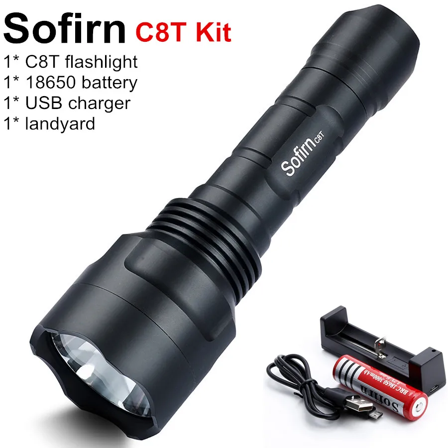

Wanna see something funny? Check this:
I really hope that isn't the cell bundled with the new C8F. :facepalm:

Genuine Sofire cell 9900mAh
I was gonna say 10,000mAh but we know that not possible.
In all seriousness, I just can't understand that C8T bundle. The C8T is pretty good, pulling up to just above 6A on a freshly charged Samsung 30Q. It does not bode well for that Sofire unless it is a genuine high discharge cell rewrapped by who knows who. Most ludicrous rewrap I've ever seen, at least if they aim to inspire confidence.
The only other 18650 on their site is this one: https://www.aliexpress.com/store/product/2-Pieces-High-Quality-2800MAh-18650-Battery-Rechargeable-3-7V-Li-ion-18650-Batteries-for-LED/2933049_32806585536.html ![]()
I wish they were to clearly state what OEM cell is under the wrap, but I guess whoever buys that just knows no better.
Cheers ^:)
The picture now shows 3000mah. These were tested to be a great cell. Equal to the 30Q in output.
So they must have upgraded it.
