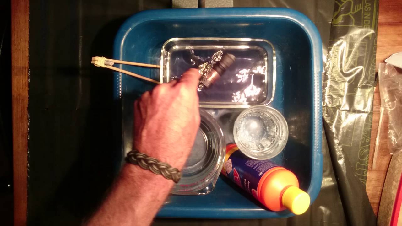

I would like to remove the anodisation entirely
I have read about heavy chemicals.
We have septic tanks so flushing down stuff like that is not an option.
However I can bring it to chemical waste if needed.
Would removing the ano ose the risk of it losing its smooth feeling?
