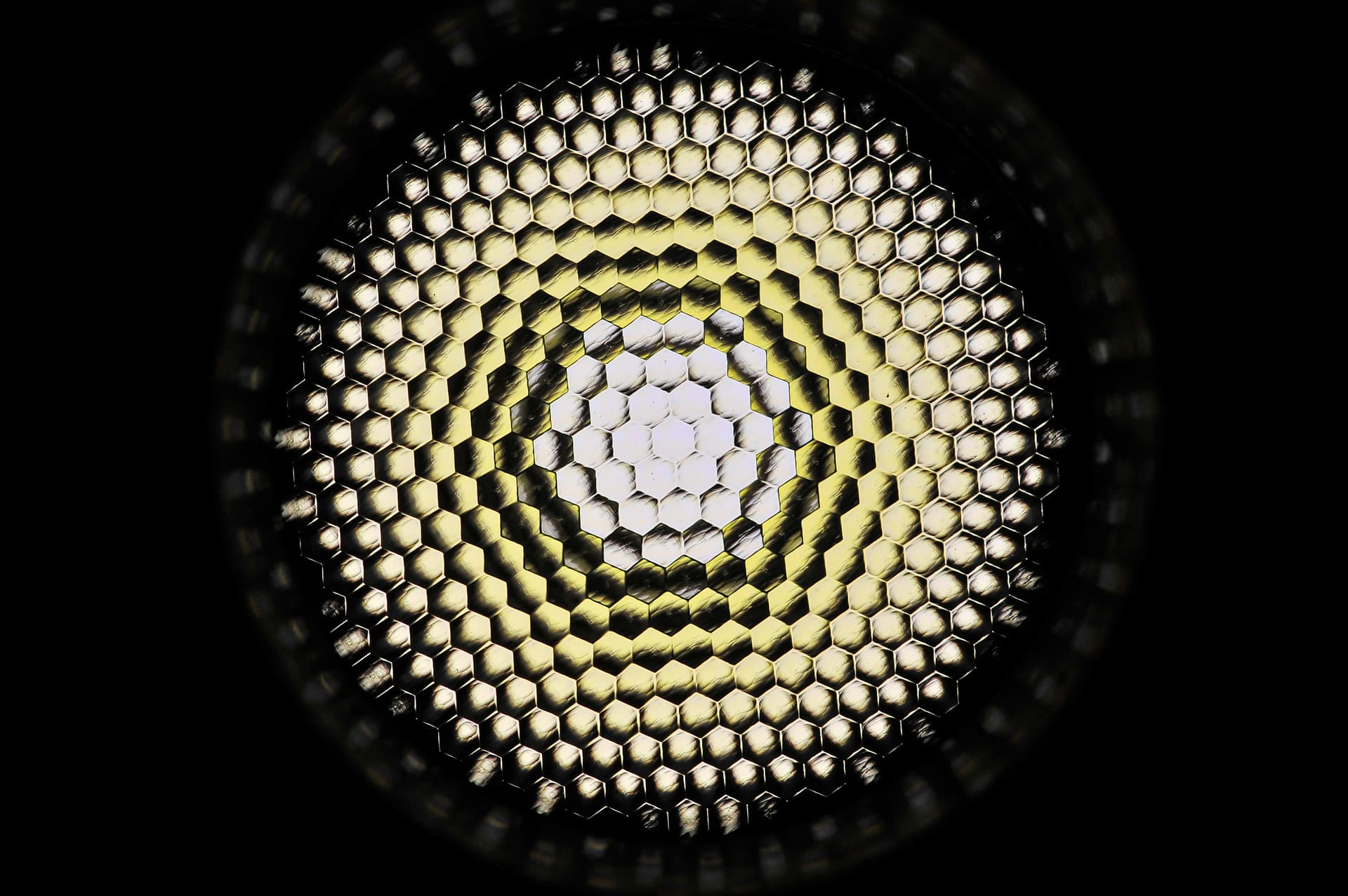

Looking into the head, we can see a TIR reflector and a polished metal bezel which keeps it in place and protects it.
The flashlight comes with a Samsung LH351D emitter. Cool white and warm white variants of the emitter are available.

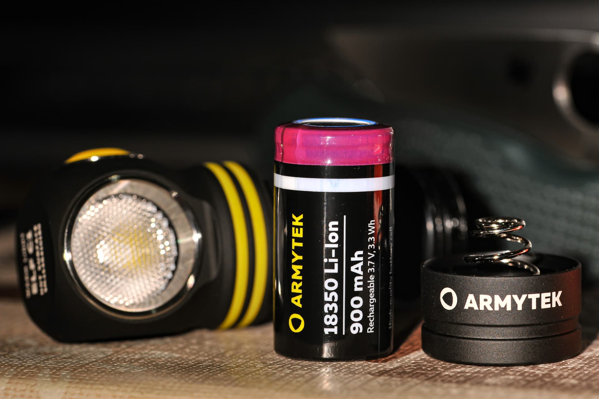

The tail piece contains a thick spring.
A dettachable pocket clip is also included.
The pocket clip allows for a deep pocket carry.
Finally, an Armytek branded 18350 battery is also part of the kit.
The battery is rated with 900mAh of capacity and is flat top.
