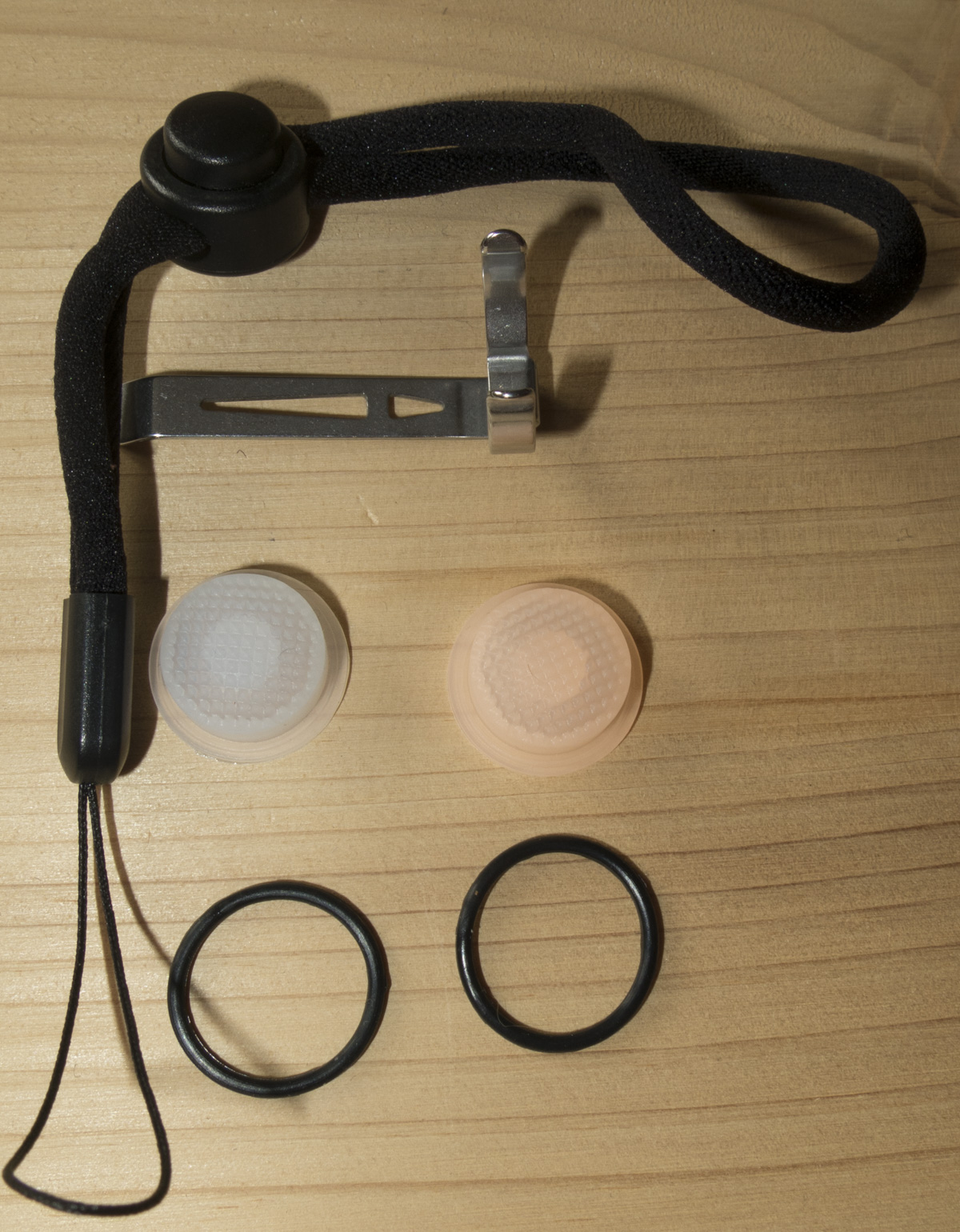

It comes with 2 spare o-rings, clip, lanyard and two half transparent switch covers one white and one copper colored

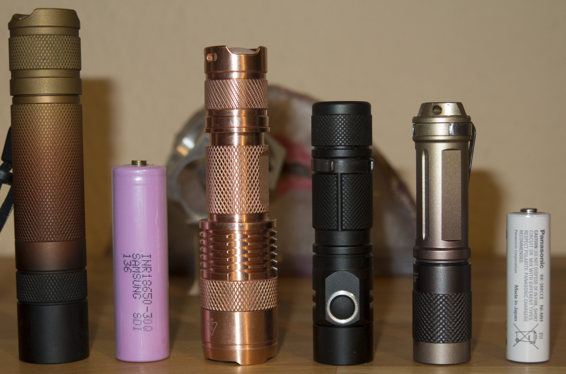

Size compared to other 14500 lights and a Convoy S2+ 18650 light
you can see that this copper light is really big for a 14500 light, I wish there would be a 18650 aluminum tube available

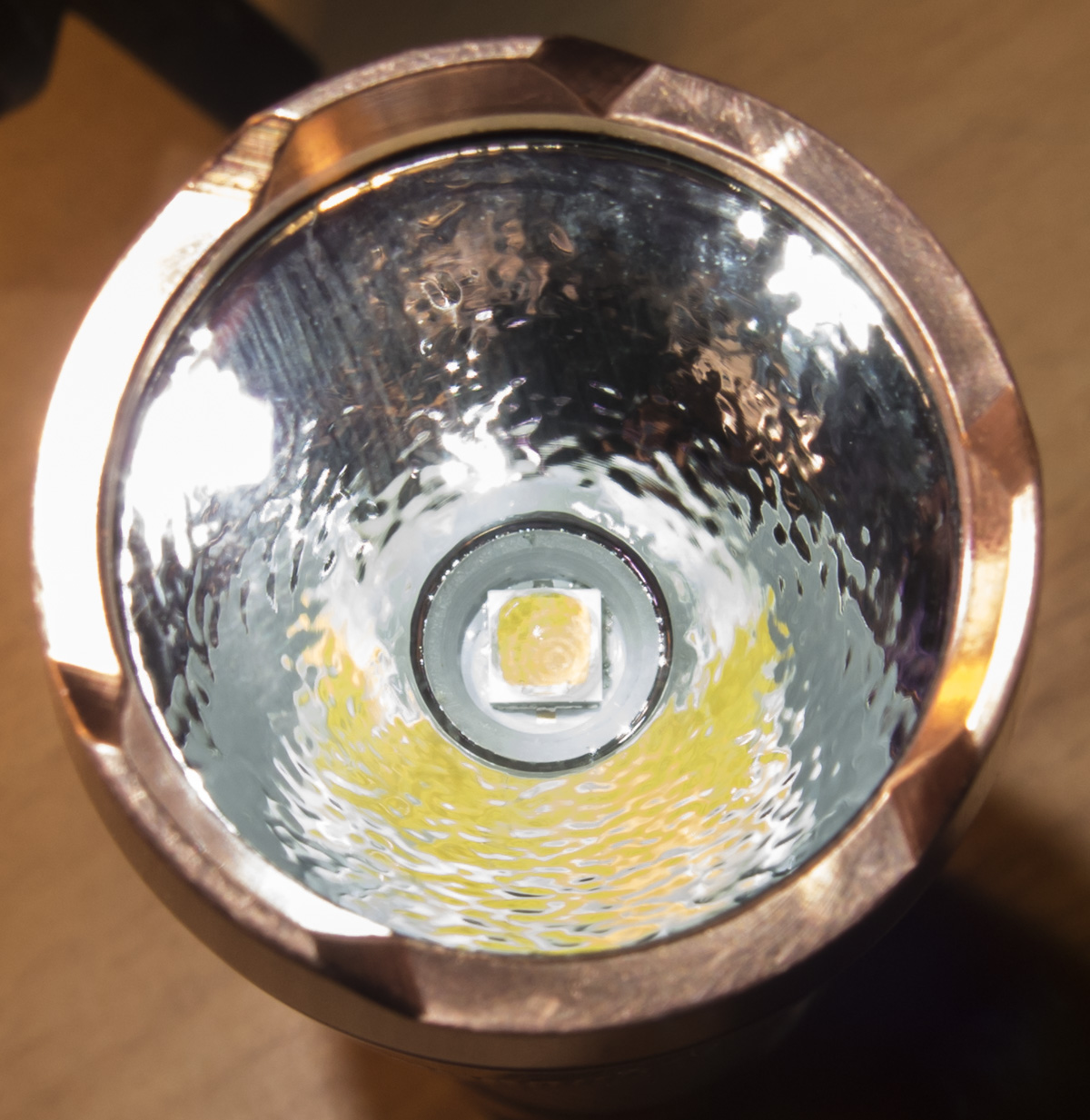

Beam color is neutral around 5000K for the 3D model, the XPL has a noticeable yellow tint shift in the hotspot

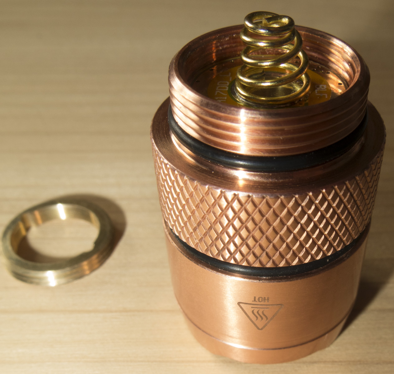

The light can be taken apart completely, nothing is glued

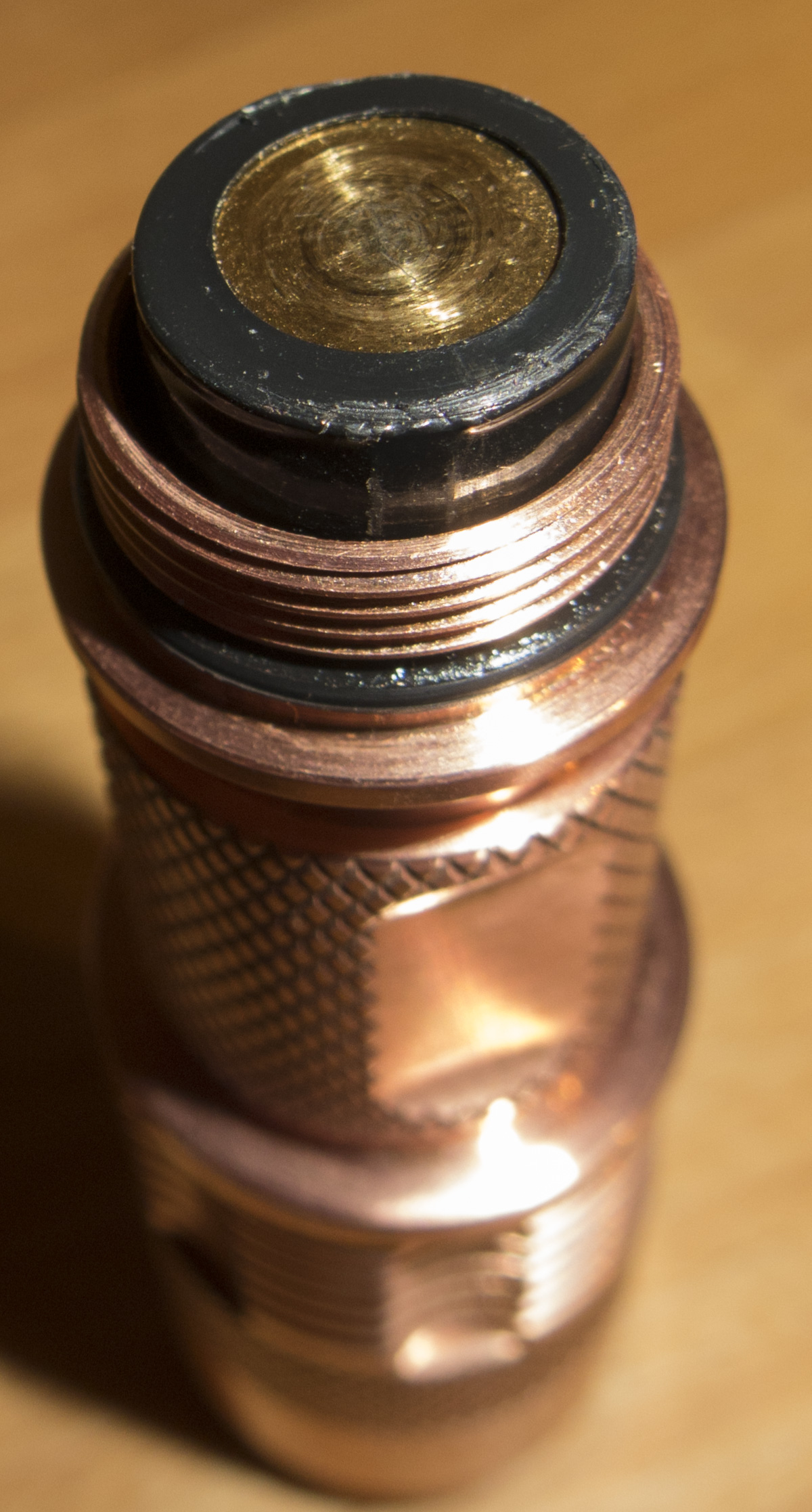

The light has the typical tail with 2 cutouts and one side with holes for the lanyard

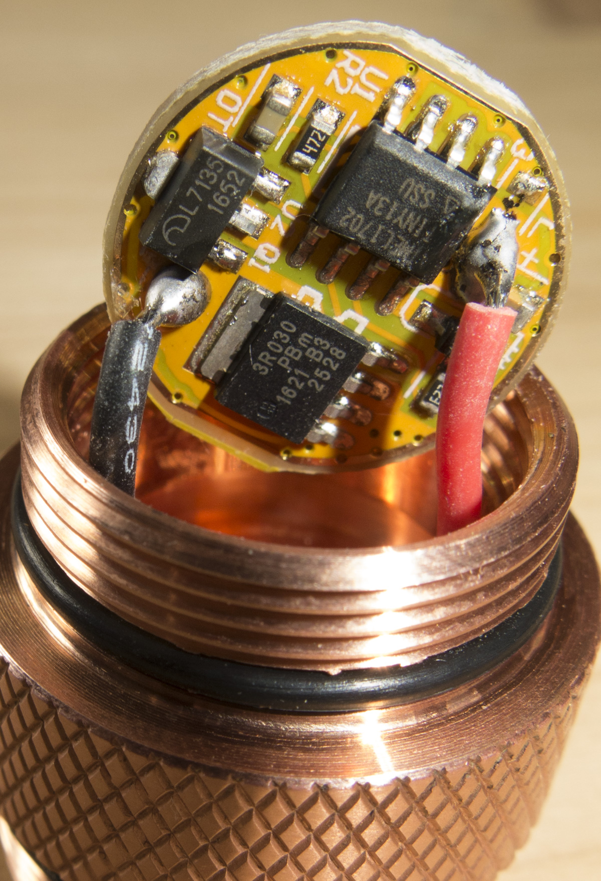

The head has a standard 17mm driver with Attiny 13A and FET+7135*1
The driver can be pulled out, the leads are long enough and have a medium thickness, shorter ones with more gauge would have been nice

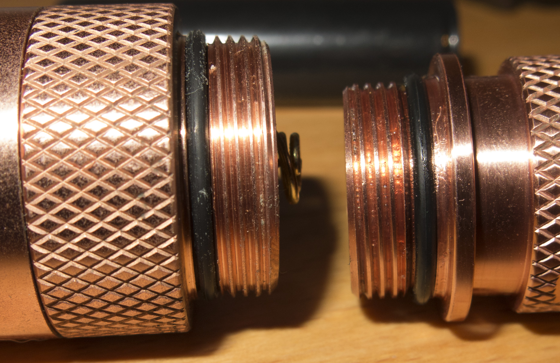

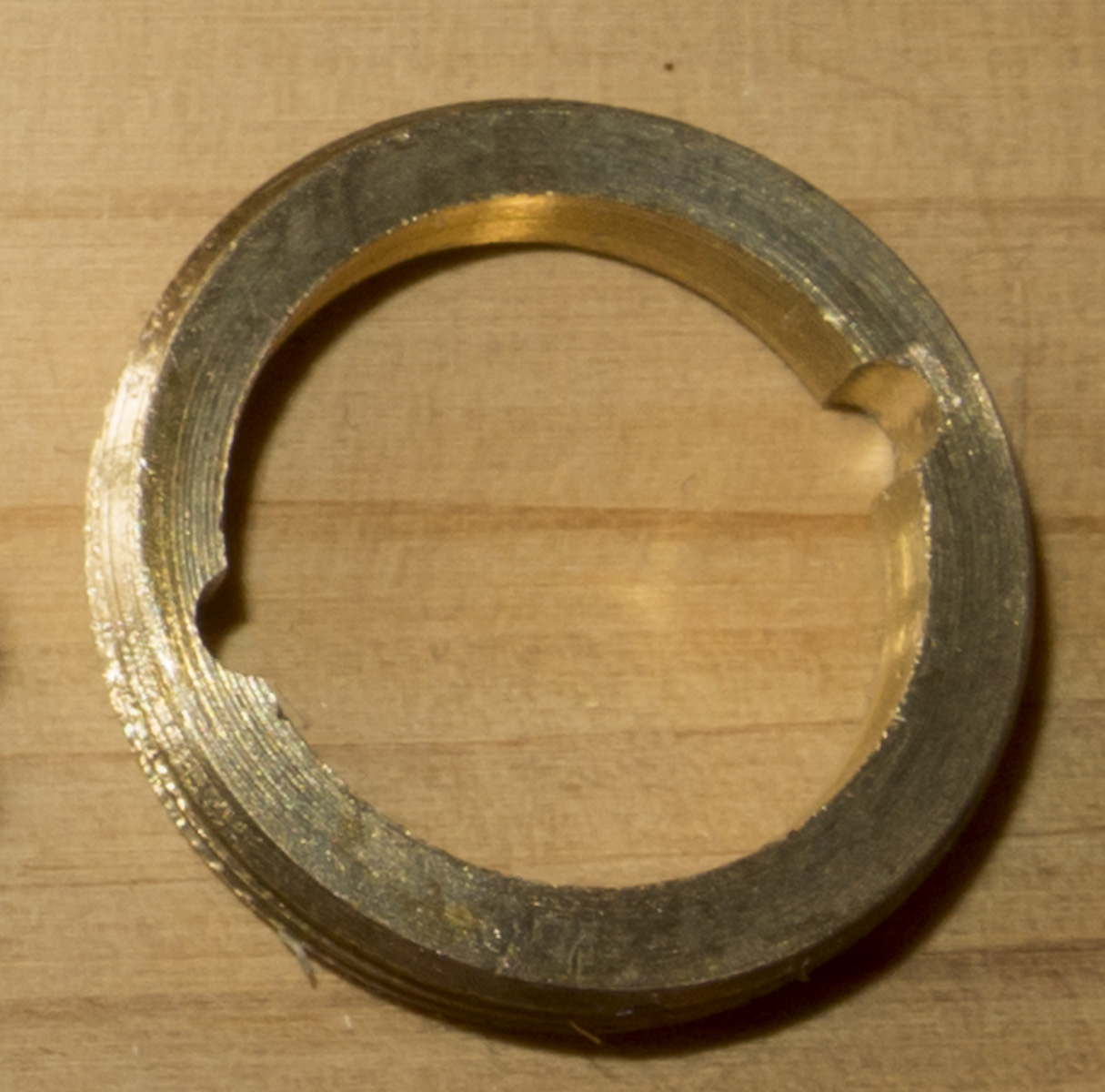

The threads are triangular cut, good quality but square cut would be nicer
the tail thread is a bit flat on the top, but no real square cut
The light can´t be locked out by twisting the tail cap

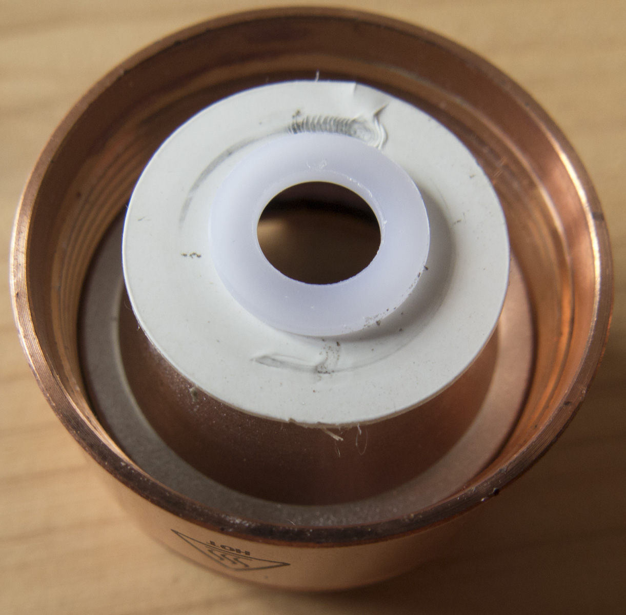

The Head

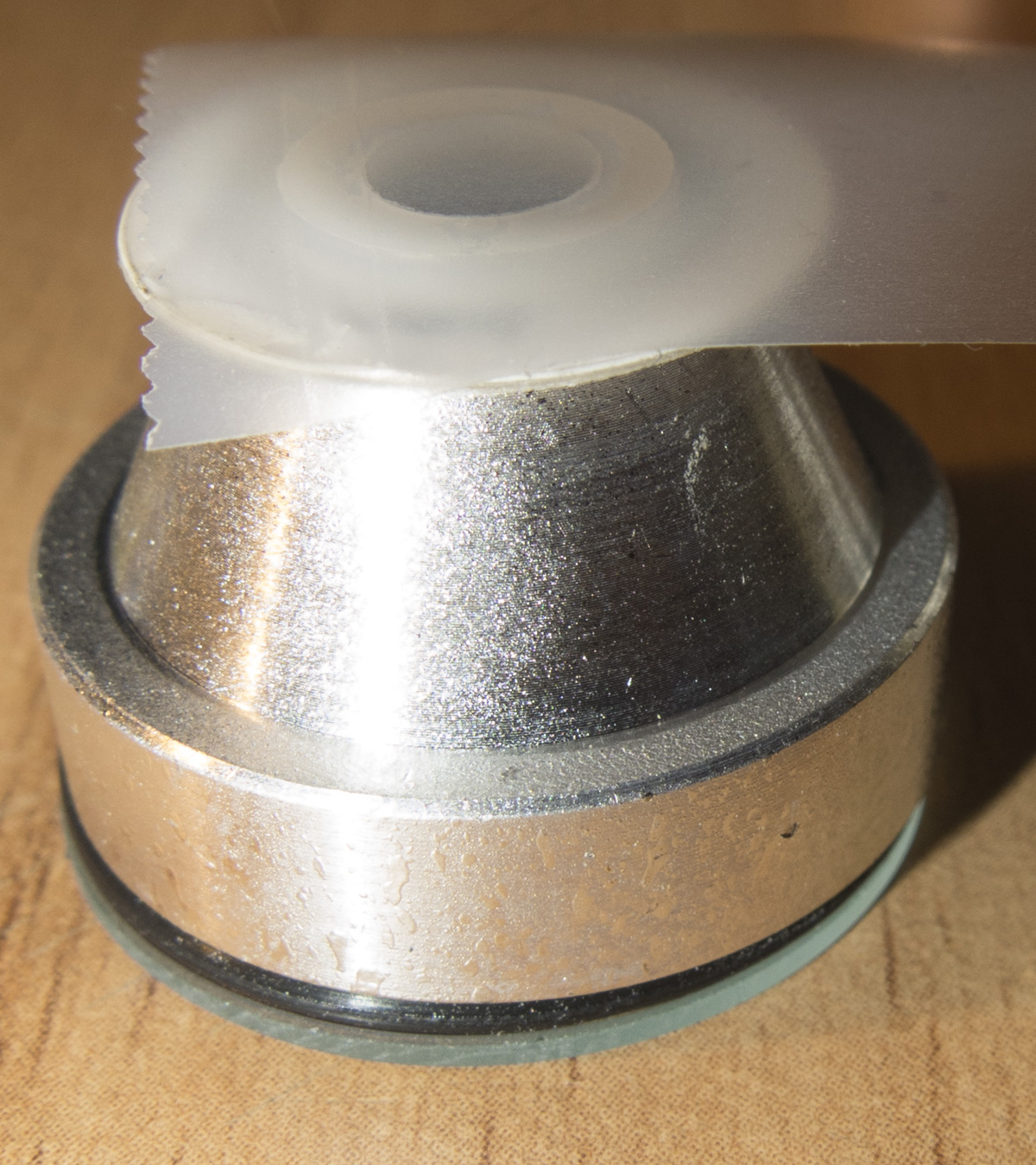

the reflector is a medium orange peel

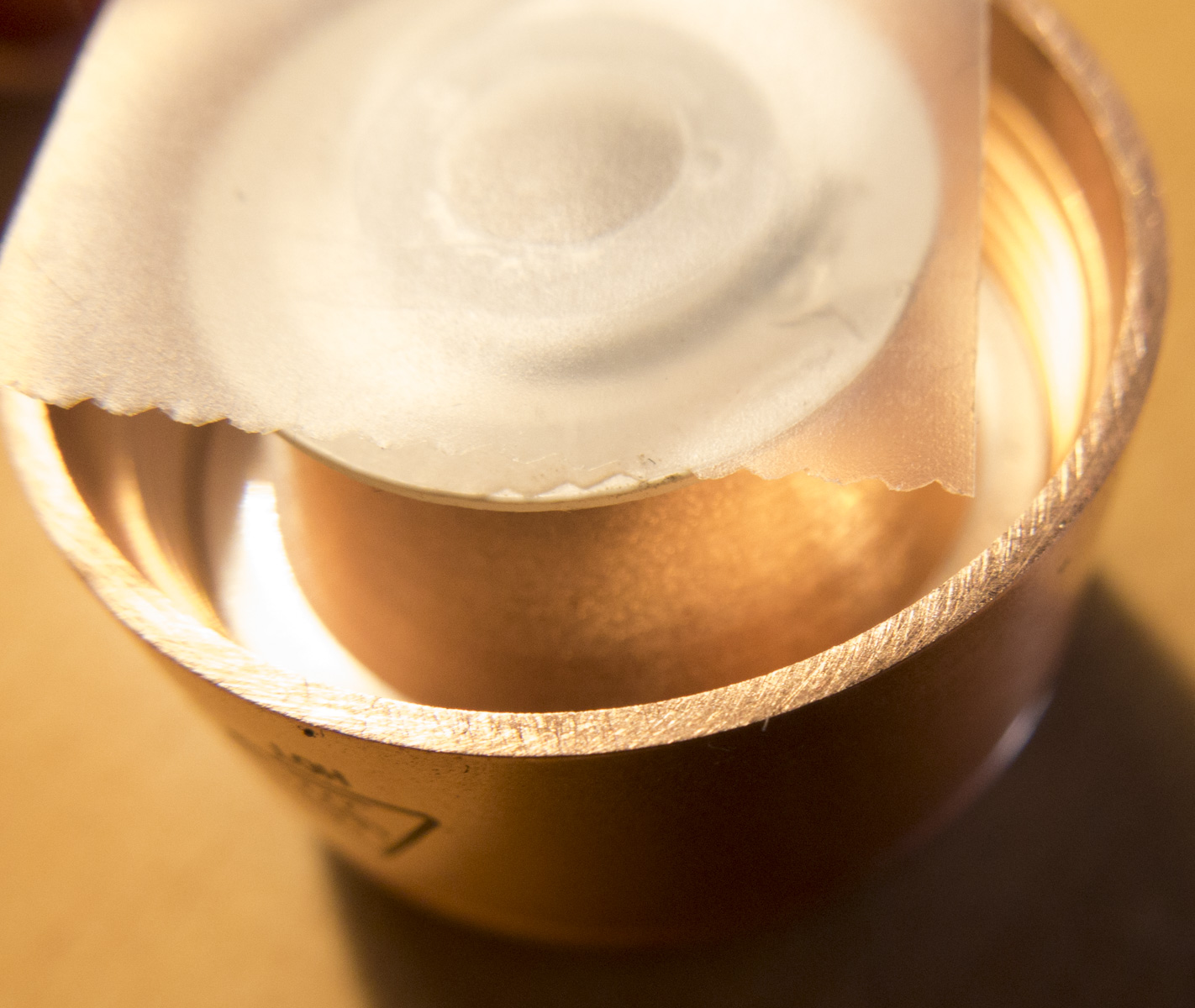

the XPL HD LED is centered OK, but the centering ring is a bit larger than the LED so it’s not perfect
the reflector is 22mm wide and 15mm deep
The Base of the reflector is taped to protect for shorts, I would put a 20mm star in the head, that fixes that problem

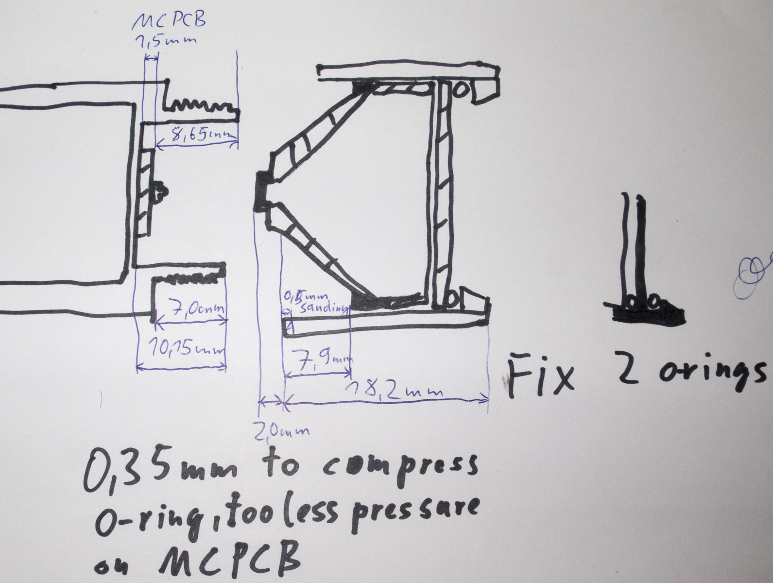

When pulling out the reflector I saw that the o-ring is placed between lens and it, but the top of the reflector is perfectly flat, so no force pushing the o-ring tight against the head like within my Eagle Eye X2R, where thereflector to is formed to push the o-ring outside when compressed

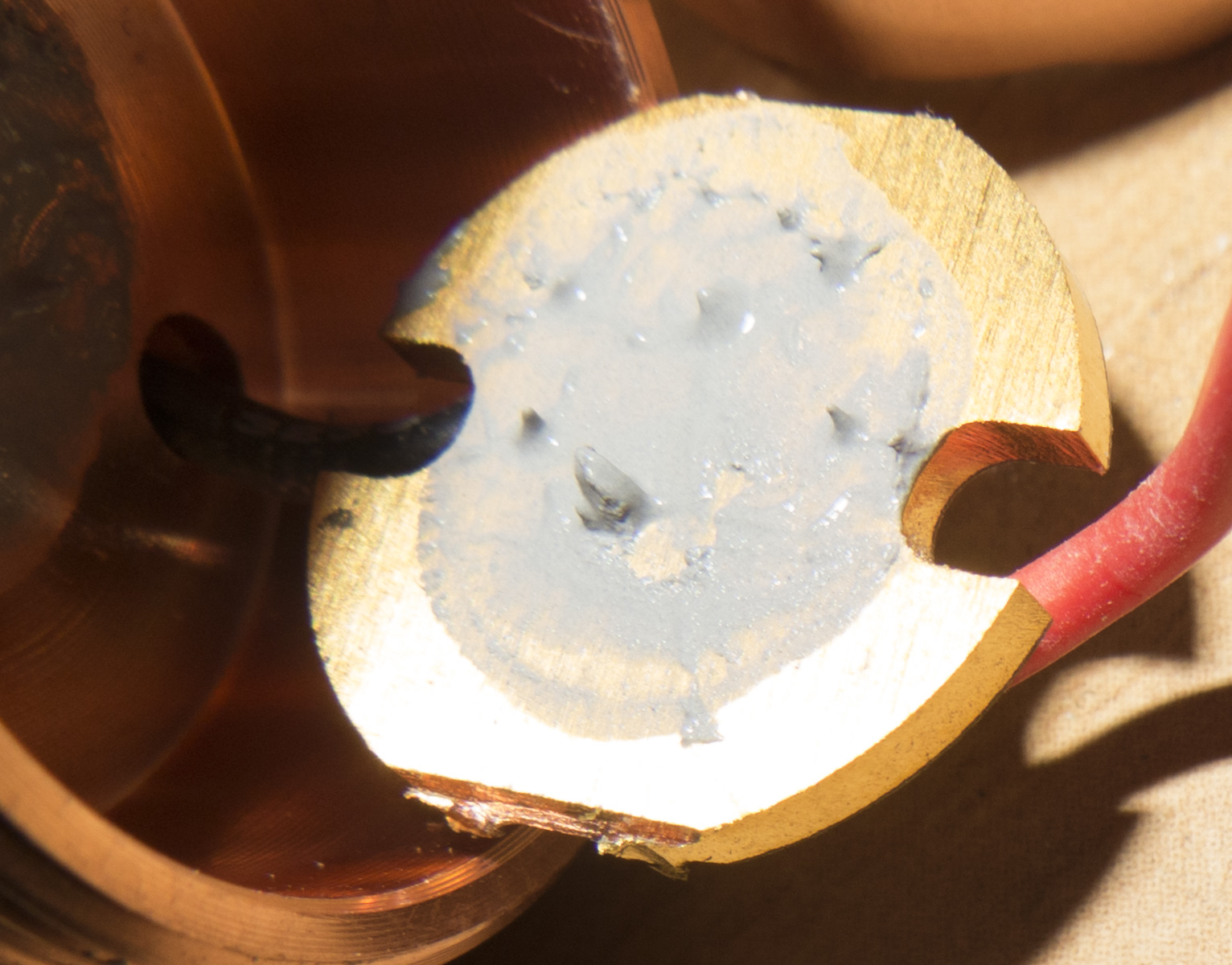

The thermal paste is applied in a moderate quantity and seems to be some silver compound, but when I removed it I noticed some harder parts that were not fluid, so the thickness assembled was too thick
The pattern and thickness showed that the pressure on the MCPCB also may be too weak, when measuring the head and middle section with uncompressed o-ring I get about 0.35mm that can compress the o-ring
So for the stock light the thermal resistance of the thermal paste will be increased
I checked the MCPCB to be a true copper DTP one 1.5mm thick, very nice, the back of it is gold plated
The MCPCBs back is perfectly flat
I did sand down the head part 0.5mm so the o-ring can be compressed more getting a higher force pressing on the MCPCB
I did a drawing to show, why there is almost no pressure on the star

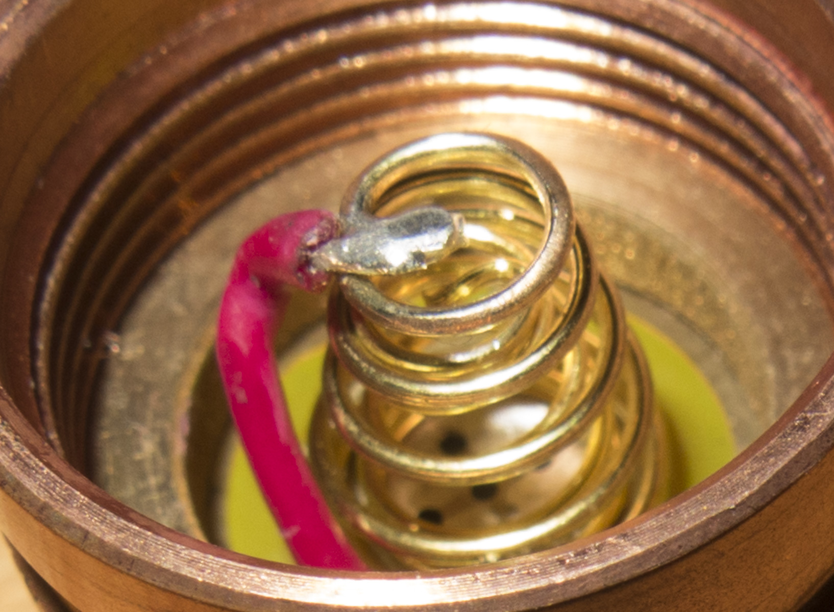

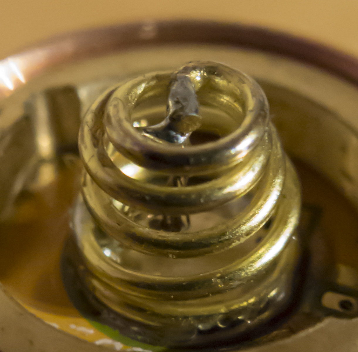

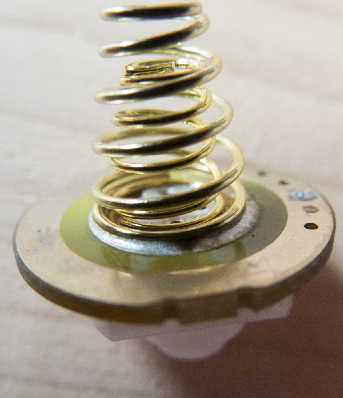

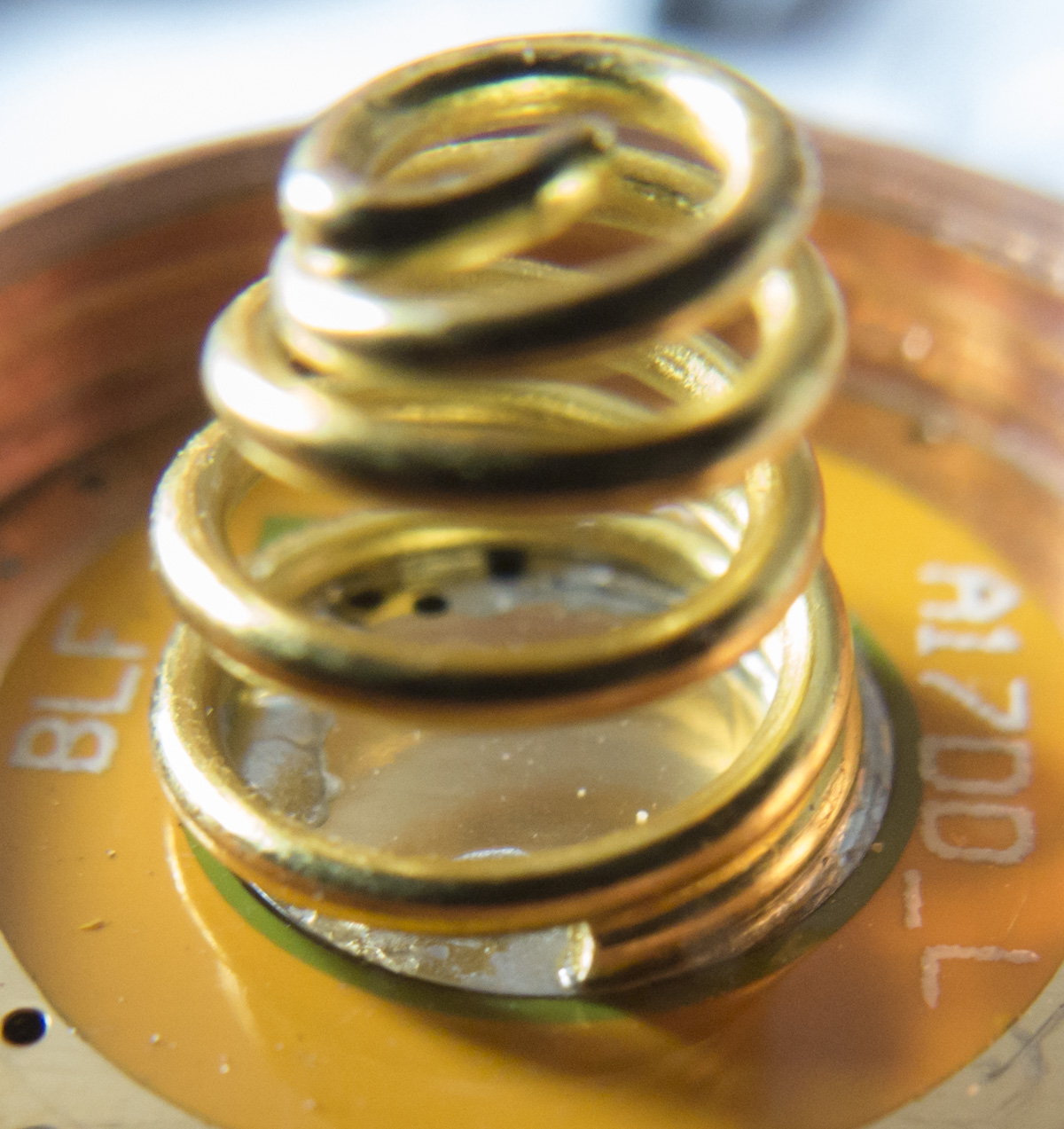

When opening the light I noticed the driver spring is soldered with very few solder paste, adding more tin is probably better
the tail cap has double springs, while the driver has one thicker spring

The tail cap thread on the tube has an o-ring and is lubed for water tightness

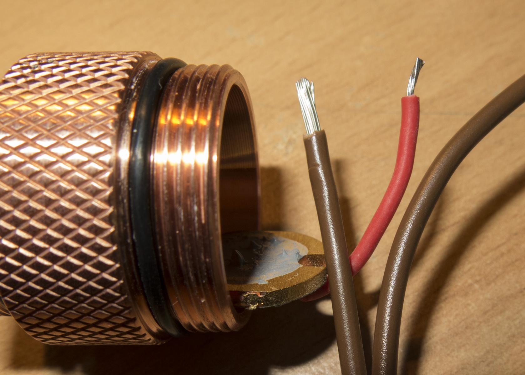

stock light no driver spring bypass, long thin leads to star, switch and spring resistance simulated with a thin AWG28 15cm long lead:
- 3.06A with protected Keeppower 14500 800mAh
- 4.6A with a Samsung 18650-30Q and as I dont own high drain 14500
driver spring bypass and thicker shorter leads to star, 1.5mm² tail bypass wire:
- 3.32A with protected Keeppower 14500 800mAh
- 6.5A with a Samsung 18650-30Q and as I dont own high drain 14500

I did solder the driver spring with more tin and added a spring bypasses to driver and tail springs
Cleaned the head and MCPCB from the old thermal paste
and added Arctic Silver 5
replaced wires with more gauge
replaced the no name switch with Omten 1288

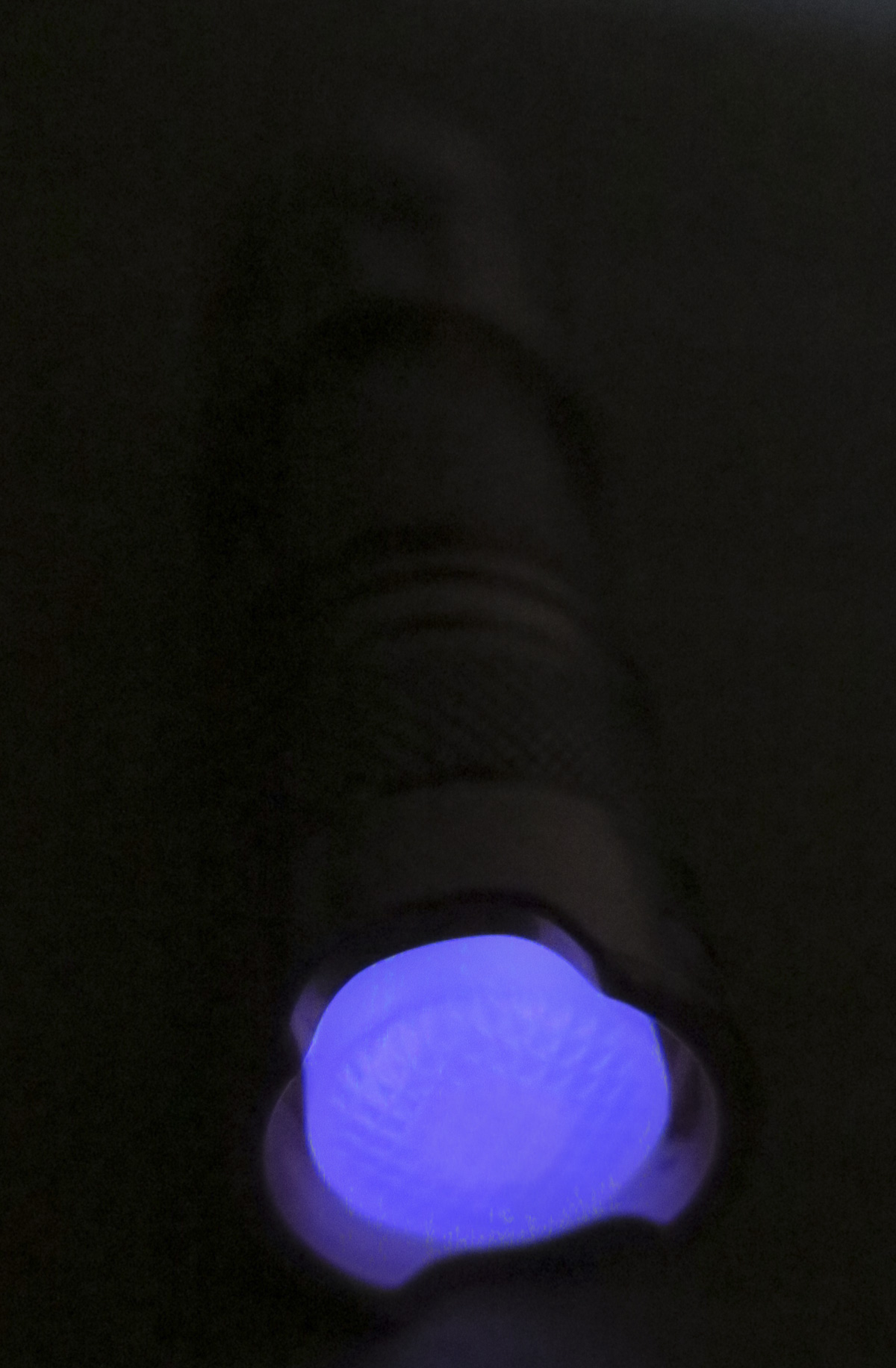

added lighted tail cap parts and driver bleeder resistor
Did here some sort of Tritium illumination level using 4.7kOhms on driver and 20k Ohms on two blue tail cap LEDs, resulting in a parasitic drain of
119uA at 4.2V

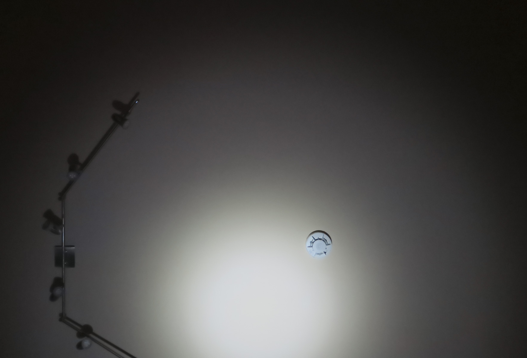

Beam shots
about 2m from Light to ceiling
Astrolux K01 XPL-HD 3D
Jetbeam Jet-1 MK modded with Nichia 219C from a BLF348-2016
Utorch UT01 6500K
Nitecore P12 @1050 lumens modded with DTP star and XML U3-3D NW LED running at 3A

- very few solder paste to the springs, there have been issues with separated springs

- waterproofness might be an issue as the o-ring of the lens sits between the reflector and glass and the reflector has no shape to force the o-ring against the side, can be fixed by putting the o-ring between head and lens
- the heat paste on my light was not good, it contained old dried out parts together with the low force pressing the MCPCB down it has increased heat resistance
