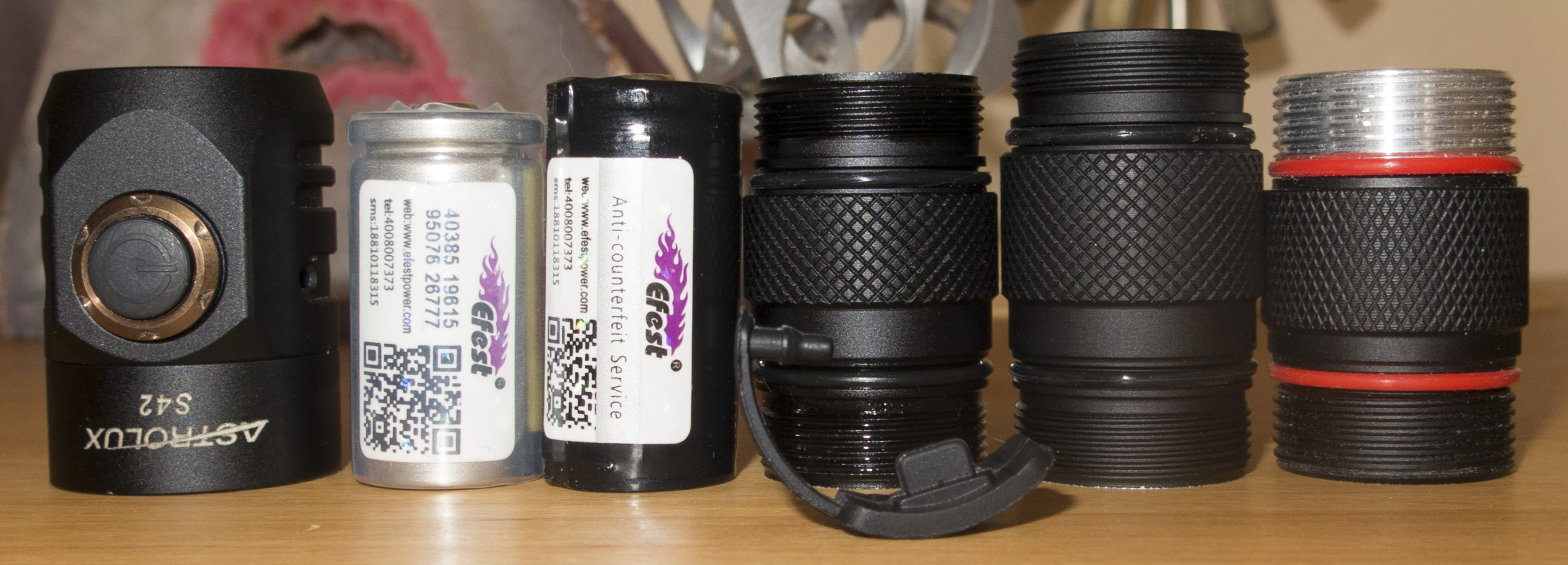

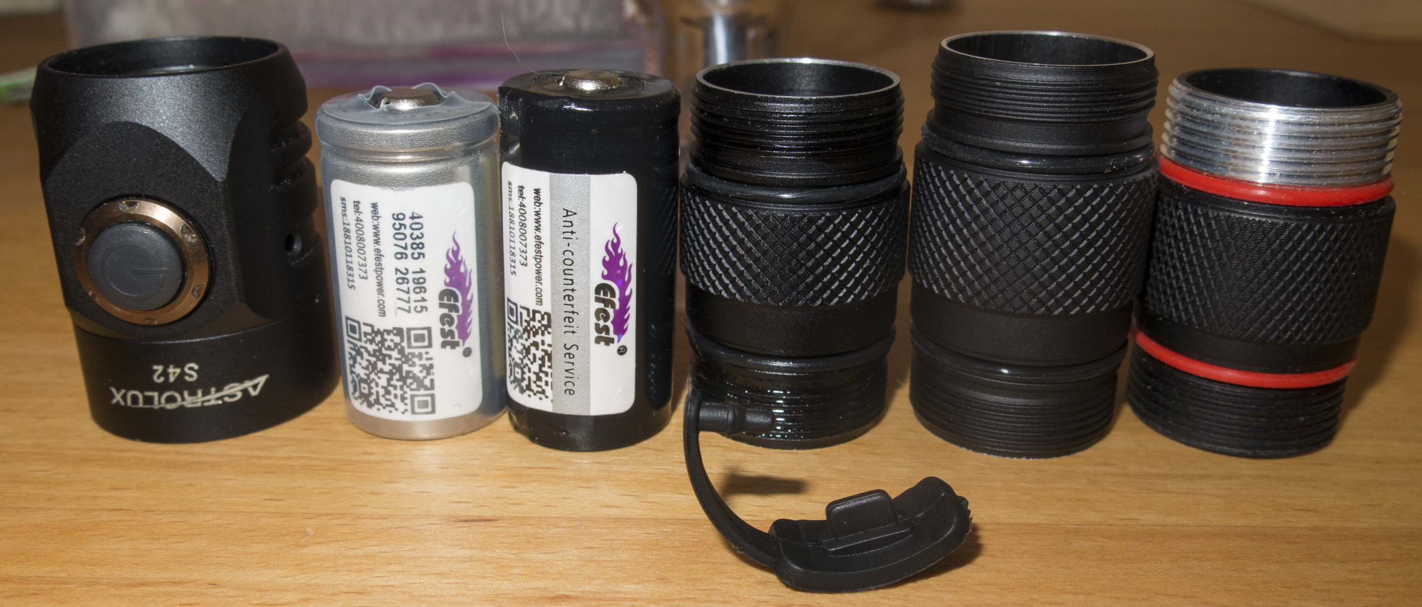

So the new 18350 tube arived
with it longer 18350 batteries fit
Here a picture with old tube and Convoy Tube and 2 Efest batteries
The protected button top Efest fits very tight with stock spring, as I cut it a bit shorter it fits without any problems
the new USB cover fits better does not get loose to easy
its not perfectly symetrical from production process
but getting it pushed in the hole was not easy some grease did the trick
removing the old one ripped of the part inside the flashlight
