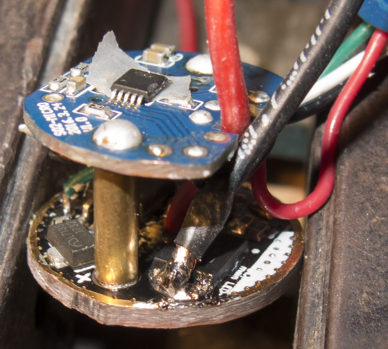

I have now a Narsil driver designed and build those, great UI compared to the stock one
Sale topic here [Finished] 5. Batch "TA" Bistro HD OTSM/Narsil drivers, 15-47.5mm size fit H03, MF01, MT03, Q8 1S or 2S, Clicky or E-switch
The old MCU is one side disconnected to get rid of 1mA parasitic drain

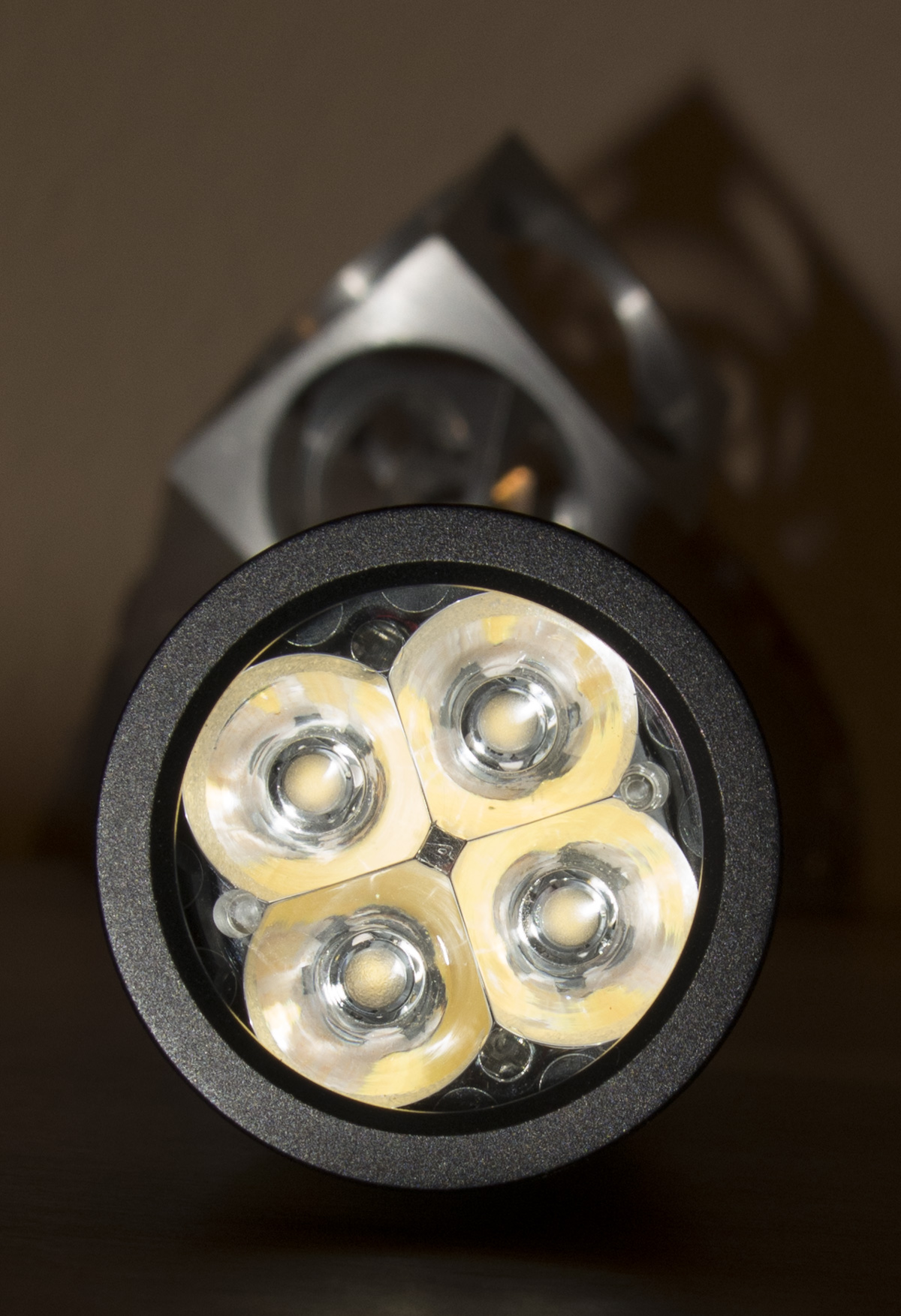

Beam color is neutral around 5000K for the Nichia 219C model, the Nichia has a nice uniform beam and color rendering is great
The LEDs are perfectly reflowed and the MCPCB sits perfect, but the charging port cover slips too easily
from left to right the lights get warmer, picture taken @5000K camera setting
left XML2 U3-3D 5000K, Astrolux S42 Nichia 219C 5000K, Nichia 5000K, XPL HD 1A 6500K
The LEDs in this light are available in XP-G2, XP-G3 and Nichia 219C

the TIR is a medium flood, gives a nice uniform beam with some spill
the Nichia LEDs fit in nicely

The only thing I will do when I get time would be getting a Narsil driver installed
driver replacing without keeping the chargin circuit is easy, a 21mm driver fits with minor sanding
with AWG18 and SIR800 FET pulling 18.9A on cold start
instead the 9.95A with fresh Samsung 18650-30Q cell
I went with a solution I like, keeping the old drivers slave board electronics with charging
I did wire the old electronics with the LED+ wire on the star, so if I want deactivate the USB charger and breathing lighted sideswitch to get rid of the parasitic drain,
I can unsolder the thin wire on the star
The drivers contact board and TA 21mm LDO driver
trimed the board to fit easily
used my Dremel to get rid of unsoldering the leads to the switch board
trimmed the old driver contact board to fit inside the head, cut the bolts connecting both boards by 4mm and sanded it
Driver assembly before gluing the old board on top of the TA driver to fix the position USB slave board
I had to cut the USB opening a bit as I trimmed not enough leng of the bolts
The lead connecting the old slave board with the battery, can be easily disconnected
I did just cut the tail spring a bit shorter to allow my brass button flat tops to fit without denting the battery bottom,
there will be longer tubes released soon

So I am getting into modding this light with TA Narsil driver
the original FET is this one g16n03 with 22mOhms
its resistance is no where near top ones like SIR800 or PSMN3R0-30YLDX
VDS (V)
30V
Rds(on) @10V(Typ)
0.022Ω
IDS (A)
16A
So sorry I don’t know. I’m not mechanical enough to mess with flashlights. Sorry
SIR800DP, SIR404DP, or the high performance Infinity FET is the best way to go. The 800 and 404 stay cool at high amps, better than the 3R0.
