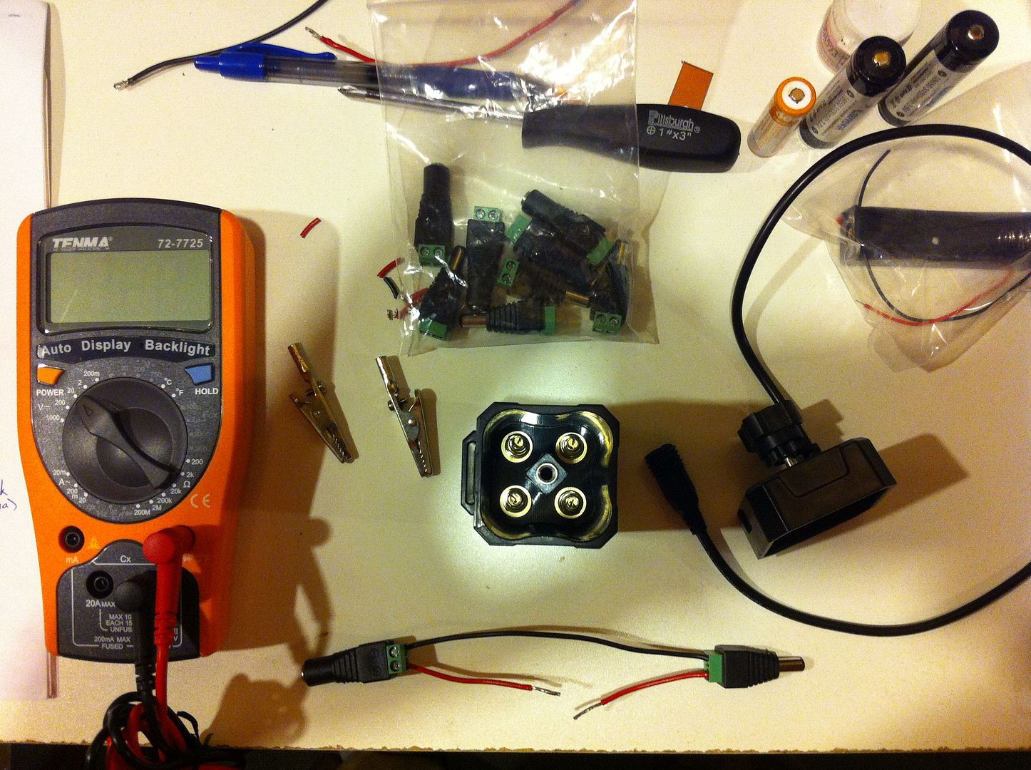

The battery pack has a circuit board in it. It connects to the Positive, Negative, and connection between the 2S banks. It also feeds the output wires (approximately 22 or 20 gauge). I don't know it's purpose.
The cells are not labeled and are wrapped in a baby blue wrappers. They take full voltage charges. Internal resistance and capacity tested as follows, respectively:
Cell A = 54mR, Cell B = 52mR, Cell C = 51mR, Cell D = 51mR
Cell A = 1,122mA, Cell B = 1,079mA, Cell C = 1,073mA, Cell D = 1,131mA

I tried to test the board in the picture below by doing the following:
- Connected to 2 cells that were below 2.5 volts. The board did not feed power.
- Connected to 2 cells above 2.5 volts but over 1 volt different in voltage level. The board did not feed power.
- Then connected to 2 cells, both at 4.15 volts. The board did not feed power
What did this tell me? Nothing. It could be that the board permanently shuts down after an imbalance or low voltage occurs. It could be I did something wrong. I did tell me that I am not qualified to evaluate this board.
