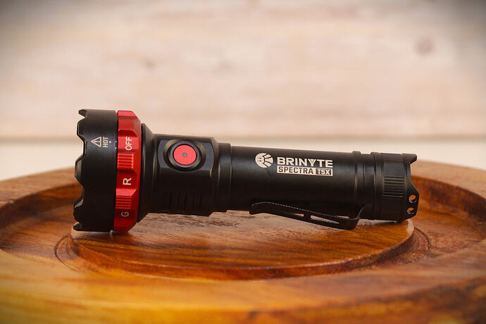

Buttons: The flashlight features a main e-switch that turns the flashlight ON/OFF and a silent magnetic rotating mode selector on the head to select the secondary light modes: Red - Green - Blood Tracking Fast - Blood Tracking Slow. The rotating selector and main button make almost no noise, this means you can easily change modes without alerting animals.

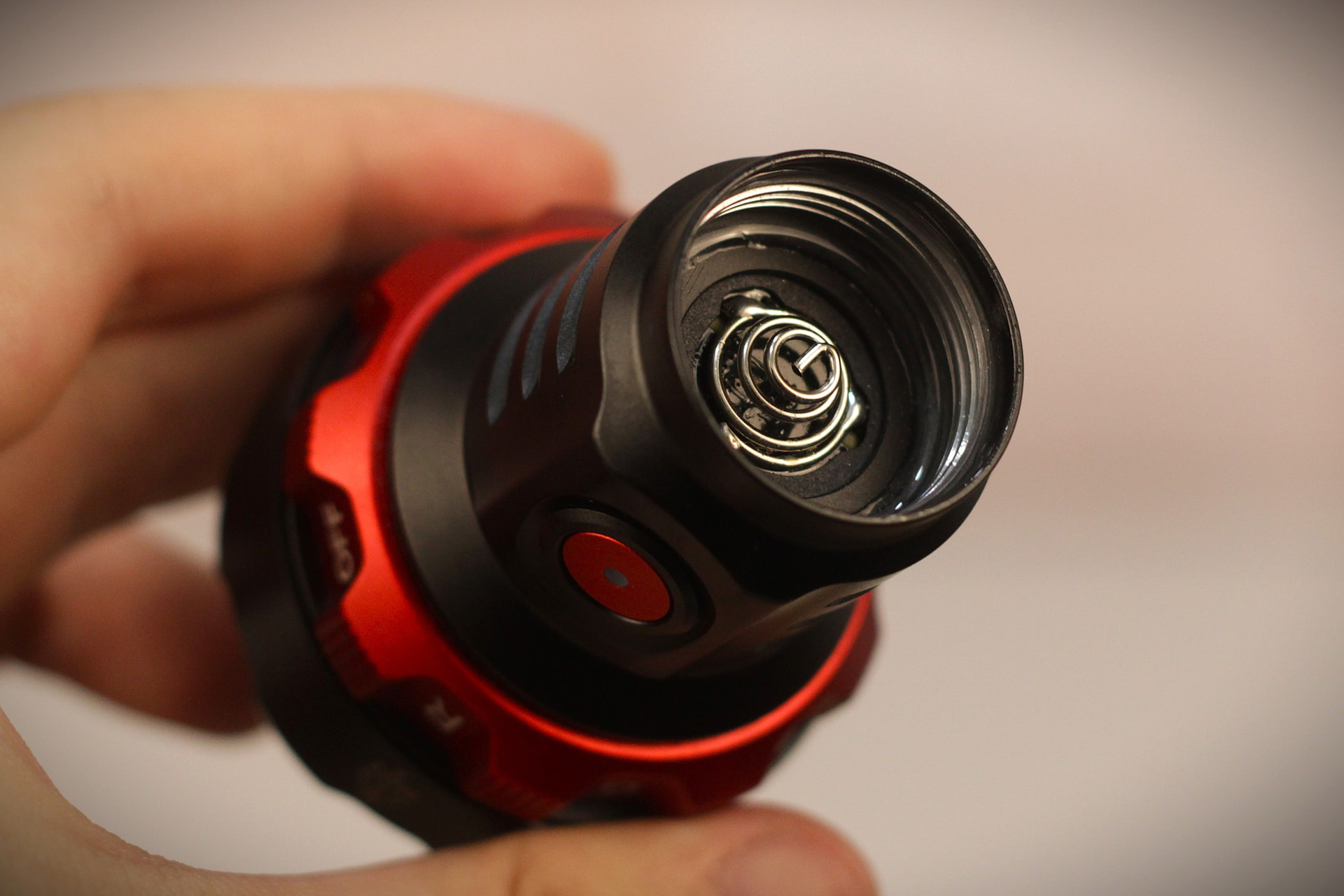

Battery contact: Contact is made with the battery by 2 nickel-plated springs.

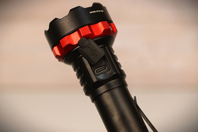

Charging: This flashlight features USB-C charging on the body, and comes with a 21700 battery with USB-C port, so you can charge it by any of the ports. The maximum charging input is 5V 2A. The indicator shows red while charging and green when charging is complete.

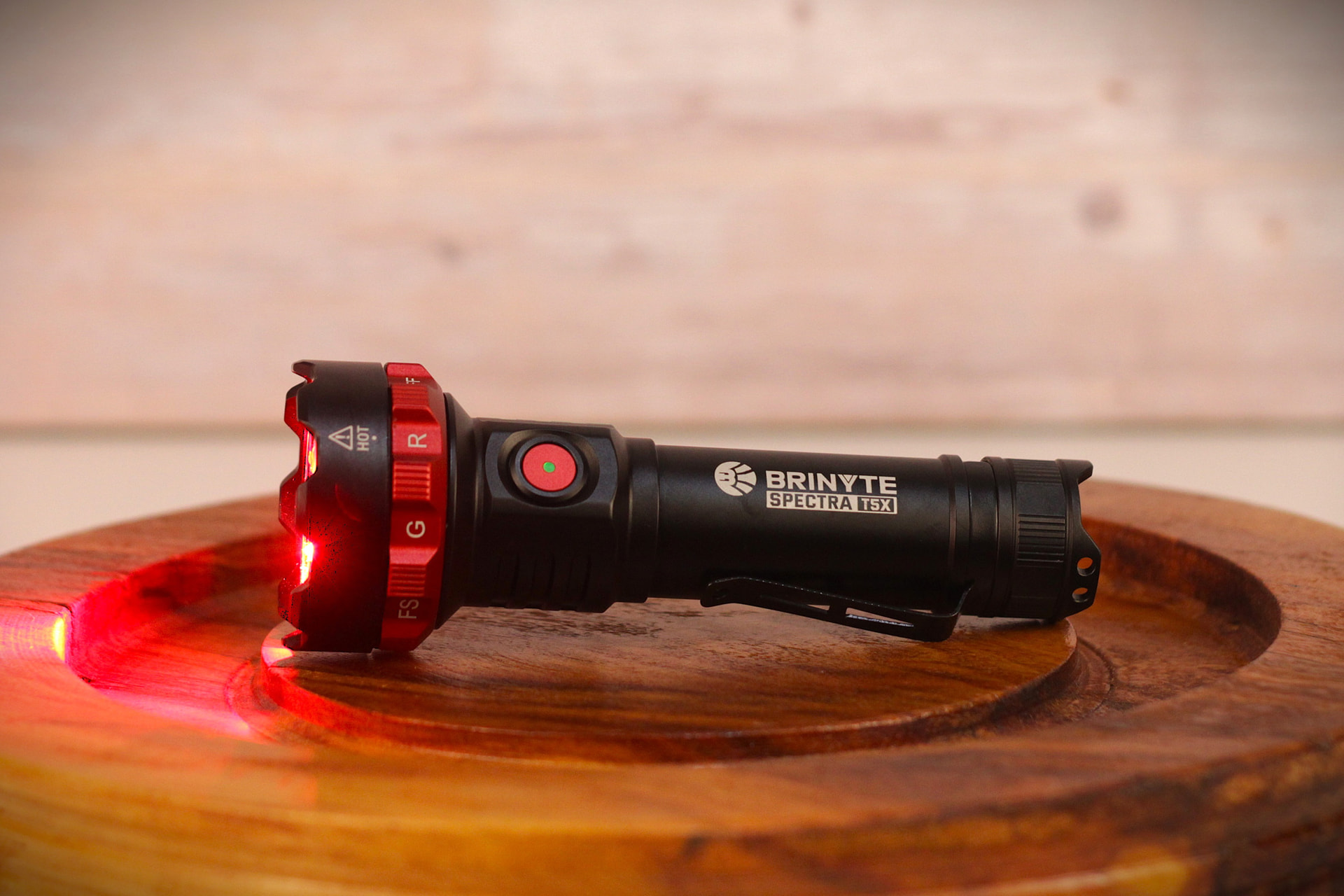

Blood Tracking: This flashlight features a special mode that is the Blood Tracking modes, while they were made for blood detection, they work with anything red. On this mode the Green and Blue LEDs are constantly lit, while the Red and Warm White LEDs alternate blinking at 5Hz on the Slow mode and 10Hz on the Fast mode. This makes Red objects “flash” when the flashlight, giving a really cool effect and getting your attention to red objects.
Red and Green: The solid color modes are pretty useful to stay hidden from animals, especially the Red one. Red is dimmer and for closer uses, while the Green one has almost double the lumens and is less “stealthy” as it will alert animals and insects way more, but it goes farther and is still better than using a white light for this use.

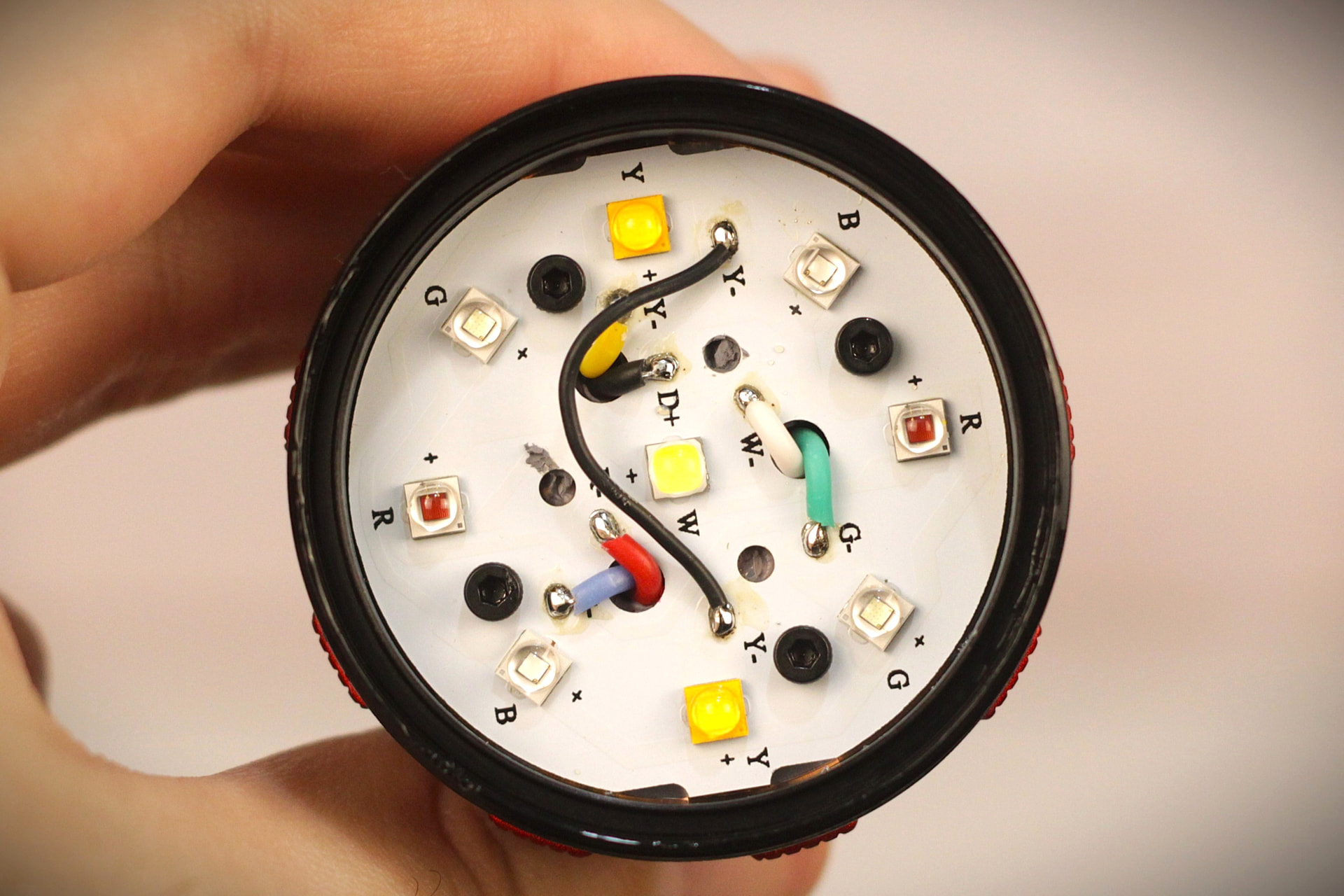

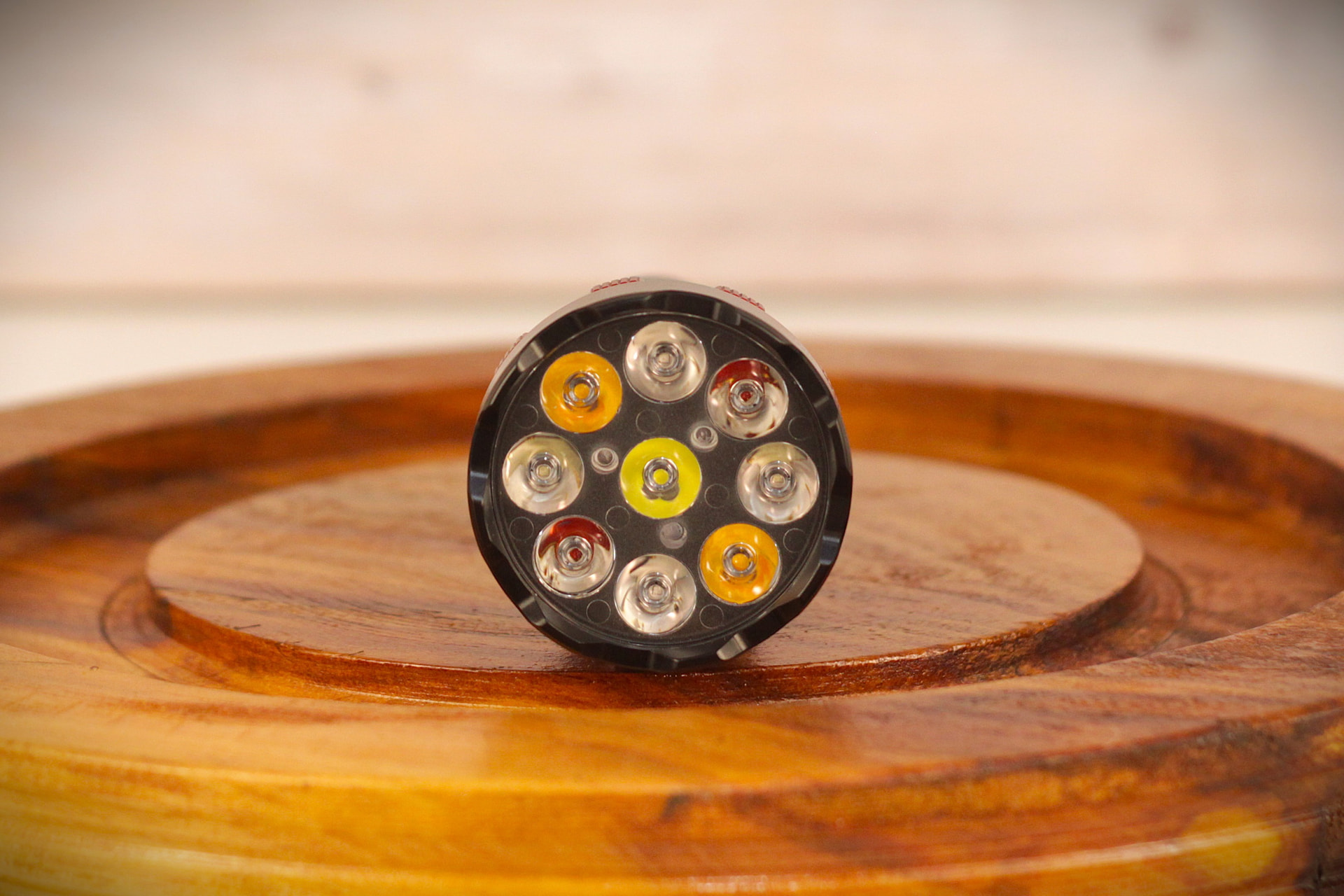

Emitter: The T5X has 9 emitters: 1 main cool white, 2 warm white, 2 red, 2 green and 2 blue. The Warm white and blue emitters cannot be turned ON outside of the Blood tracking mode. I didn’t find any information about them.
Beam profile: From upclose all the beams have light rings and very noticeable artifacts, so I would avoid wall hunting and using it from up close; but with a little distance the beams become more uniform.
CRI: I assume all the white LEDs have standard 70 CRI, as there is no information about them.

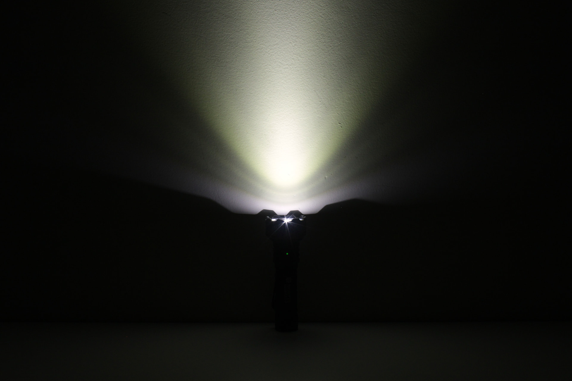

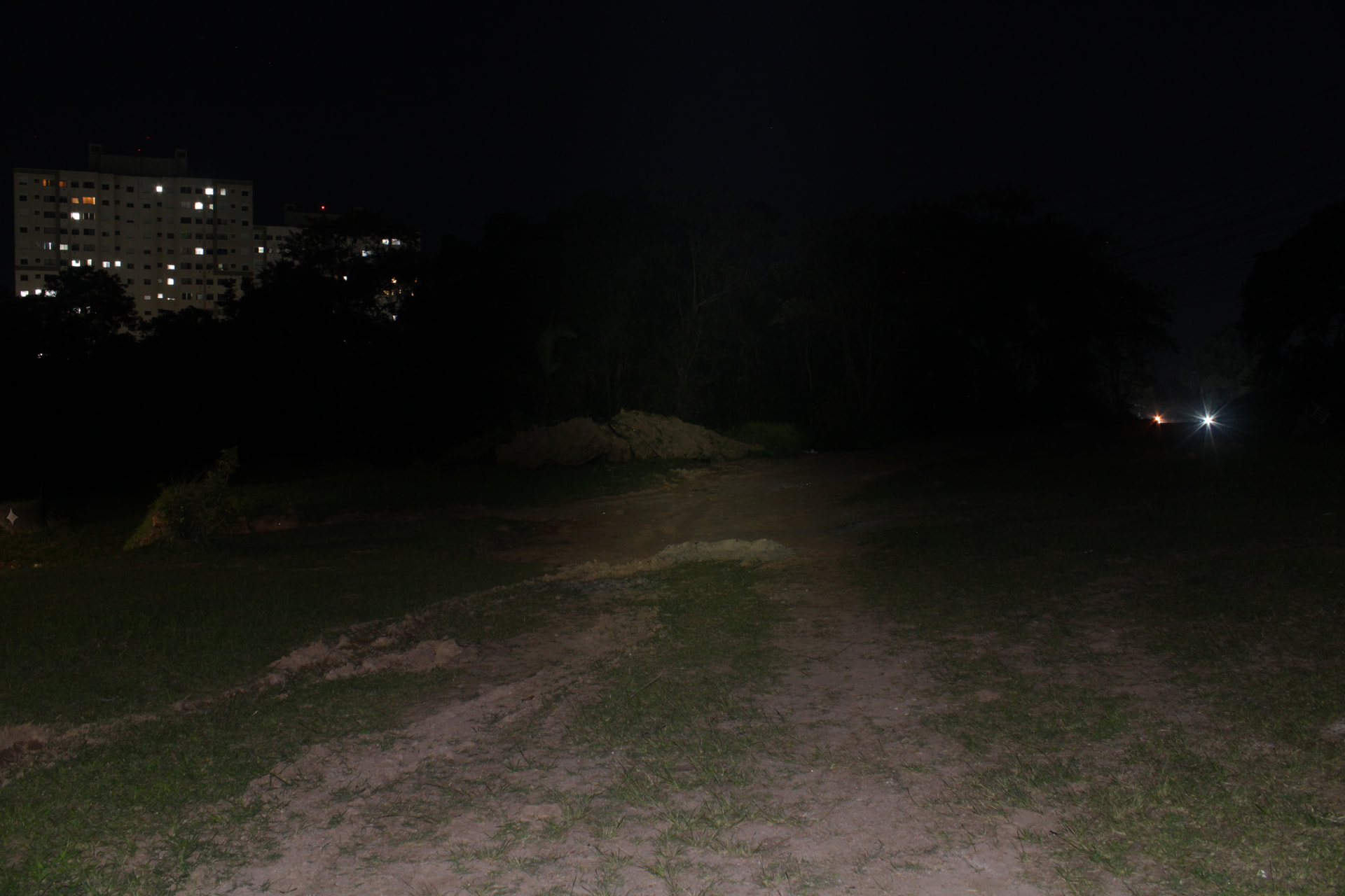

Spectra T5X - High (1000 lumens)
Spectra T5X - Low (120 lumens)
Spectra T5X - Red (170 lumens)
Spectra T5X - Green (350 lumens)
You can see the High white beam and the Red/Green modes reach the trees at the back, so they can reach around 100m and still light up things.
