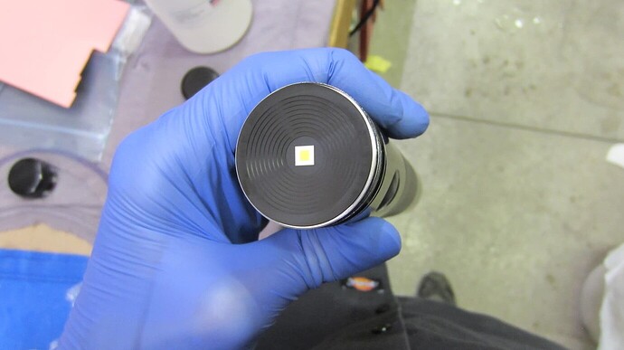

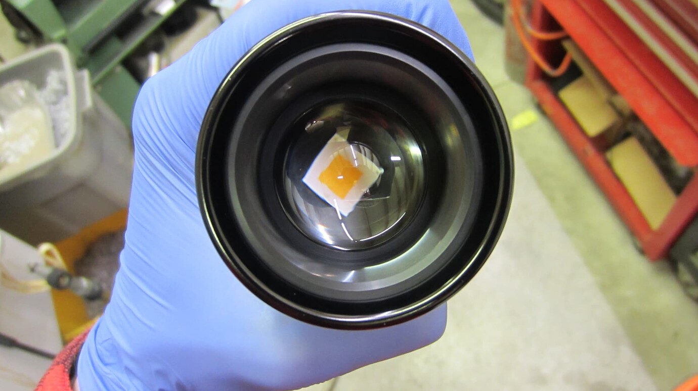

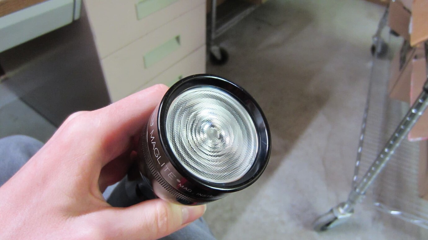

I can say that I have tested all of Ledil’s zooming lenses, all of Gaggione’s UFO and one piece zooming lenses, various fresnel lenses including 20mm diameter ones, and various convex lenses. All of these lenses have some sort of compromise about them. This doesn’t make them terrible, it makes them more or less suited to a particular design goal.
Gaggione UFO:
A common convex lens, with blackout shrouds:

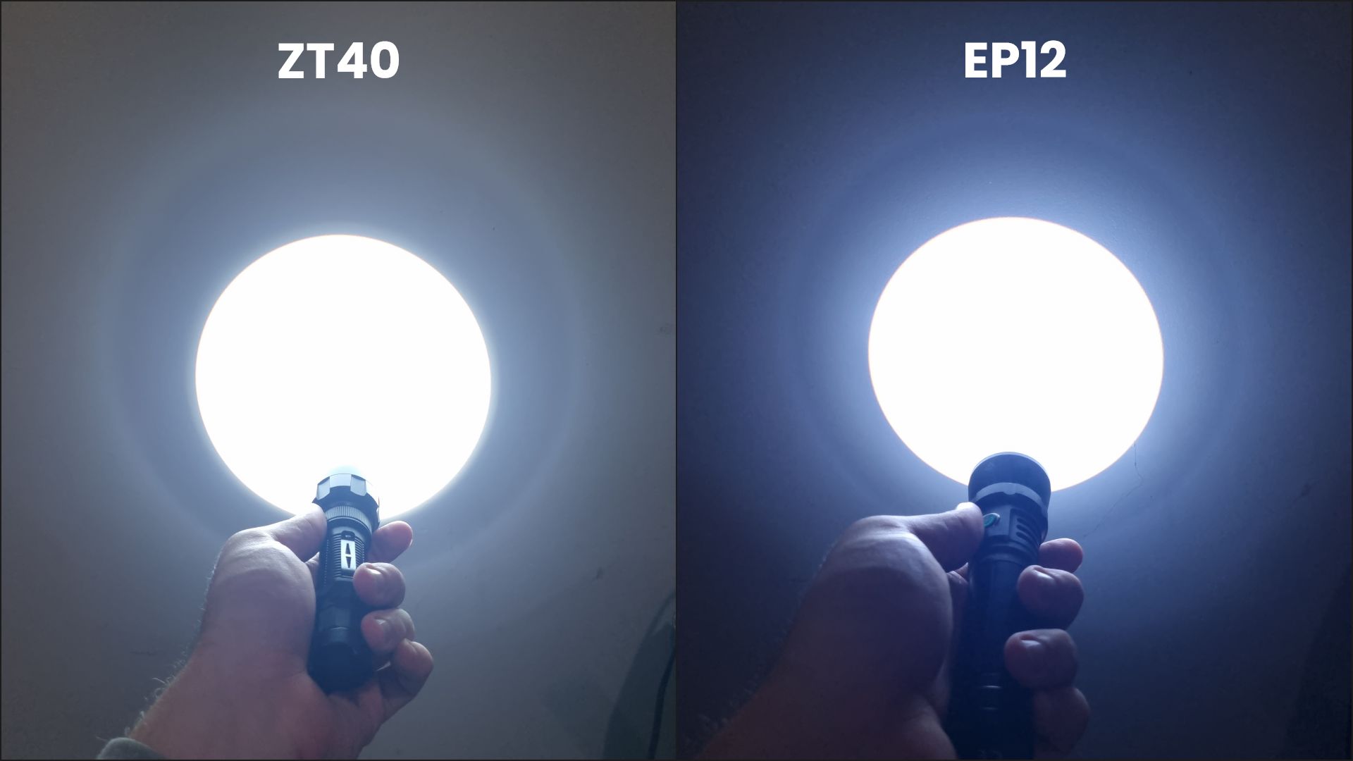

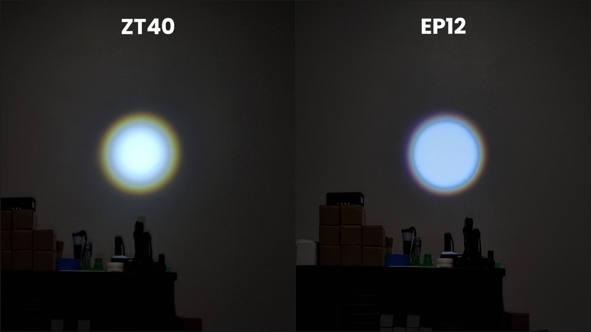

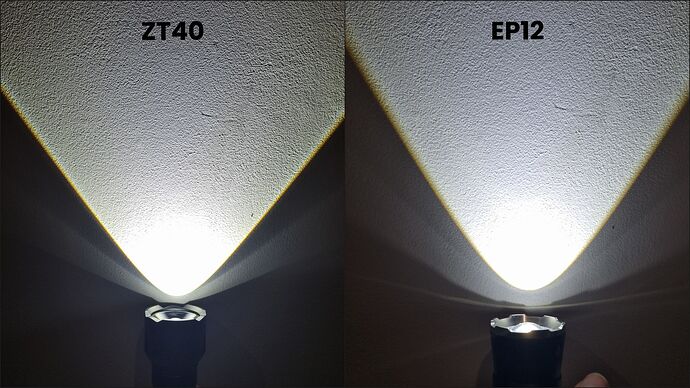

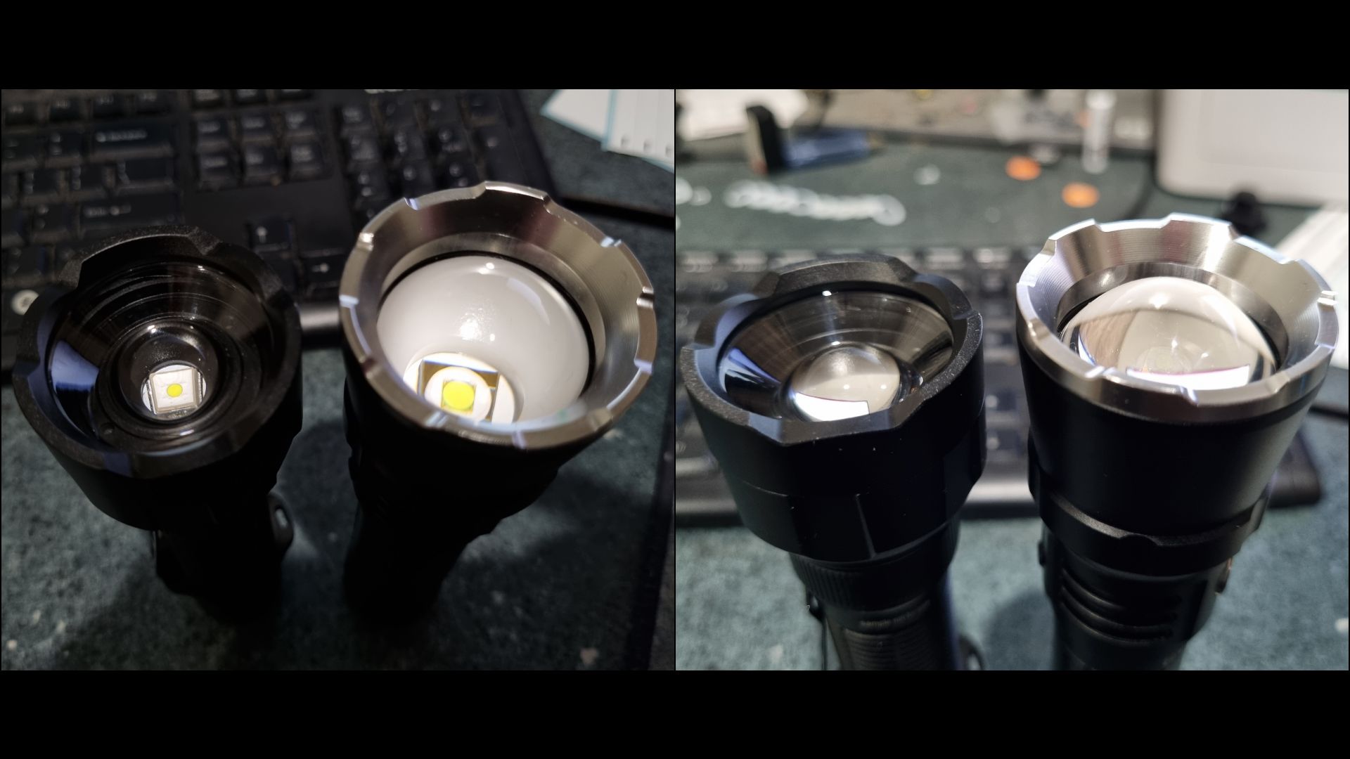

Here’s a few images of the Brinyte ZT40 vs Klarus EP12.

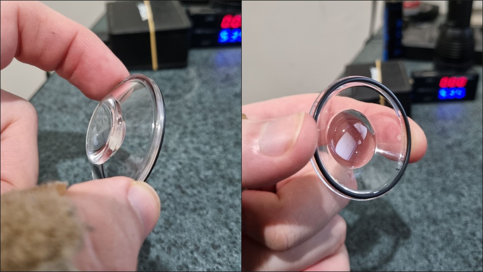

The only issue I have is that the very small dome in the centre of the ZT40 optic greatly limits the range. The only benefit, if you can call it that, is the hotspot of the ZT40 is more of a spot and corona appearance when focused in. While this sounds nice, it’s actually just a smaller even circle in the middle, the corona just looks basically the same as the EP12 with the purple ring. Would you prefer this hotspot or the EP12 look with twice the range if the ZT40 used a standard full size convex lens?
Both of these models have an identical head and optic diameter. The EP12 uses a very large emitter in comparison, the ZT40 should be crushing it, but it’s not.
It is a TIR lens, just not the kind they advertise, just a pointless one that greatly limits the range for next to no benefit. I actually prefer the large even spot on the EP12 than the ZT40.
Edit: it’s kind of not a TIR, it’s just a tiny convex in the centre, the outer part of the optic does virtually nothing for it.

Huh this is very interesting. I saw some of these lenses in 60 or 80mm diameter on Aliexpress a while ago and was tempted to get some and try, but am now glad I didn’t. I was worried back then that the “TIR” part won’t have enough precision to correctly focus a small die emitter, which now seems justified.
This lens might have been designed for larger die or maybe even COB emitters, whose larger emitting surface requires less optical precision and might allow the “TIR” part of the lens to become optically functional.
Thanks for the pictures. It’s a one piece optic? Looks like it might not be so novel after all.
