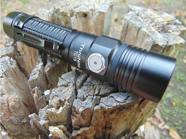

This is an 18650 sized EDC with plenty of lumens for whatever the purpose may be , ranging from 2300 listed lumens in Turbo , all the way down to 1 listed lumen in firefly mode.
The size is very comparable to the always popular BLF A6 and other 1 inch tube lights.
Shown here with the Olight M2R Warrior and the A6…….
The styling is pleasing to my eyes (I know opinions will vary) and the ribbing in place of the usual Knurling , not only looks good to me , it also provides a good grip and feels good in my hand.

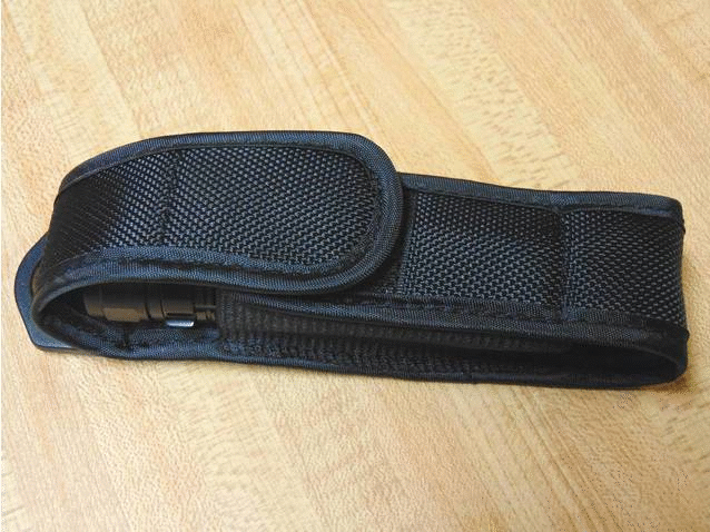

The Included nylon holster is lightly padded inside and fits the light well , while having a belt loop holder and a plastic loop for attachment to a backpack or other desired places with the help of a carabiner or other such anchor or hook.

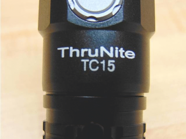

The Branding , or etching is also done well and I have found no thin or bare spots on the anodizing anywhere.

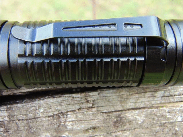

The clip is made sturdy and attaches with a good amount of force , it seems to stay in place well once attached to the light , while holding firmly when attached inside my jeans pocket also.

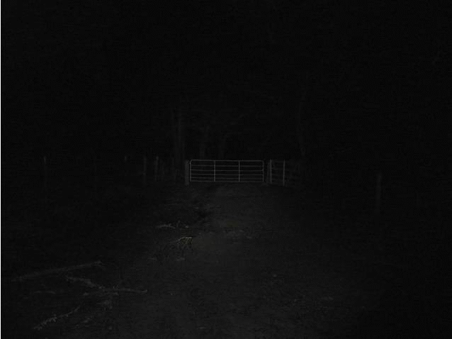

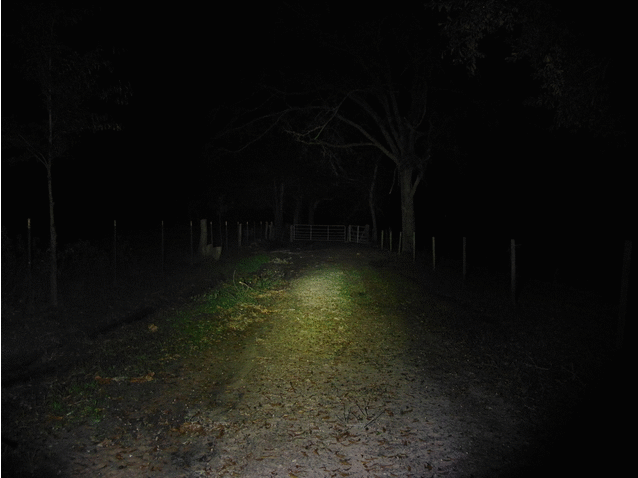

The beam is a nice defined hotspot that is not small but not too big either. There is little to no corona and plenty of useable spill for walking and such.
100 yards to Gate / High and Turbo
75 yards / High and Turbo
50 yards / Medium - High - Turbo
25 yards / L M H- Turbo
