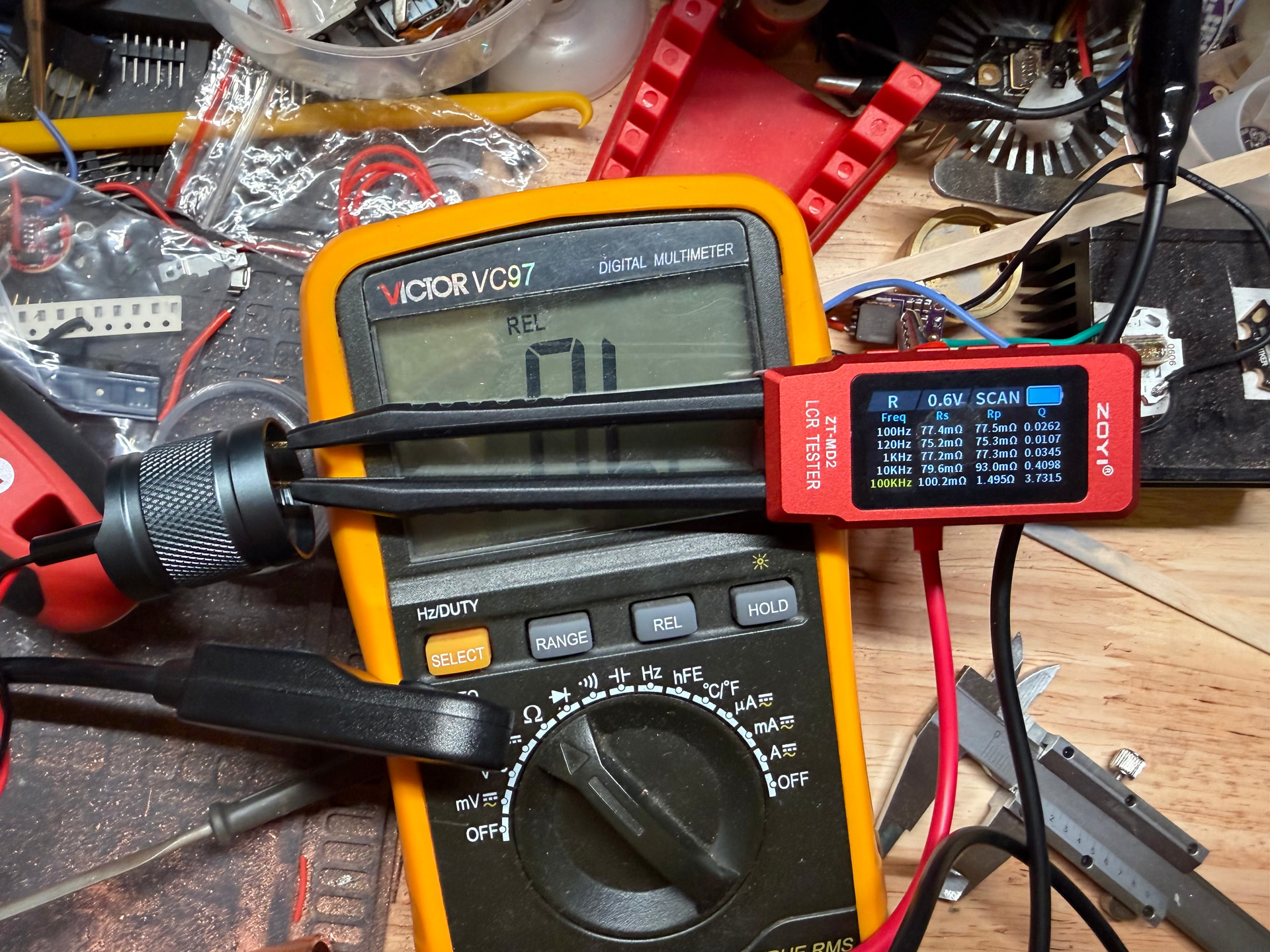

DMM readings were all over the place, going from > 1ohm to some negative net readings when canceling lead resistance.
LCR meter to the rescue:
I was surprised by those readings, do ~80mohm make sense?
Good to recall they were taken at 0.6V
you can uses Four-terminal sensing - Wikipedia
basically apply a current with power supply and measure voltage with a DMM
