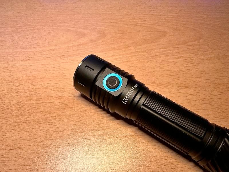

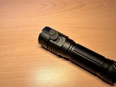

The flashlight comes with a nice black, matte anodization.
The body of the light contains some patters to enhance the grip, while the head has some heatsinking built into its design.

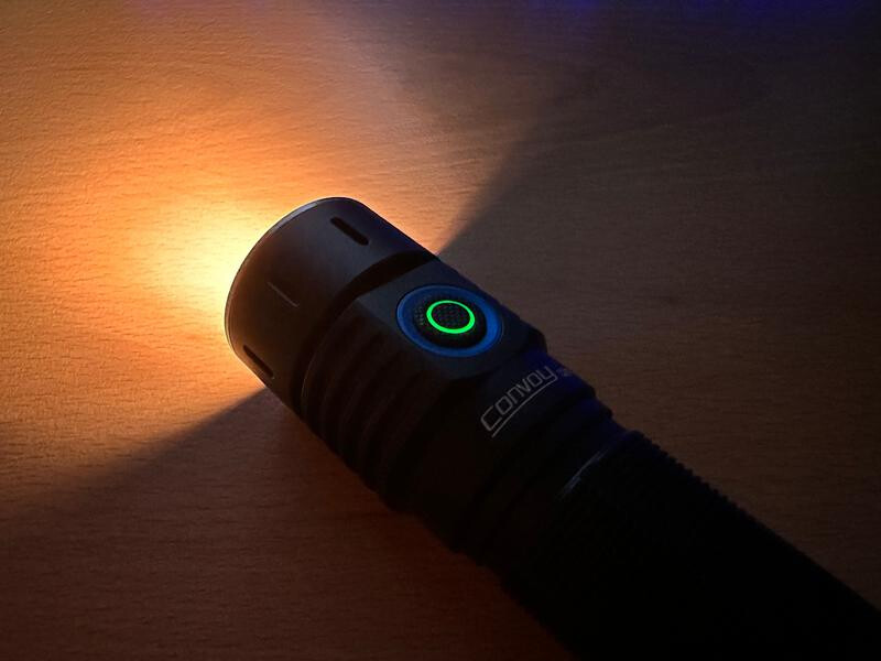

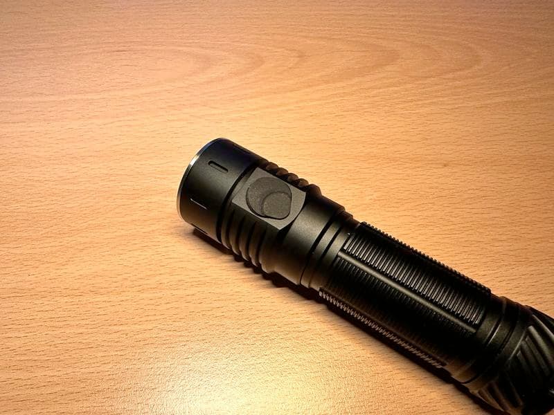

It’s operated via an electronic switch that’s mounted on the lower portion of the flashlight’s head.
The switch is covered by a rubber boot which contains a translucent circular section.
An indicator LED will light up while the flashlight is turned on to indicate the battery’s state.
Opposite to the switch there’s the charging interface.
It’s sealed from dust and moisture via a rubber flap.
A normal Type-C port is used for charging the flashlight.
While charging, the indicator LED of the switch will shine to show the charge’s state.

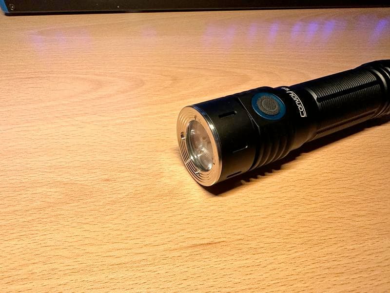

On the front portion of the head, we can see a polished aluminum bezel, which helps protect the glass lens of the light.
The Convoy S21F uses a quad 60 degree TIR reflector and 4 x Nichia 519A emitters.

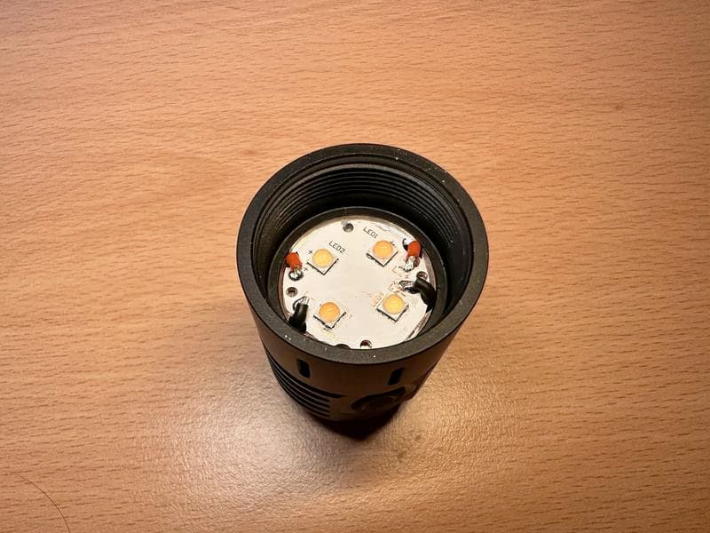

And here’s a closer look at the PCB.
As you can see, there’s two pairs of leads attached on the PCB, which allows the emitters to light up in pairs.
Plenty of thermal paste is in place.

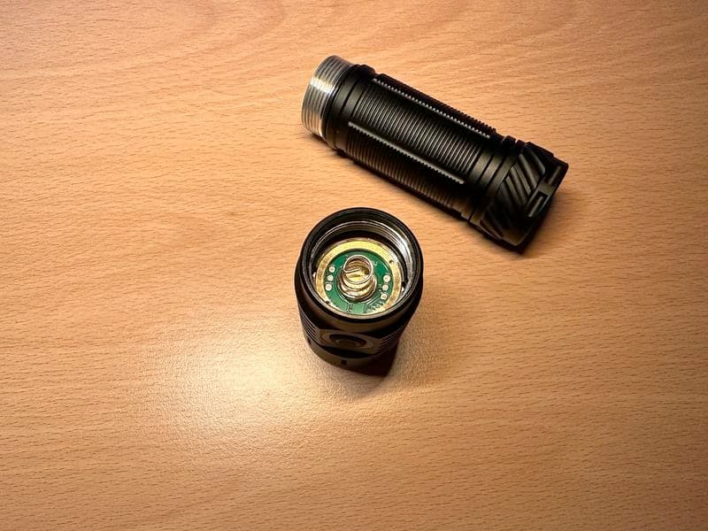

On the back side of the head, we can see the Convoy branded driver, which is held in place via a brass retainer.
A thick spring is used as the positive terminal.

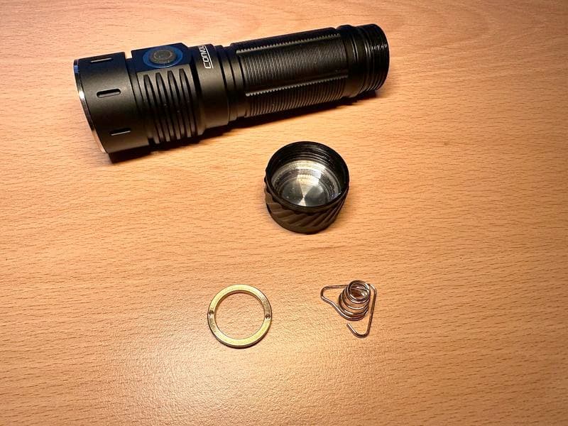

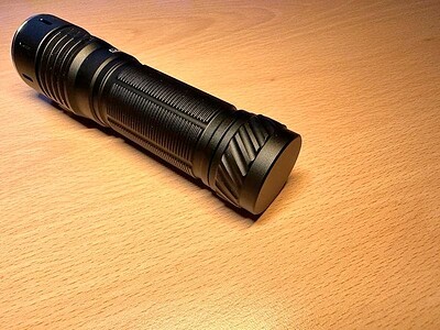

The tail of the S21F is completely flat, which allows it to tail stand.
It also includes a hole on its side to allow the user to install a lanyard.
Inside the tail we find a thick spring that’s help in place with a brass retainer.
Both threads are very cleanly cut.
The rear threads are also anodized, which allows the flashlight to get mechanically locked out via slightly untwisting the tail.

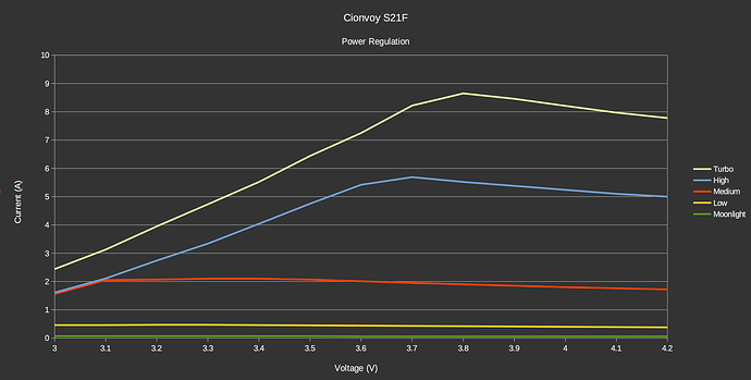

Here’s a power regulation graph I created using my bench power supply to demonstrate how the drive copes with different input voltages.
What we can see in the graph:
  • The flashlight demonstrates great signs of regulation.
  • Turbo is fully regulated down to 3.7V
  • High is regulated down to 3.6V
  • All the rest of the modes are regulated for the full span of the battery’s voltage.
