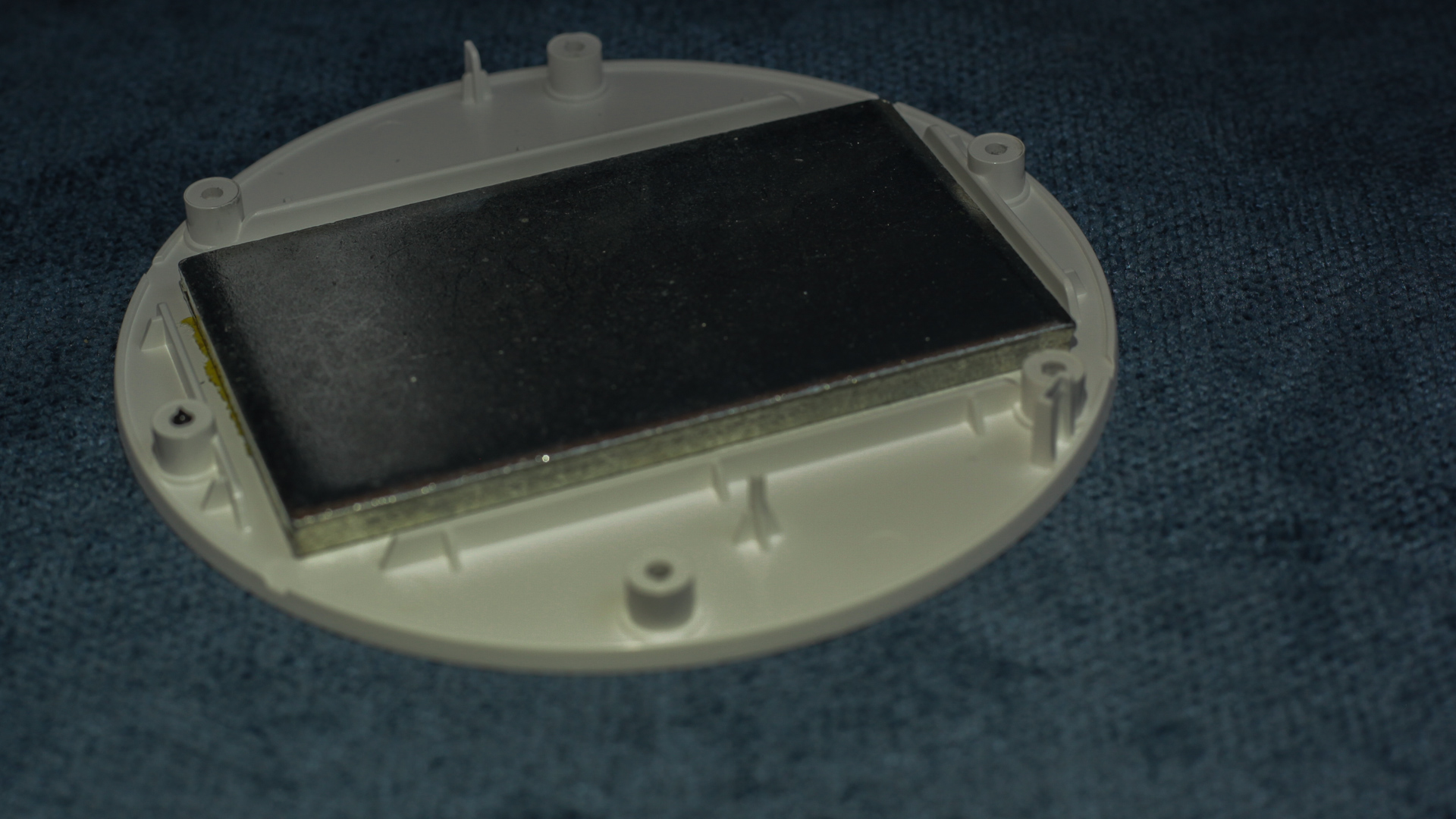

There are a pair of anti-skid sticker, that hide screws. Here is insides of lamp: metal bar for weight and circuit board. Soldering is good. And, heh, nothing similar to Nokia battery, that used so much in different cheap Chinese devices.
Battery here is way better and it surpises a lot:
it has* real 4000mah.*

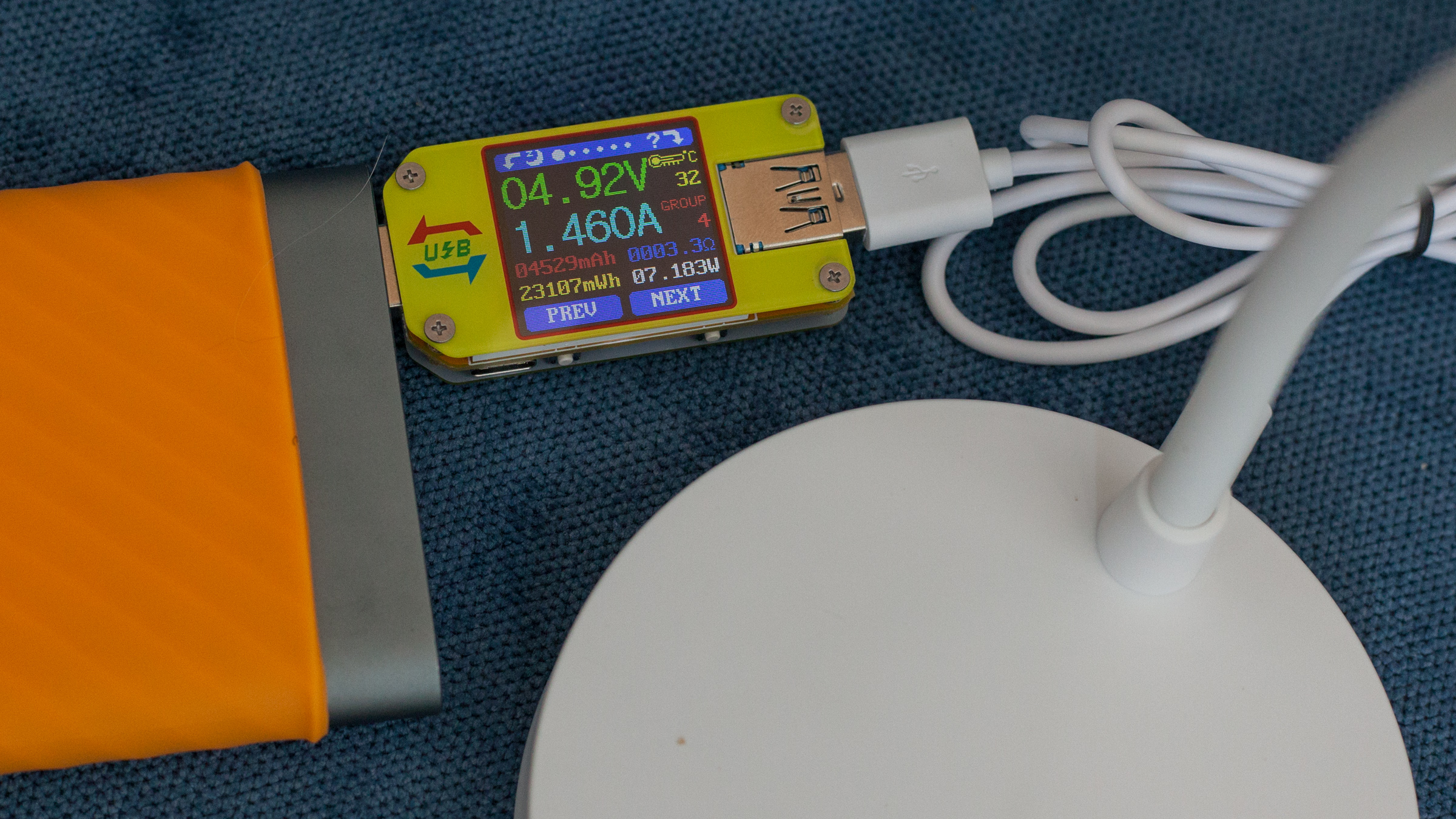

You can simultaneously charge it + some other device connected to lamp (not only one of them). Charge amperage is good as well.
U1 full works as powerbank. I expeted to get something close to 2800 mah (3.7\5.2v ratio), but got less. Still that is much more you can expect to get from lamp.
I connected usb-load and here is what I saw.
*0.5А- 5v
1А — 4.89v
2А — 4.77v.*
Above 2A voltage falls drastically, and gets below 3v at 2.5v, device turns off.

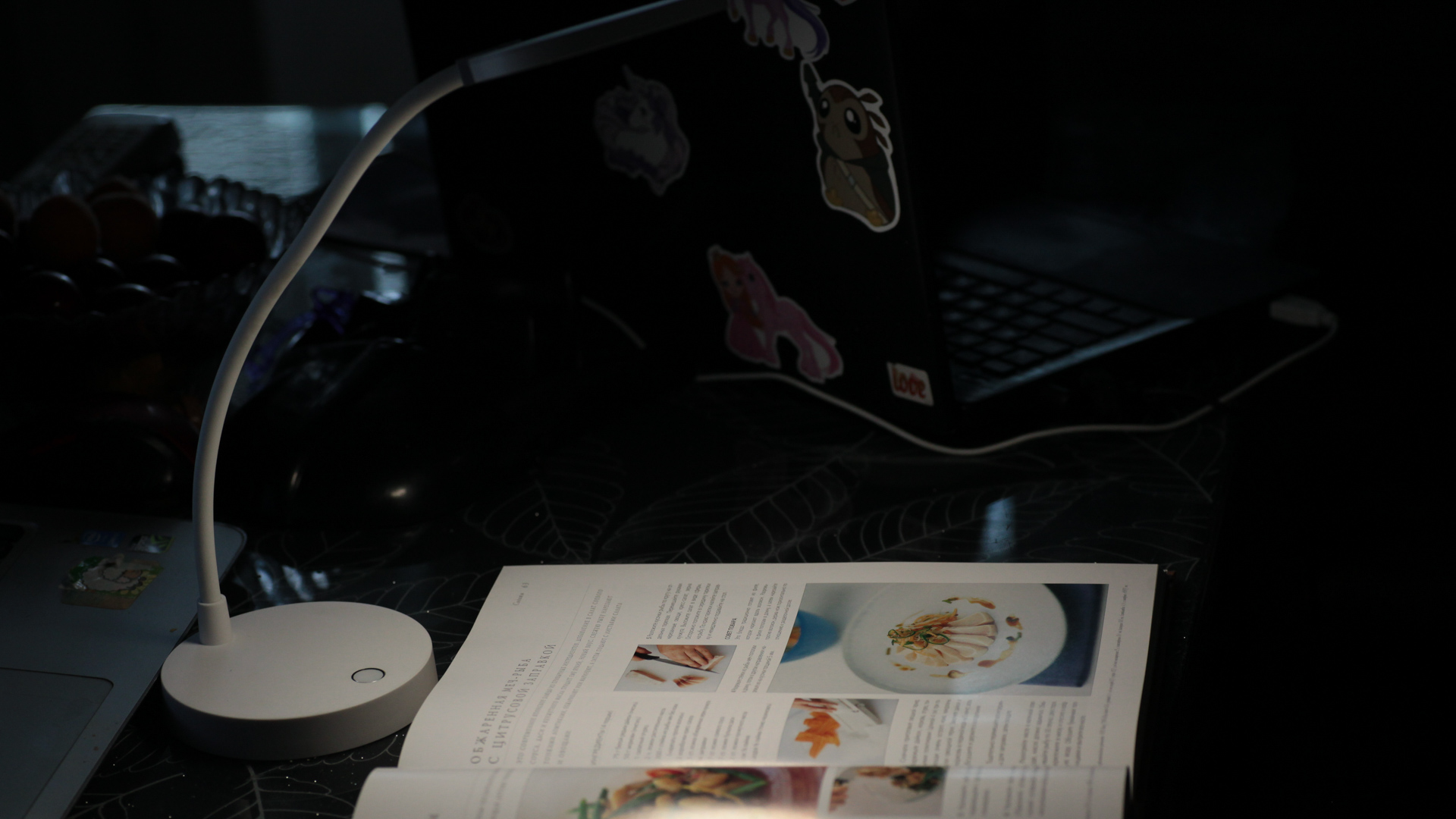

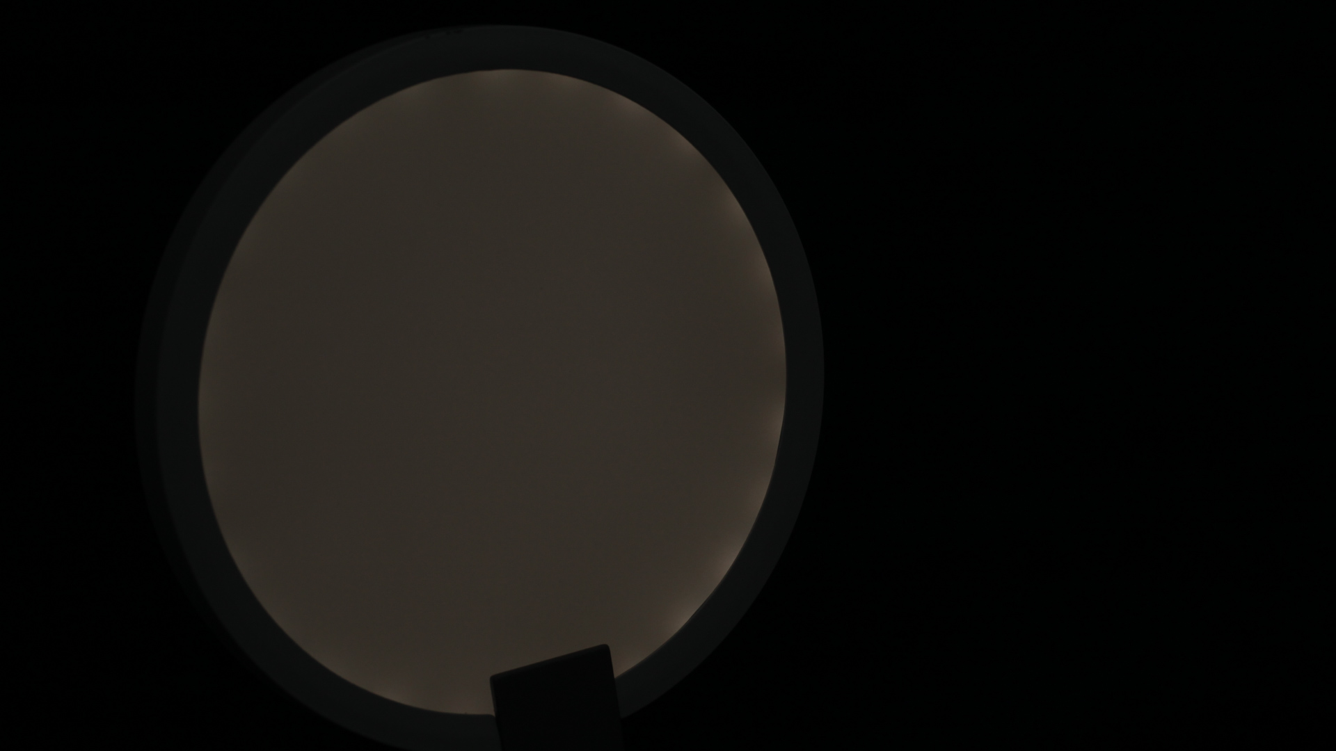

Light itself is NW, 4000k with no PWM-shimmering from 24 LEDS behind matte diffusor.
U1 is definitely bright for personal use, reading, soldering and all that stuff.
