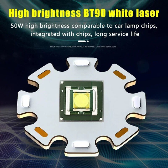

I’d love to see someone test that LED. Can be bought on Aliexpress.

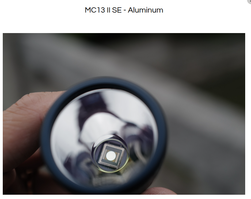

No, that is a completely different LED.
Below you first see a screenshot of the LED you linked too and below that, you see a picture of the LED in the MC13 II SE, from Manker their own site.
The one from Aliexpress has dots in 3 of its 4 corners; the LED in the Manker doesn’t. The one from AE has + and - markings, the on in the Manker doesn’t. The LED in the MC13 II SE appears to have a metal border around it (like in the SFT-40 for example), the one from AE doesn’t.
So, I highly doubt it is the same LED.

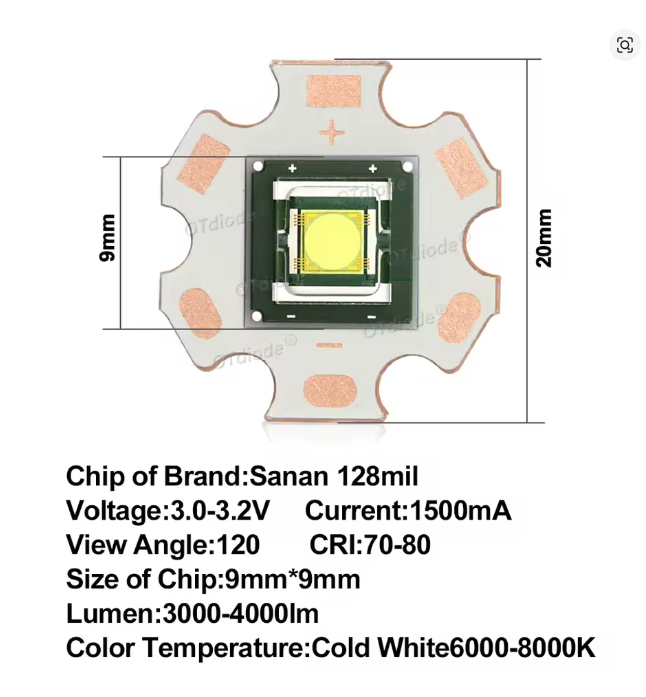

Maybe I linked to the wrong LED there but around the time I was pretty sure I’d found a match on Aliexpress. I appreciate your efforts in trying to track down the correct LED.
Here’s a comparison with a screenshot from Darren Yeo’s review of the torch (on the right) to one I saw on AliExpress at the time:
It looks similar but that black surround is conspicuous. I ran an image google search on the LED seen in Yeo’s review and this looks like a closer match:
