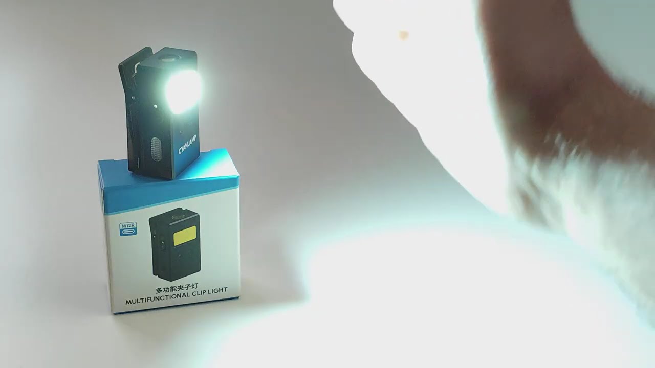

A special feature of the M12R is the gesture control: if an object is detected at a distance of up to 15 cm in front of the flashlight, it switches itself on or off. The function must be explicitly activated by holding down the “other” button (i.e. the bottom one for white light or the top for RGB light) and switches off again when any button is pressed again.
A useful function? It saves you having to search for the small buttons, which are actually not that difficult to find. On the other hand, the flashlight can also switch off unintentionally: a branch in the forest, a careless movement or a moth flying by.
