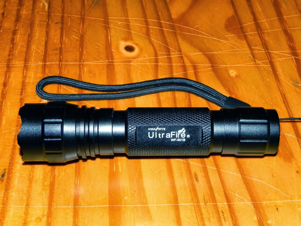

Today I received the Dino Direct Give Away Red 501B flashlight. Three Winners Announcement-Giveaway For Celebrating the Halloween Day in DinoDirect
The ad reads thus:
And the specs red so:
And here it is…
I am quite familiar with the 501B. One of my early acquisitions was a nice 2x 16350 501B that introduced me to the P60 modules.
The bad thing was that it doesn’t take 18650’s due to the barrel ID was too small. This one does not have that problem. The 18650 fits fine.
Overall this is a nice finish including the lanyard.

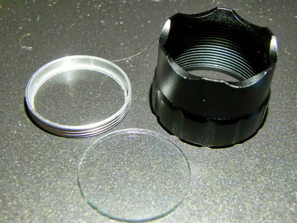

Last word… anyone know how to safely remove the plastic lens on a 501B?

NightSpy asked: how to safely remove the plastic lens on a 501B
If you mean the silver retaining ring which holds the front lens inside the head …
I gently clamp the head vertically in rubber, spread flat-nose pliers inside the ring, and unscrew. Turns out, that thin, flimsy ring is stronger than it looks. With some care, this also works well for re-tightening it.
All the ones I’ve done had glass lenses.
Thanks, 2c’s I’ll have to look at that closer to see if I can find a ring.

The 501B is still my favorite P60 host:
Lightweight? Yup.
Compact? Yup.
Cheap? Yup.
Looks like a plumbing fitting? Nope.
Looks like a stylish flashlight? Yup.
Nice non-slip grip.
I got 3 of them years ago for $10 shipped.
One stayed black, one in the oven for a light roasted brown, one in the oven for a toasted copper bronze color. I have to tell them apart somehow.

Not exactly a wire… its a threaded collar.
And I do believe this is an actual glass lens!
