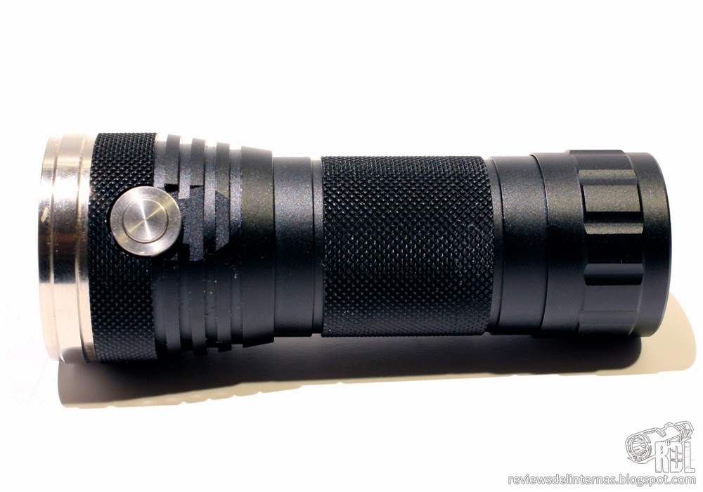

The exterior finish is really good, with a very precise machining and a uniform matte black anodized. The head is topped by a steel bezel, which holds in place the TIR lens for three LEDs. If you look from the front lens gives the feeling that the diameter is somewhat wasted, since the three XP -G2 are located in the central area leaving enough “dead” space on the perimeter. When removing the bezel and lens can see how the three XP -G2 are soldered on I single MPCB, and this Is bolted to the body of the flashlight.
In addition, the circuit wiring is visible and painted in black, and also to improve the aesthetics, prevent reflections or distortions possible chromatic dye three XP -G2. On the opposite side, we found the contact to the positive pole of the battery, consisting of a spring, so that the use of flat -top batteries is entirely possible.
Outwardly, the flashlight head has a strip separating the bezel knurling three discrete cooling fins on the neck. The button is located occupying a plane situated just between the knurling and dissipating fins. Exterior button is made of steel, and barely protrudes the profile of the light. The touch feeling of the button is good, but it will be difficult to locate if you wear gloves.
The central tube is simple and externally is filled with knurled surface, which greatly improves the grip. The threads, triangular cut, are anodized in union with the tailcap and raw aluminum bonding head. Not being anodized allow us to unscrew the head a few turns to allow slightly longer battery enter and operate normally. Both arrive correctly machined, but dry.

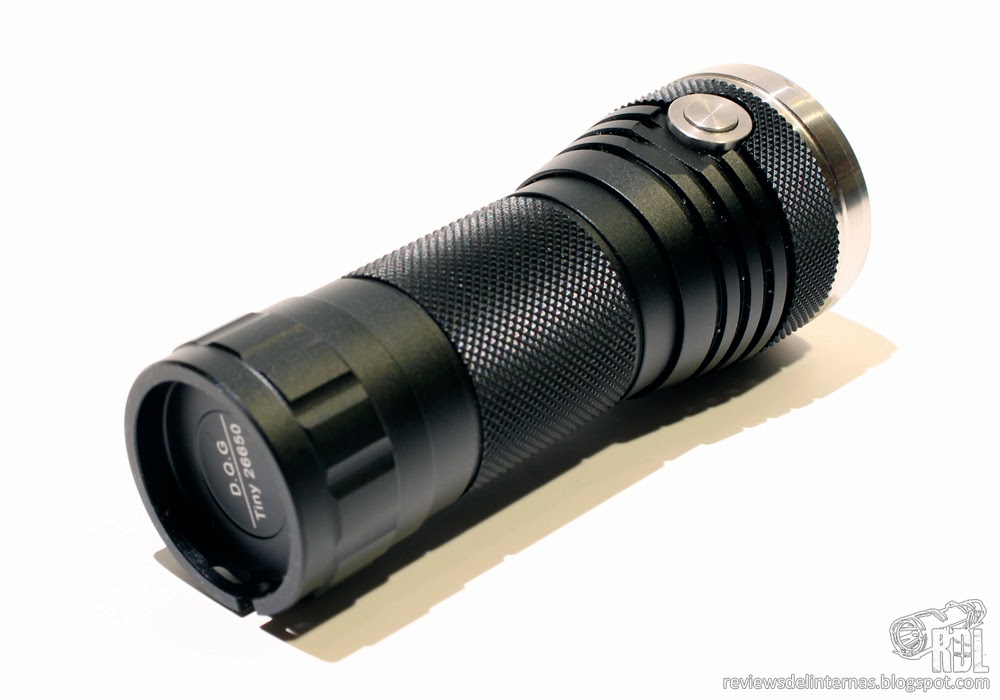

The tailcap has a robust and negative contact spring, and lacks any mechanism or electronics. The exterior has some stripes in relief that will allow us to easily unscrew. At the base we find the only engraving of the light, and surrounding it have two holes for the lanyard or any other engagement that will allow us to place the flashlight in tailstand.
