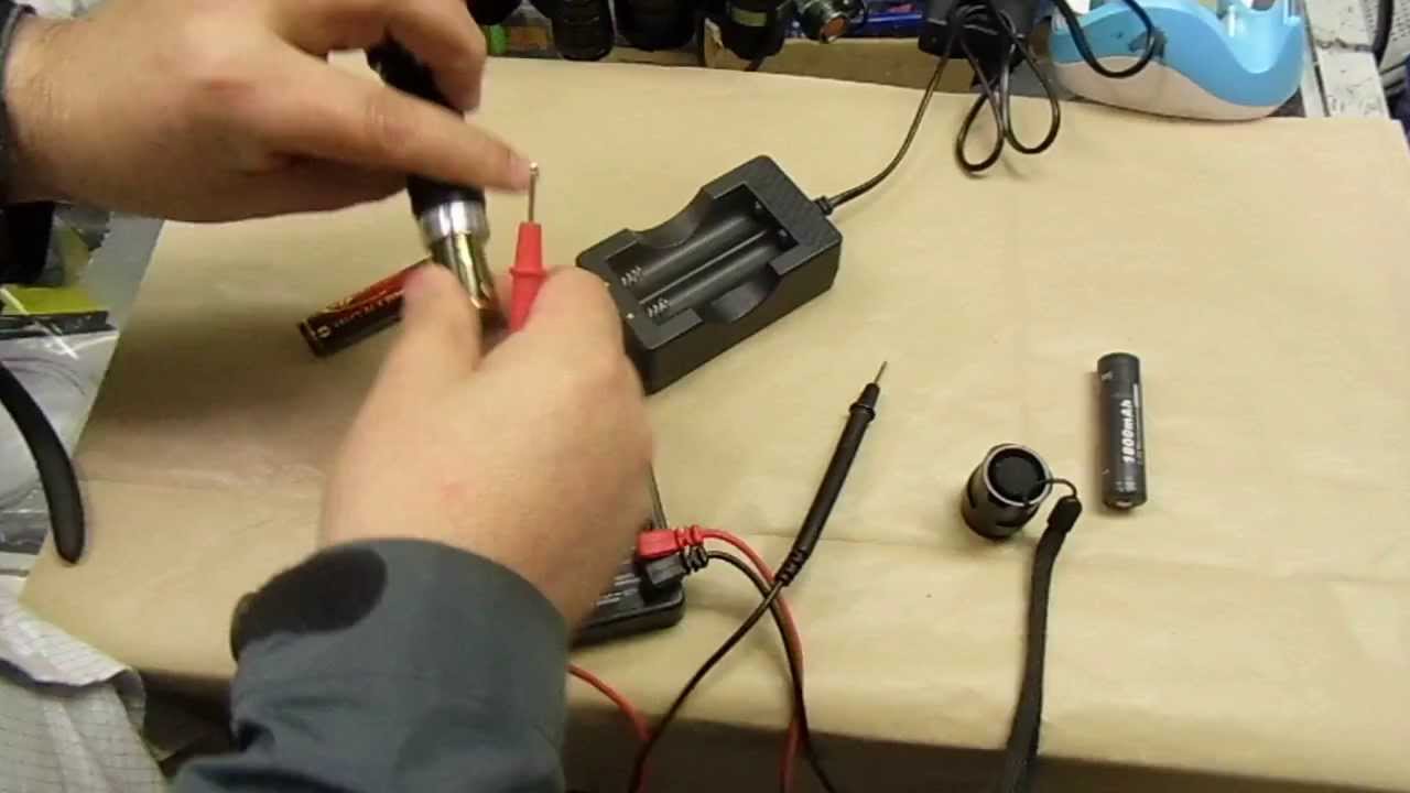

Can you measure the current the Turbo mode is getting from the battery? It will give you a hint of PCB limitations. As my measurements and Ric comments, I guess the 6Amp should be the ussual current for Turbo mode.
Removing a PCB from a battery isn’t hard or risky. This post explain how to perform it in a safe way. This dude on youtube did it in the not safe way and almost burn his fingers lol:
jump to 1:40 for the funny part. :bigsmile:
You’ll need to rewrap the battery with new heatshrink or something similar if after removing the original wrap there is no other isolation wrap (i.e. the cell is bare metal walled)
