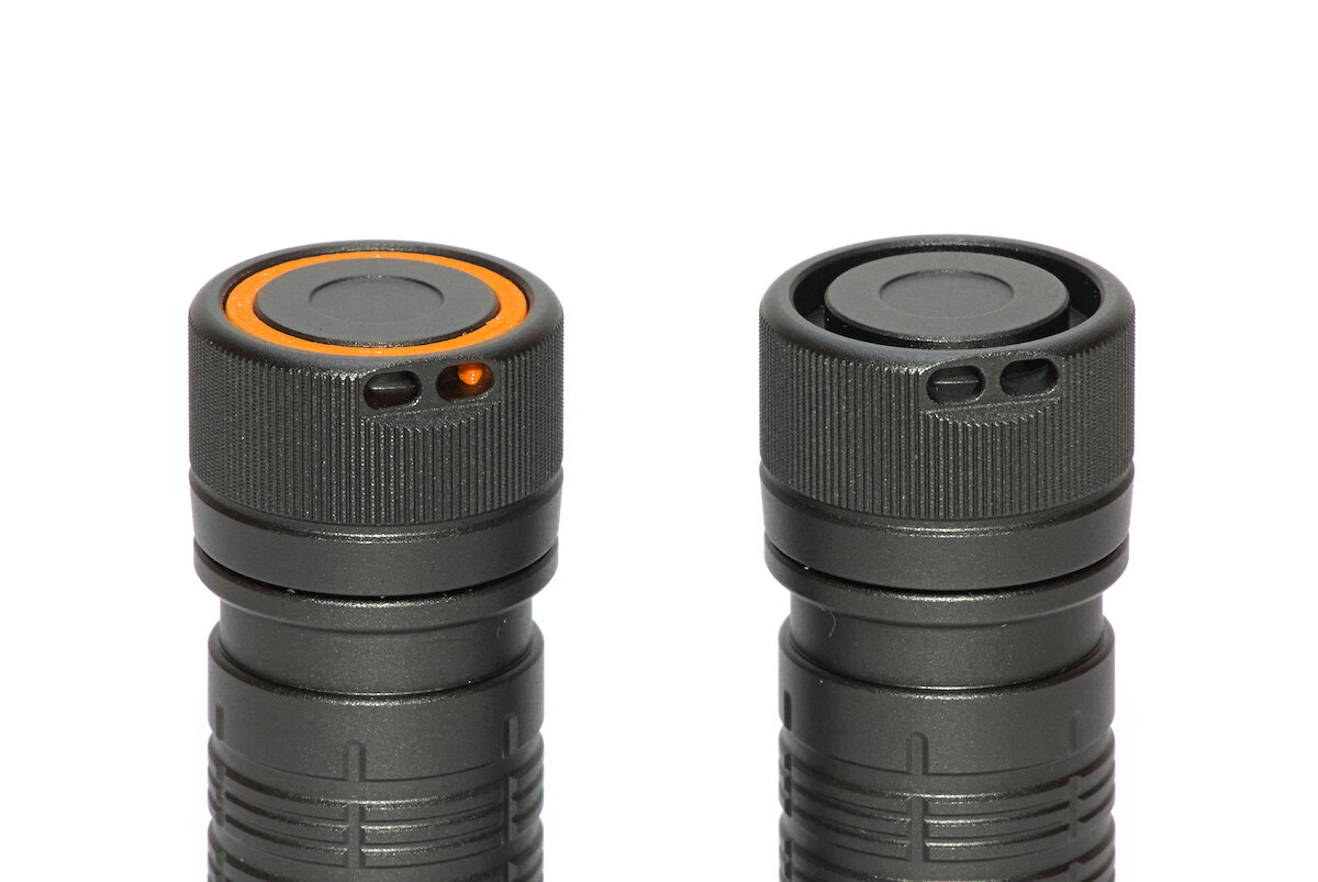

I’ve dedomed one and made a comparison. As expected, the dedoming lowers CCT and duv. The beam got narrower and now has snowflake-like artifacts around the beam (not visible in the photo).
