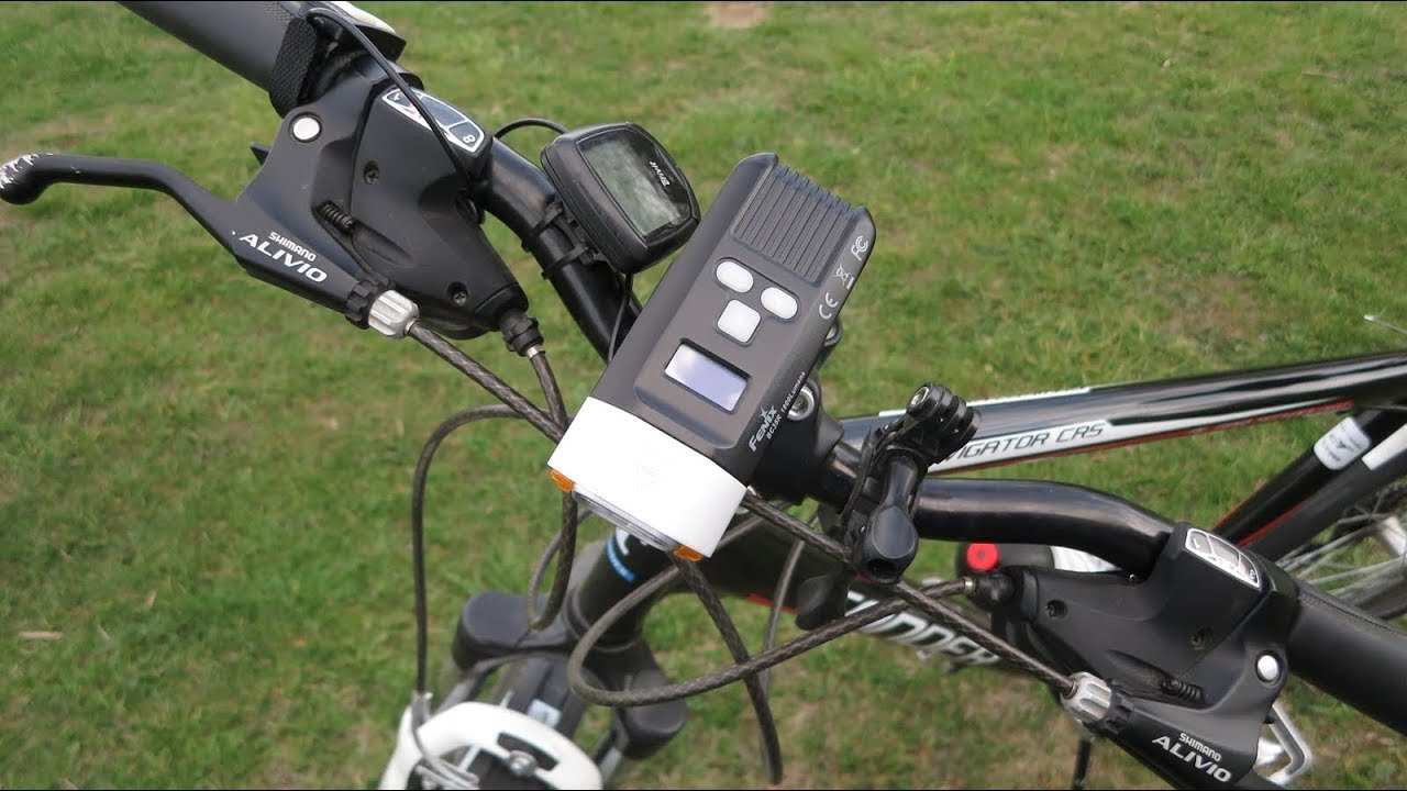

On the front of the flashlight there are two orange diodes and the main diode - XHP50 with a neutral color, placed in a specially designed headlamp, which cuts off part of the light beam, which, like the lights in the car, correctly set should not dazzle drivers and passers-by. The fast is made of plastic, without any coatings, plus it should be noted that it is practically very difficult to get dirty, in the negative that scratches may appear during prolonged use and cleaning.
The “head” of the flashlight, unlike the rest, is covered with silver paint
From the bottom you will find a USB port, it serves two purposes: charging of built-in cells, unfortunately only 5200mAh (it’s a pity that the manufacturer has not placed two cells with a capacity of 3400mAh) and connecting the remote control, which is included in the set. The rubber band securing the USB port sits tight and there should be no leakage problem.
From the top there is an OLED display, very clear, under it there are three green backlit buttons for controlling the flashlight
On the website kolba.pl we can read that the handle is made of nylon reinforced with fiberglass, if it really is - I do not know, while the mount itself gives the impression of solid.
The remote control is mounted in a convenient place (I chose under my right thumb) and connected to the flashlight. How do I rate the remote control? When mounting the remote control on the steering wheel, we do not have to touch the flashlight at all.
Turn on the flashlight by holding the upper button of the remote control, the same button changes the modes, pressing it twice quickly activates the strobe (white and orange side lights flash alternately).
The manufacturer states that the flashlight emits a maximum of 1800lm - it is a pity that this mode works only when we hold the bottom button (and maybe it’s a good solution?). After pressing the bottom button on the remote control Burst 1800lm activates and the countdown starts from 20 to 0 - and ATTENTION, this mode works only if we keep the button!
