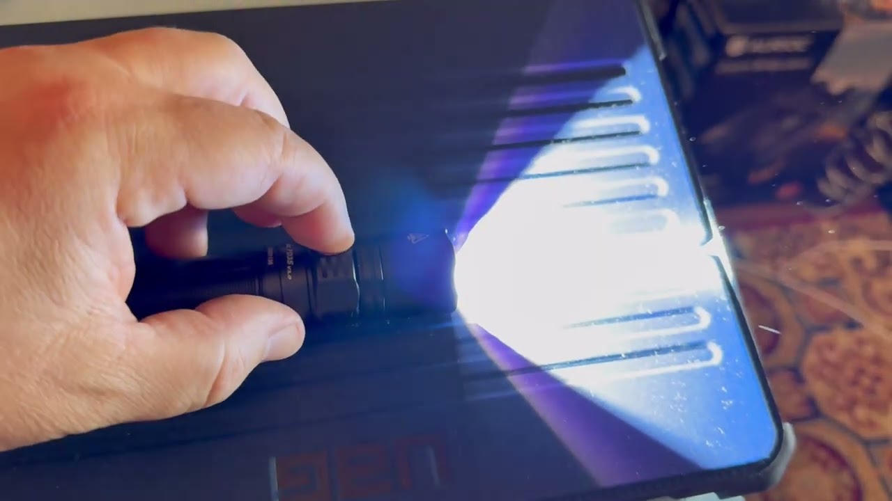

Hi,
I know it’s an old post, but this flashlight is still in production, actually I recently bought one and it seems that I’m having issues with the side MENU switch. I’m pressing it, I can feel and hear it clicking, but nothing happens. I see you’re writing here in the review that it should be easy to operate with thumb, but not for me. To make it work I need to press it quite harder, so hearing the click on the side switch on my PD35 V3.0 doesn’t mean I get an electrical contact confirmation.
I wrote about my issue to Fenix, but they redirected me to the seller (as per the S/N), but I didn’t got a straight answer, so I was wondering if on your PD35 V3.0 you’re getting the electrical contact immediately after you’re hearing the MENU side switch clicking or do you need to press is harder to make it change the gear?
A couple of links showing the issue I am telling about:
I’m still in the return window, but I don’t want to return it and get another one after until I’ll figure out if this behaviour is by design and I got a lemon product.
Thank you!

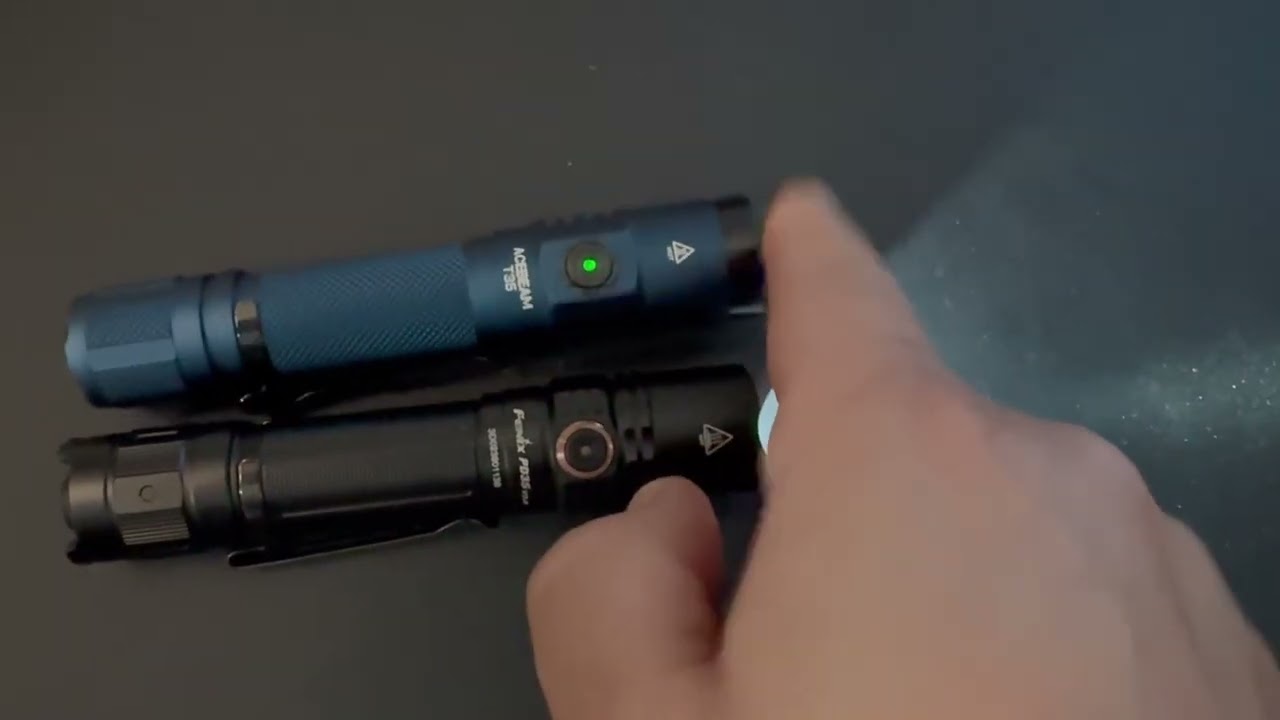

Solved by the store by swap; purchased from emag.ro, but the main seller was Kolba and I had good email threads with them on this matter.
See the difference in how the side switch works on the two lights here: https://youtu.be/0URi_wFa_GU?si=SUrJQIUuG_2pGOH5.
Hope my posts will helkp some of the readers that might happen a similar switch issue with their flashlights.
