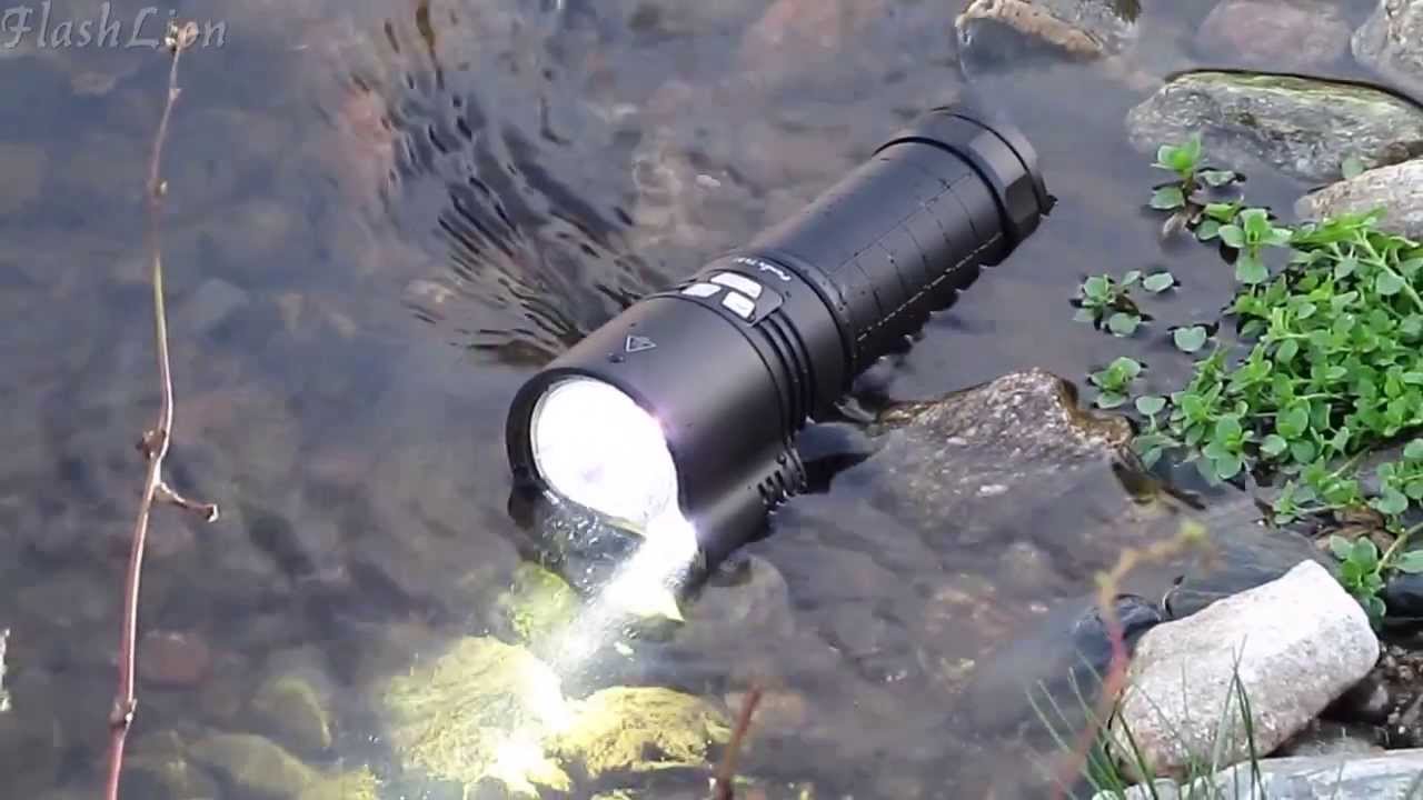

River test
I tested the TK51 in the river.I wanted to see what will happen if I drop it accidentaly in the water when I am on camping,fishing,etc.
Fenix TK51 successfully passed the test. No leaks or fog under the glass lens.The water was pretty cold. All buttons work under water.
