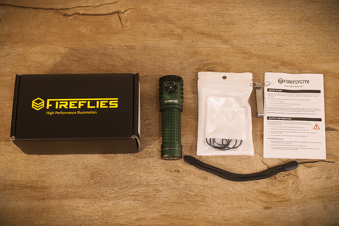

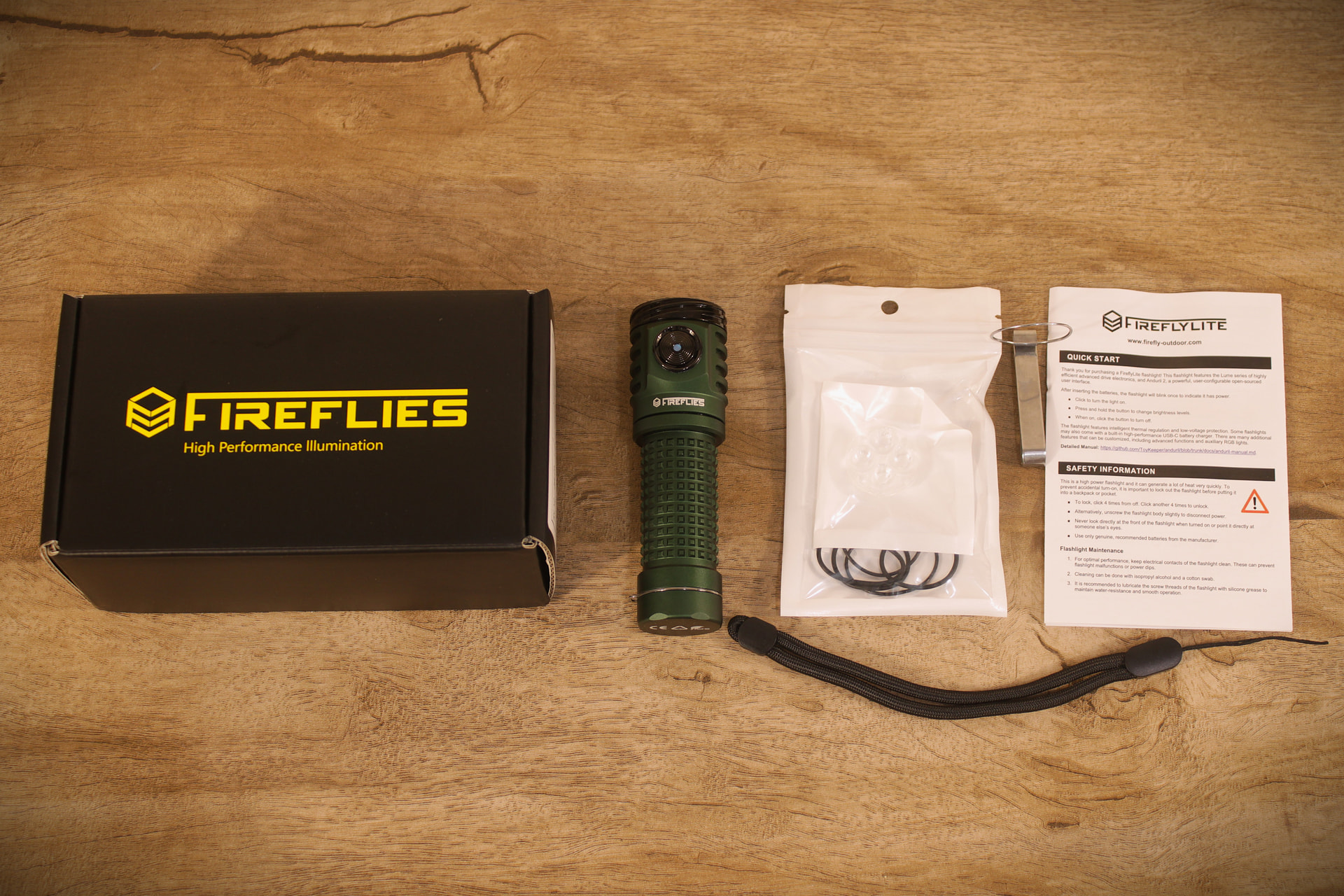

• Box contents
  • X4 Stellar
  • Extra 15-degree TIR lens
  • Stainless-steel clip
  • Stainless-steel lanyard ring
  • Lanyard
  • Extra O-rings
  • Instructions manual

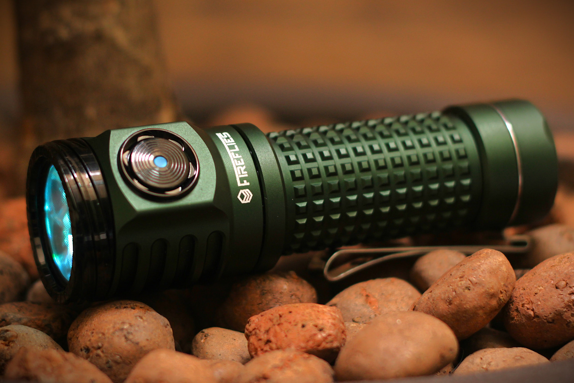

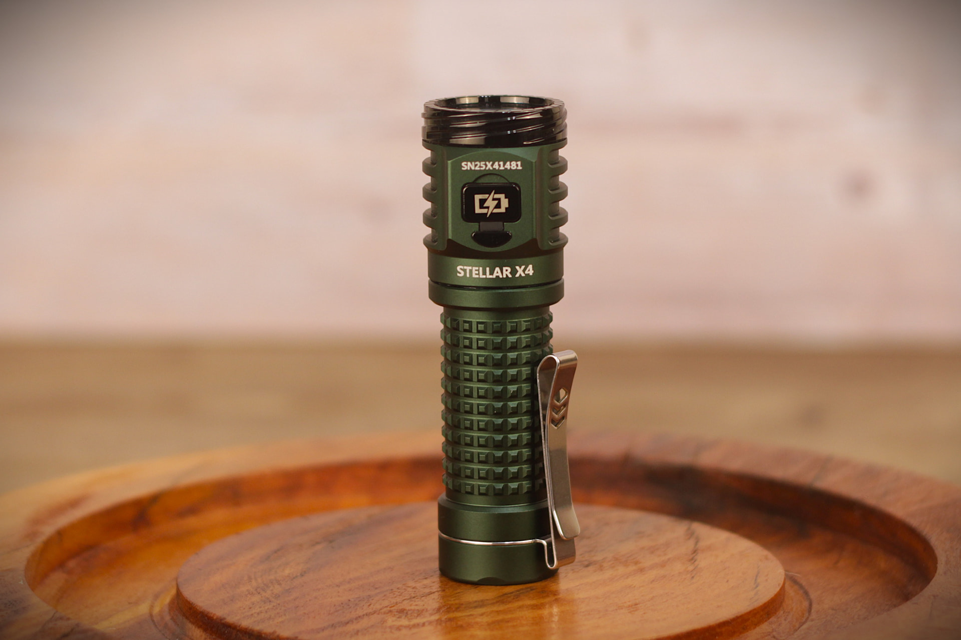

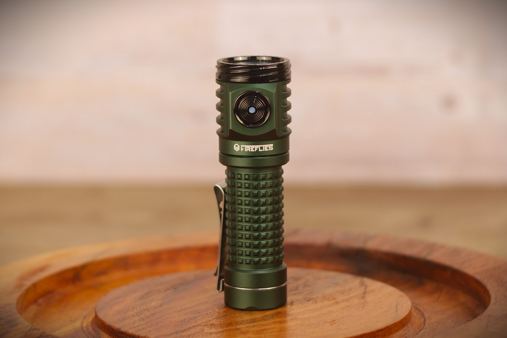

• Body and build quality
Colors/Material Options: This X4 Stellar is the “Timber Green” version, but it’s also available in “Navy Blue”, “Ember Red” and “Matte Black” on the Aluminum version. It’s also available in Titanium and Copper.
Material: The main body is made of 6063 Aluminum, it’s more resistant to corrosion and impact and more durable than the more common 6061 alloy. The bezel is made of stainless-steel with a smooth and shiny black “Multi-coated Black Diamond PVD” coating! The clip and lanyard ring are made of regular stainless-steel.
Main body: The battery tube has big squared shaped knurling with round edges, a more aggressive knurling than usual on flashlights, but it gives a nice grip to the flashlight. The head part has big heatsink “holes” for better heat dissipation, there are two bulges, one where e-switch is, the other where the USB-C port is. The tail cap is very simple, it can be unscrewed and a magnet is inside, on the threads a lanyard ring or a clip can be installed.
Threads: The head threads are squared; the tail cap threads are trapezoidal. Both are anodized.
Clip: The clip seems to be a new version, my X4Q Comet came with the original version, which is the one on the X4 Stellar pictures on the Fireflies website, but mine came with the 2-way clip, which I think is a little better than the original one.
Tail stand and rolling: The flashlight tail stand easily and is very stable because the tail cap Is solid and flat. It doesn’t roll much on a desk because the button and USB-C port bulges prevent rolling a lot, a clip or lanyard ring can be installed to prevent it even more.

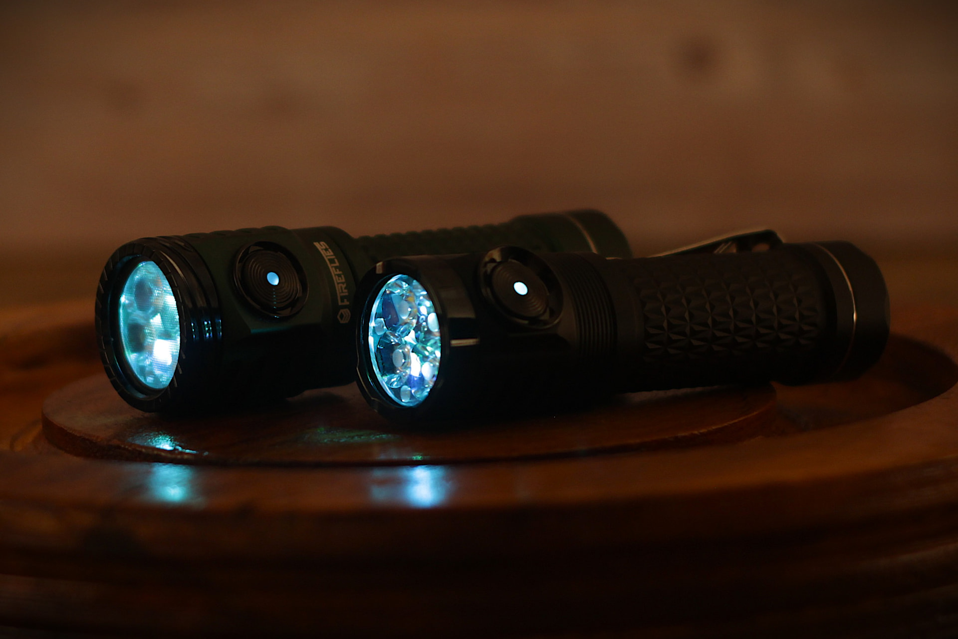

AUX lights: The X4 Stellar has amazing AUX lights, they are RGB and you can control their brightness level and turn it off or into blinking mode. The AUX lights are located on the TIR lens and on the main button, the TIR ones are RGB and you can customize them, the button one is a fixed color and will also light up red when charging, mine came with a cyan AUX light on the button. It’s separate from the TIR ones, other than the X4Q which had a shared LED color with the TIR LEDs, this means the X4 Stellar button AUX will remain ON even if the flashlight is turned on, unlike the X4Q which turns off together with the TIR AUX. The AUX brightness mode is shared, so the button will be off if you turn the AUX off, low if you set the AUX to low brightness, and so on.
AUX Light comparision: The one at the back is the X4 Stellar, and the front one is the X4Q Comet
Buttons: The button is the same as most FireFlies flashlights, the nice e-switch covered by a stainless-steel black smooth PVD coated button! The X4 Stellar comes by default with the normal non-raised ring, which is actually slightly raised above the button, but not enough to prevent most accidental activations. The raised ring comes by default on the X4Q Comet, and you can also order it separately or ask for it to be installed for free when placing an order at FireFlies.
Bezel: The X4Q Comet bezel is an EDC type bezel, no protruding ends on it. It’s made of stainless-steel and has the same nice smooth black PVD coating as the button.
Battery contact: Contact is made with the battery by 2 nice springs, one on the head driver, the other on the tail cap. Both of them are Beryllium-copper springs silver plated for better electrical conductivity.
Water Resistance: It has IPX8 ingress resistance rating! I have to say, the X4 Stellar looks even more water resistance than the X4Q, especially on the bezel/lens part, it has 4 O-rings on there.

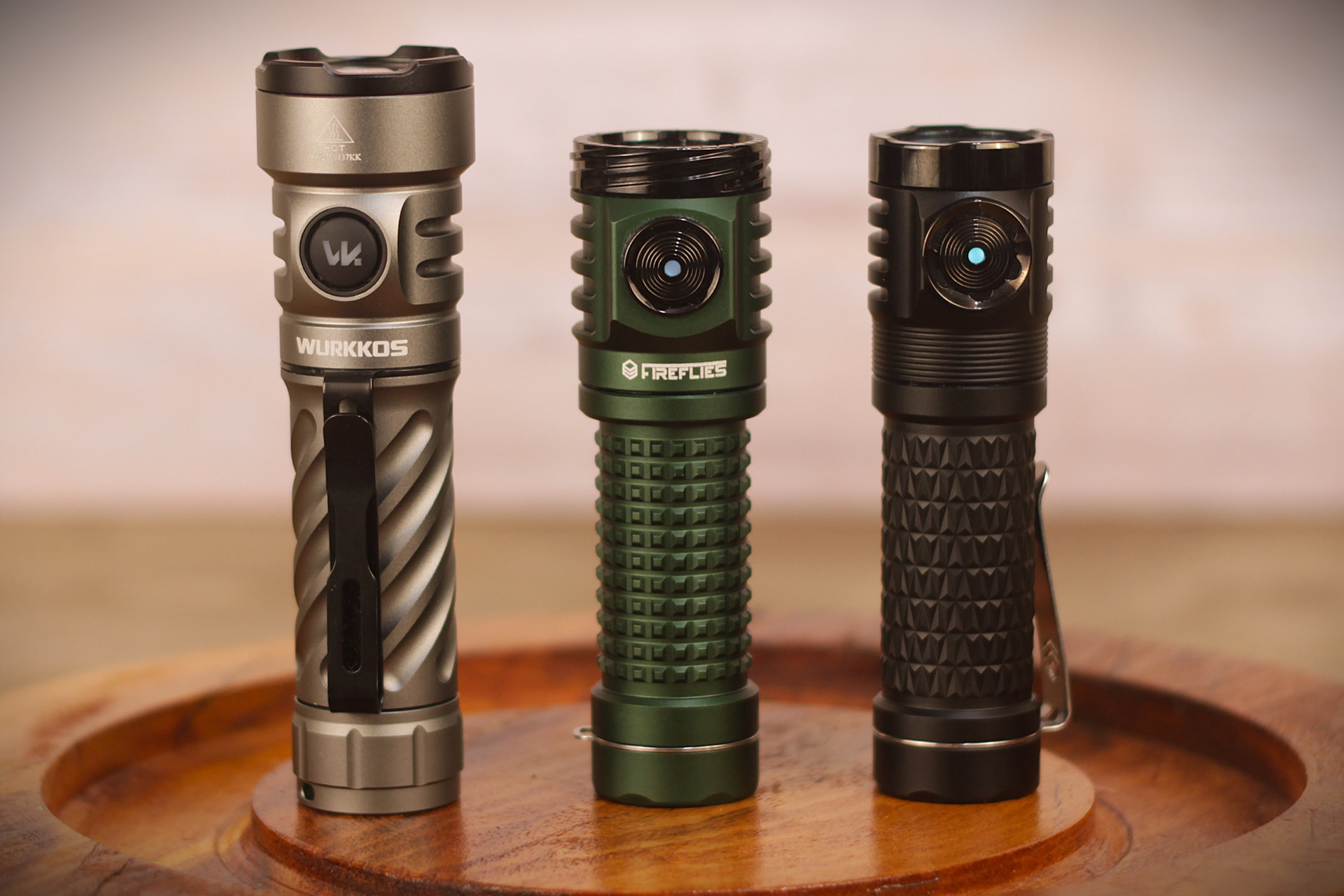

Size Comparison: Here is a size comparison with the Wurkkos TS26 on the left and the FireFlyLite X4Q Comet on the right.
As you can see the X4 Stellar is smaller than the TS26, almost the same size of the X4Q Comet, and it features USB-C charging, this adds a bulge on the opposite side of where the button is though.

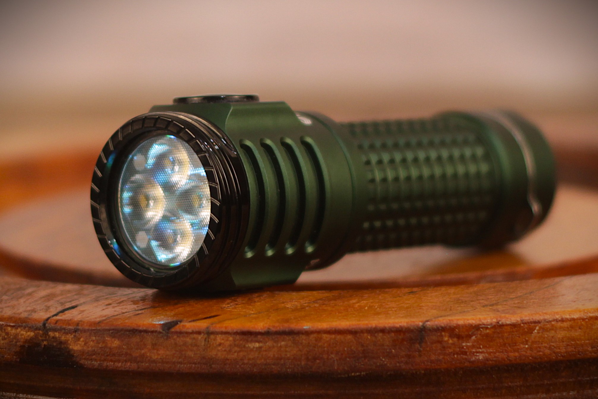

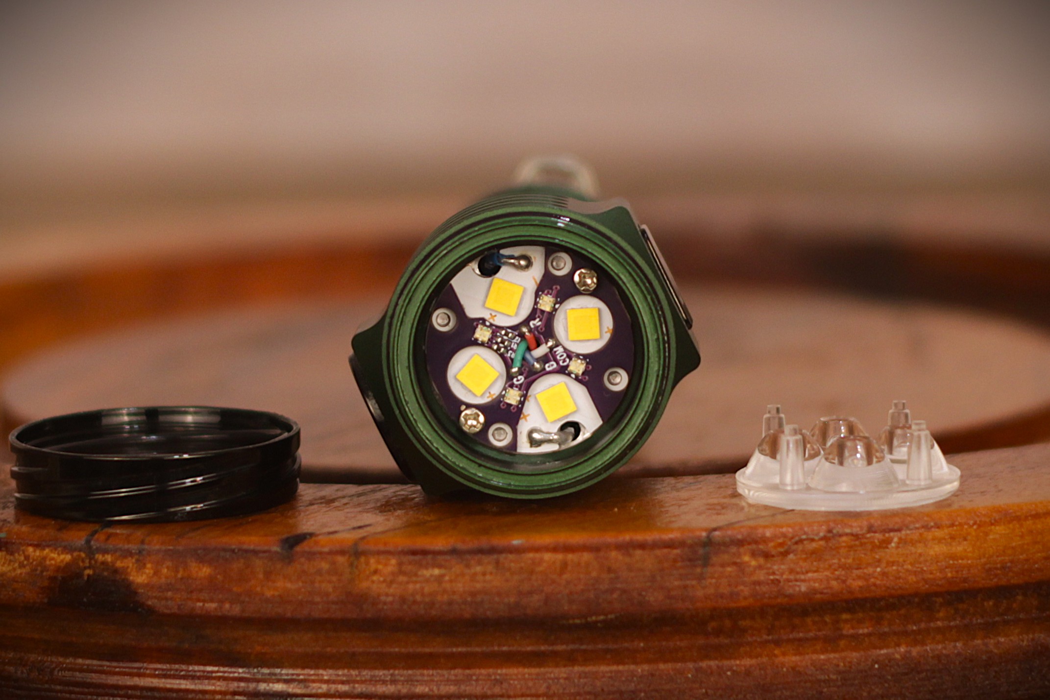

• Emitter, reflector and CRI:
Emitter: This X4 comes with the FFL351A high CRI LED in 5000K, it’s an emitter especially made for FireFlyLite! It’s available in several CCTs, but the main ones available on the X4 Stellar page are 1800K, 2700K, 3700K, 4000K and 5000K. All versions are high CRI (95 CRI). The lower the CCT less lumens it will generate. The SFT25r LED is also available with 4000 lumens.
Lens: It comes with a glass lens double AR coated and it’s advertised to be 98% transmittance.
Reflector/TIR: It comes pre-installed with the 30-degree beaded TIR, and an extra 15-degree beaded TIR is also included on the box. Both options are pretty floody, I think it should have a clear 15-degree option on the box like the X4Q Comet for a more throwy option.
Beam profile: The beam profile with both TIR lens Is very floody and homogeneous, no artifacts or donut holes, nothing. The hotspot is more defined on the 15-degree but still blends very smoothly with the outer spill.

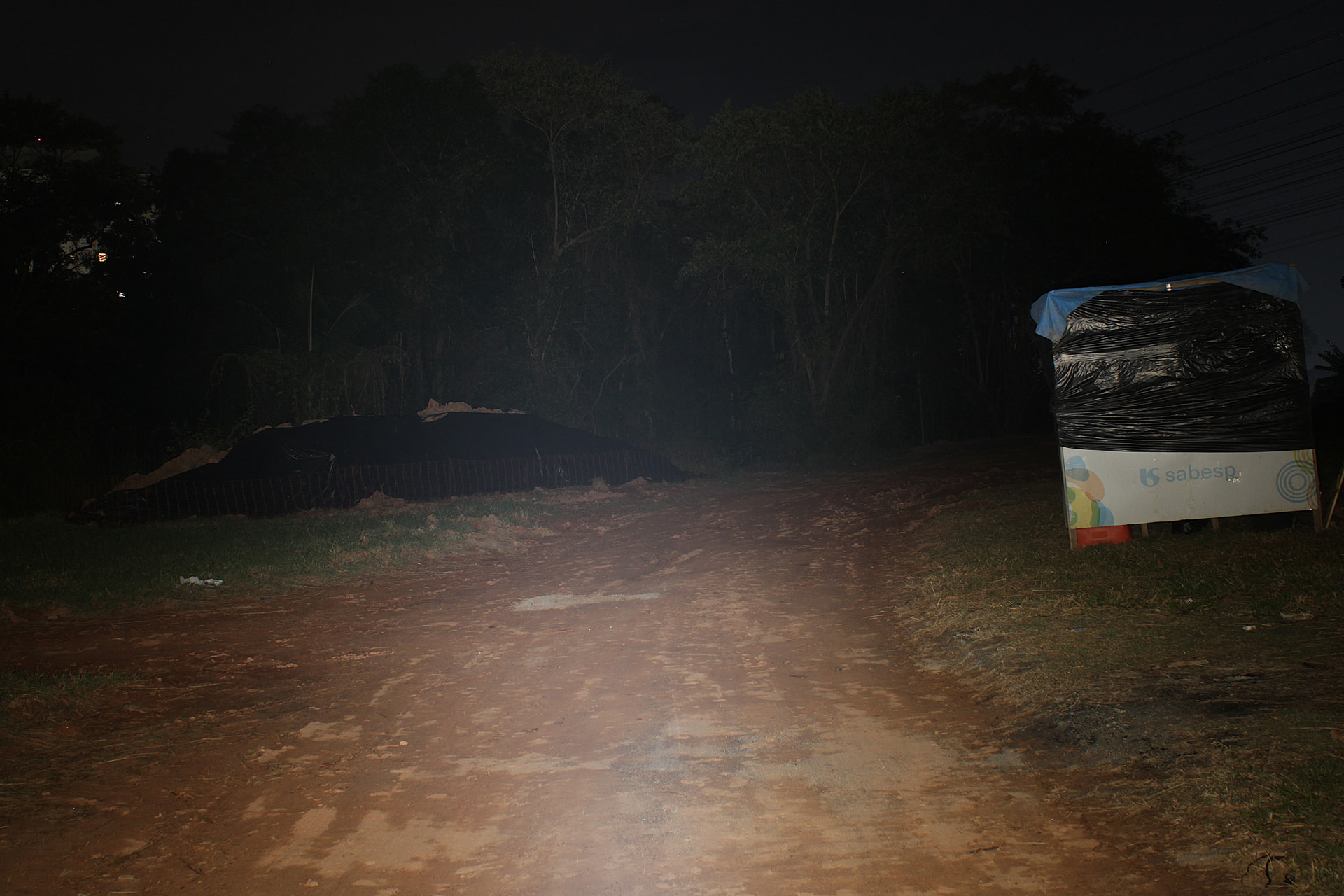

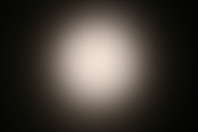

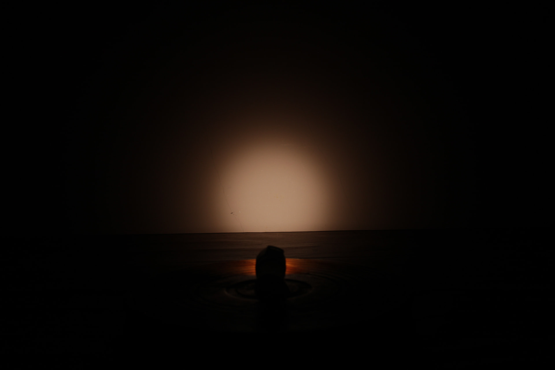

X4 Stellar 5000K - Turbo (2800 luemens) mode
X4 Stellar 5000K - G7 mode
X4 Stellar 5000K - F6 mode
  • The trees at the back are around 100m distance, I could measure with more precise tools so now I have a more precise distance.
I always try to match what my eyes can see on the beamshots, so camera settings may vary.

Driver: The X4 Stellar comes with the Lume X1 40W constant current “Boost” driver! This driver is very efficient and high power for a tiny flashlight like this. I see no major downsides with the driver and it’s a pretty good driver.
