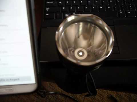

Pair your Asgard by turning it on in any mode then, after 5-7 seconds have passed give a quick half press to enter BT mode. Once in BT mode the emitter will flash 3 times in a row in low. Pair with your phone then open the FLEXcandles app. Click "Connect".
The FLEX app can also store profiles for more than one FLEX enabled flashlight. Once paired, the Model # and MAC address of the flashlight is displayed at the top. If you have more than one FLEX enabled light you can select from a dropdown list which one you are working with.
Once your Asgard has connected with the FLEXcandles program you will see the battery voltage and temperature of the light. You can alternate between Fahrenheit and Celsius by touching the temperature display.
You can also enable or disable battery protection and mode memory from this screen by toggling the switches at the bottom of the screen.
At the very bottom of the screen you will see the Serial Number of your FLEX enabled light which is hard coded into the driver itself. My particular example happens to be the very first FLEXcandles light produced.
