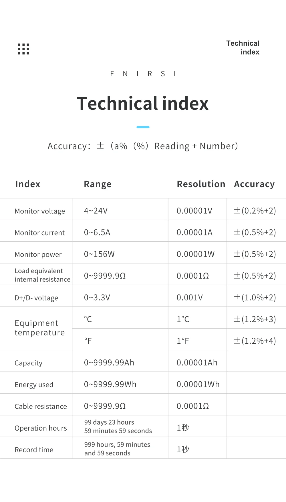

Here's the specification sheet taken from the manufacturer's listing.
