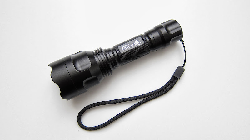

So, why the joint review? Well, I must say, when I first saw the Kinfire K108 at GearBest I immediately liked the design. As I don't own any Ultrafire lights I wanted to see just what they can be like. The C8 is arguably one of the most popular budget models. When the lights arrived for me to peruse, a comparative review made perfect sense. You will soon see why.
Currently the Kinfire K108 is 18.71 USD, and the Ultrafire C8 is 8.44 USD. Both flashlights are designed to run on a single 18650 li-ion cell.

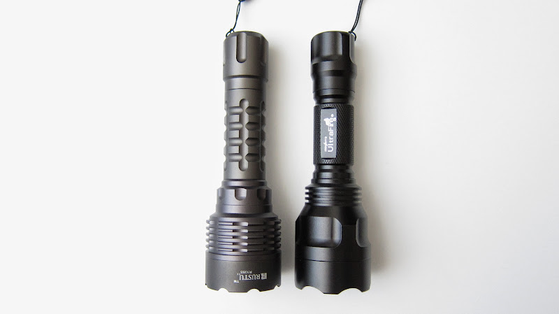

The Kinfire K108 shown left, Ultrafire C8 on the right:

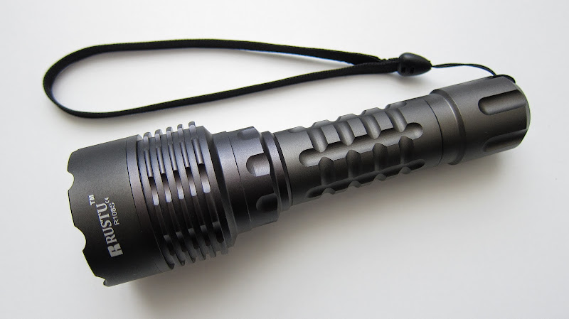

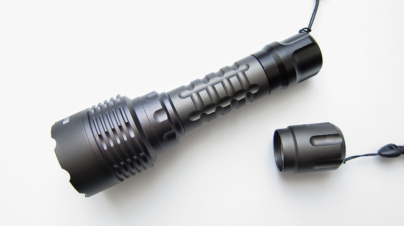

The Kinfire has a Rustu logo, and model K108S on the bezel, so from now on I will refer to it as Rustu K108S. The colour is not black but a lovely grey. It might sound strange, but I do like the way this light feels in the hand. It has a nice weight to it. At 140g it is only 20g heavier than the C8.
Machining and anodization feel great. Not quite as nice as Convoy or Tank007 but noticably better quality than the Ultrafire, which is on par with other cheaper budget lights. There is a degree of 'you get what you pay for' here.

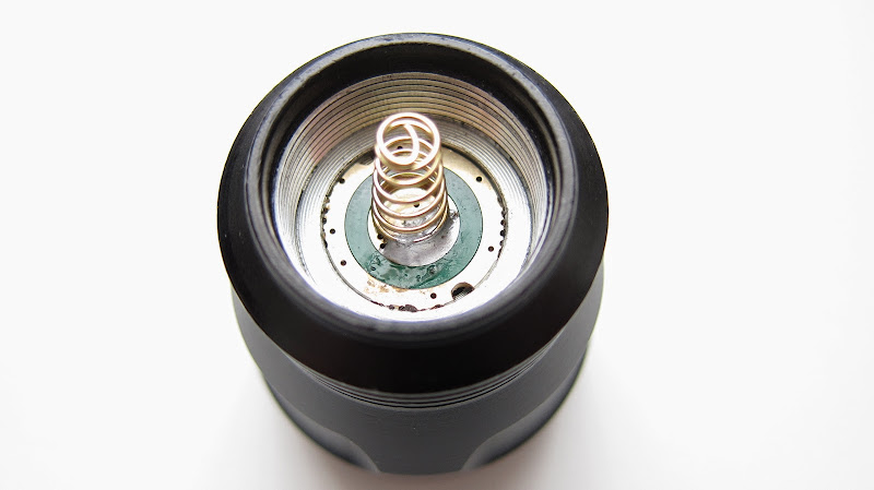

Driver spring soldering is a bit grey:

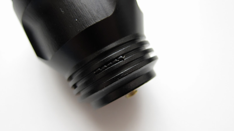

The grip is just for show; body tube feels smooth. Threading is not squared, and single o-ring sealing only:
There is some silicone grease, but the threads were quite grey with old grease, so I will have to clean them with isopropyl alcohol and apply fresh grease.

The Rustu again:

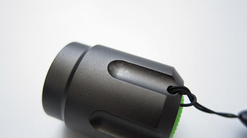

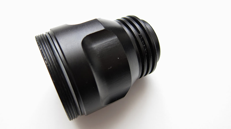

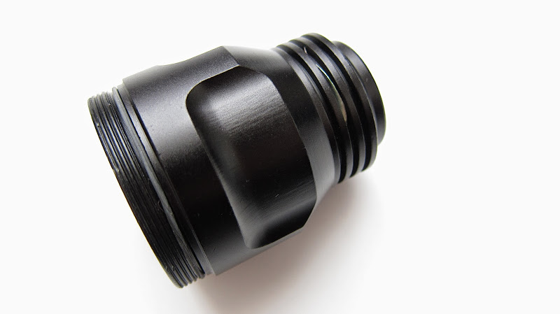

It is almost perfect, except that the finned part of the head is a different shade to the bezel, body and tailcap. This is more noticable in photos than in the hand.

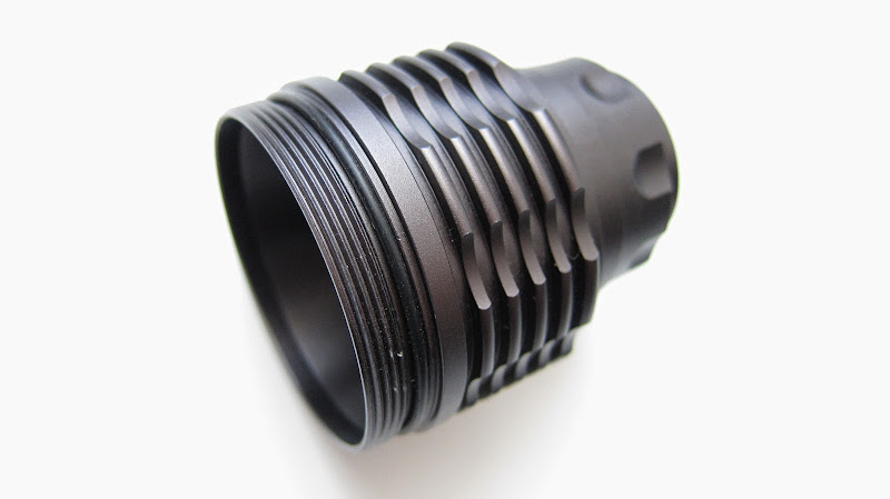

Bezel has a nice cutaway for the o-ring to fit snugly:

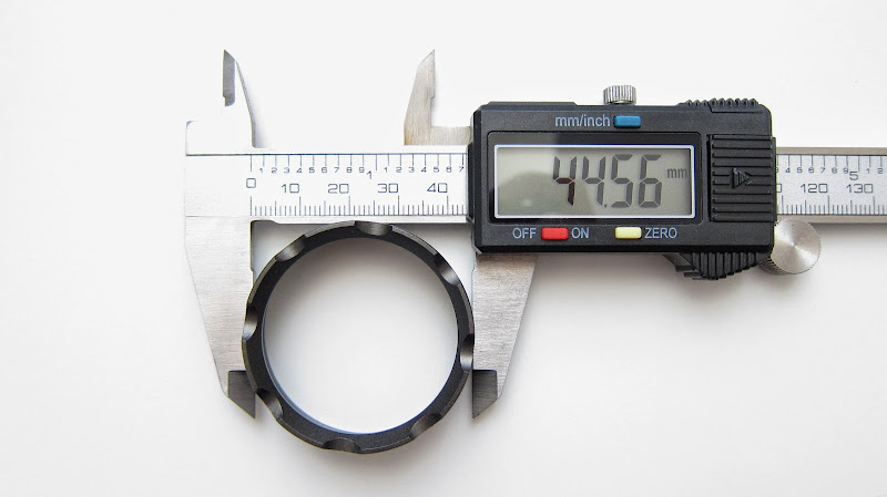

Bezel diameter is 44.5mm.

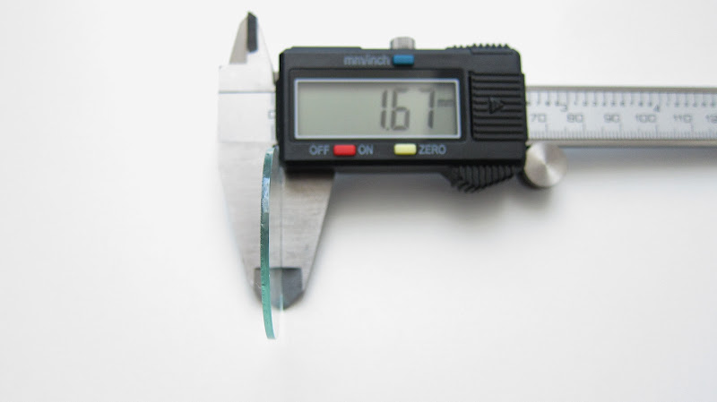

Non anti-reflective lens is quite thick:
More anodized threads. These fins feel great too. No sharp bits at all. I will not worry about handling this light in the winter with my knitted wool gloves.

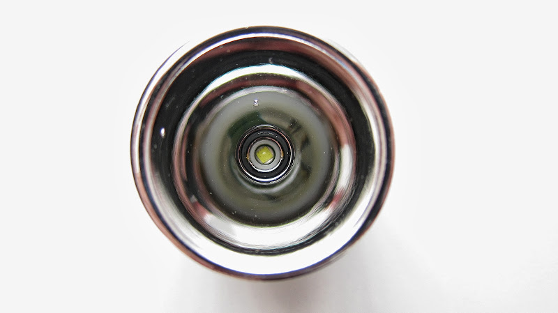

The reflector is very nice, only slight defects right at the LED opening, and near the inner edge of the bezel:
There is no spring at the head, so flat top cells will need magnets or similar to help make the circuit possible.

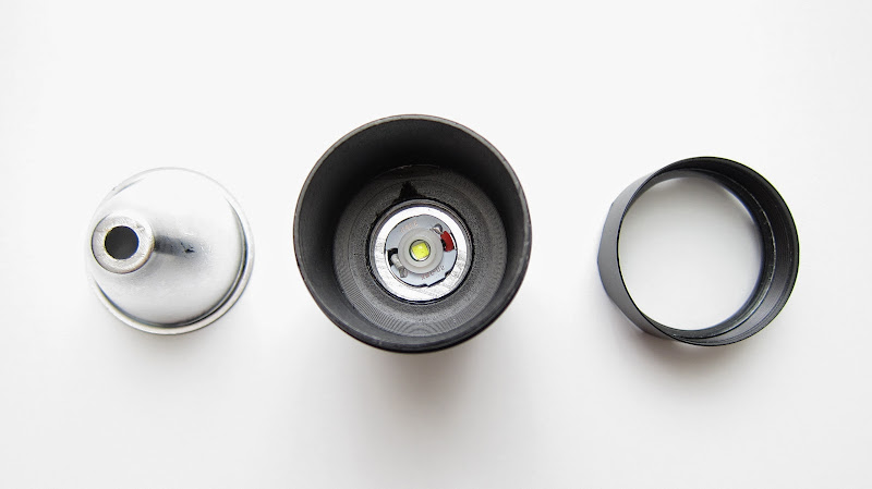

Inside the heads (Rustu left, Ultrafire right):

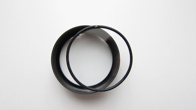

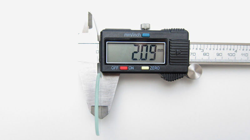

Ultrafire C8 lens is rather thin and doesn't inspire much confidence. It is like the lens in my Goread CK-36, which broke easily.
There is a groove for the o-ring in the Ultrafire bezel, but either the o-ring is too small or the machining is just a bit off, so it doesn't sit nicely or stay put:

This is why o-ring seating is important to me. The seal in the Rustu is good. I do not like this gap on the Ultrafire lens (right). Maybe this is why the o-ring came fitted between the lens and reflector.

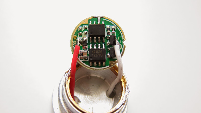

The Rustu driver is actually three mode (High, Medium, Strobe) rather than the five mode described on the product page. I am glad for the lack of additional modes (Low, SOS) but others might be disappointed by this.
I might be in a minority but I do not find a low mode on a light of this size that useful (certainly not as useful as a good Medium mode), whereas a strobe might be, for tactical distraction purpose. I don't want to cycle through too many modes to get to it either. Output-wise, this low mode would be better coming from a small pocket or keychain light, unless this was the only flashlight to hand.
There is mode memory, and a faint whine audible on Medium setting.

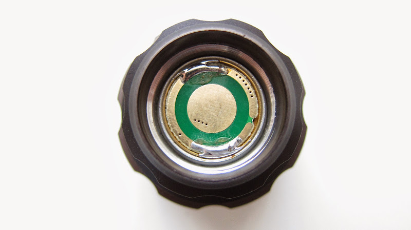

Just visible is a copper ring, to which the PCB was partially soldered to:
The Ultrafire C8 driver has next-mode memory, and five modes (High, Med, Low, Strobe, SOS). On the PCB is written "CX-5117-05", and there are many 3R0 resistors.
Both drivers have silicone wires to the LED.
