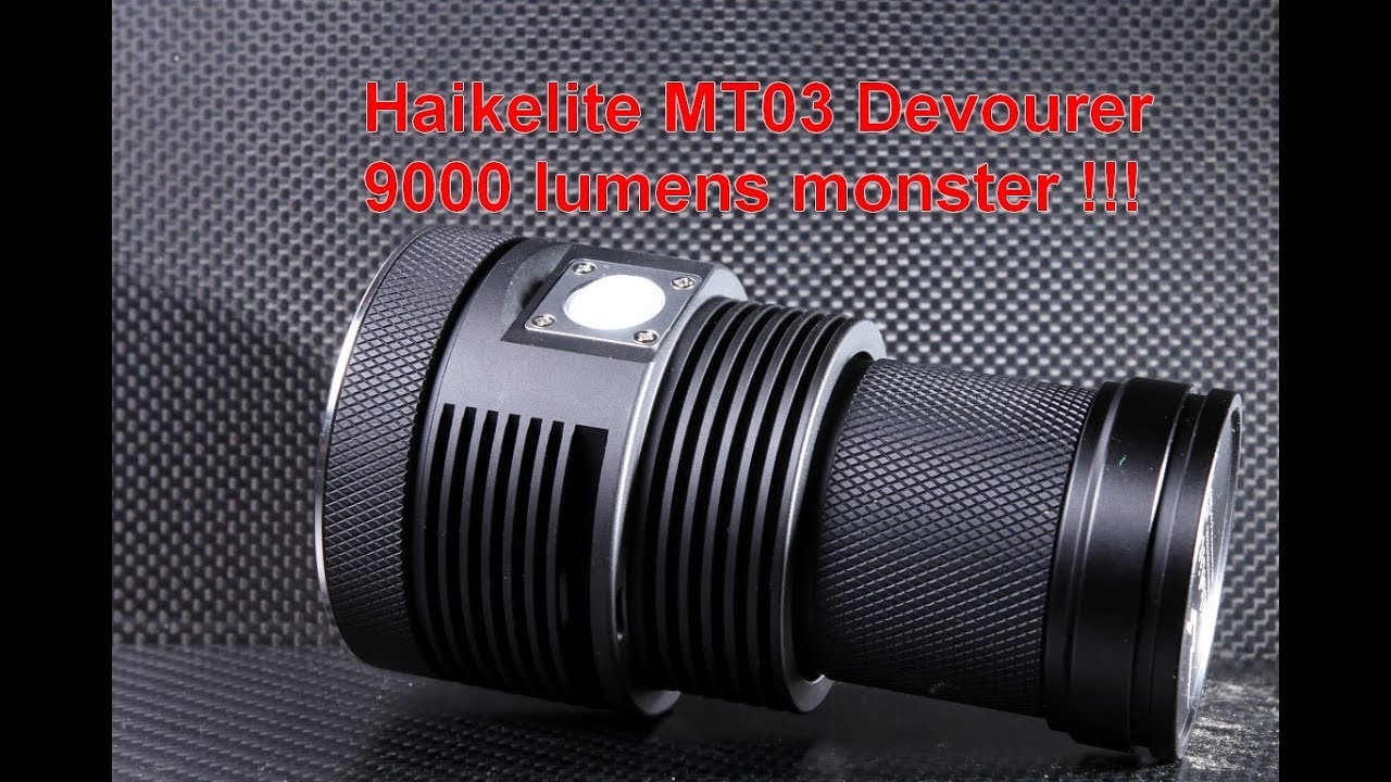

Light body is really good machined and there are a lot of deep cooling fins. That’s a good point to deal with high amp and temp rise. The threads on both side of the battery tube are well machined and there is a lot of lubrification.
Battery tube work with 4 18650 cells and it is a 2S2P config. The tailcap is special and for good alignement (2S2P config !) there a 2 small pins with different diameter so you can’t plug it the wrong way. There are also plastic spacer on + contacts to protect from reverse polarity.
I would say that the light give a very good feeling in hand and seems very well finished. That’s comparable to my nitecore flashlights. Good point Haikelite
