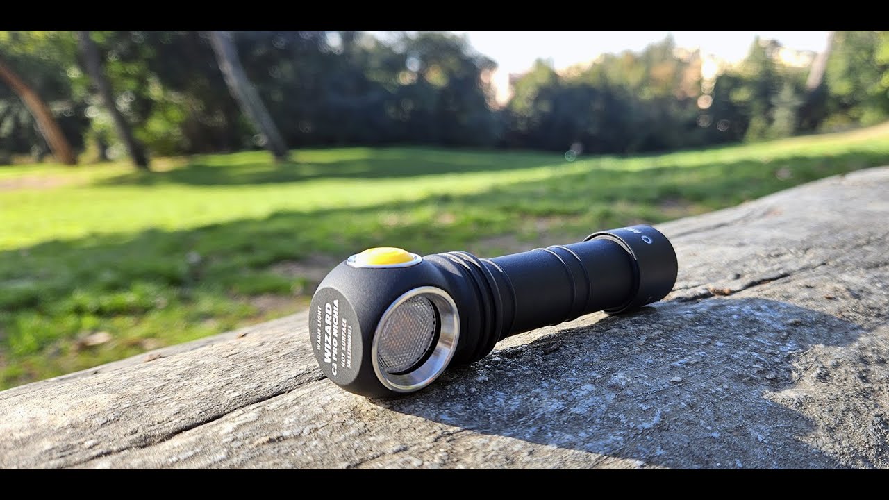

Wizard C2 Pro Nichia is a beautiful and functional flashlight. It is built in lightweight and shock-resistant aircraft aluminum with new springs for better protection and battery contact. Even in this version, the matte anodization is sensitive to scratches, or to the insertion of the supplied Clip, but to the touch the impression is excellent; it does not slip despite the smooth body and does not roll.
It holds well and the weight on the head, even with the battery inserted, is not excessive (115 gr). Thanks to the tail and flat head it is possible to put it upright (tail standing) or with the head upside down.
Starting from the head we note the TIR optical system that provides a wide and uniform beam (hotspot/spill: 70°:120°) without distinct hot spots and sharp edges, tempered glass and anti-reflective coating surrounded by a protruding steel bezel for better protection of the optics. Also highlighted are the horizontal cooling fins and the ever-numerous writings.
