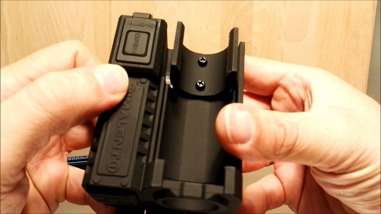

- I really love the ideas imalent used to build that flashlight and holster!
- the dial wheel (which can easily be operated with one hand) is as simple as perfect
- the sensor instead of a clickie is gorgeous! (in theorie)
- Imalent once again showed us that they do not fear to try new ways to change the way we use our flashlights.
- the build quality and used materials are very good (beside the holster ;)) and at the high standard we are used to see from them.

but in my personal preference there are some things why i will not EDC this light / holster ...
- the holster is still "meh" - full of great ideas, but not perfect (i think it will not last very long - but time will tell)
