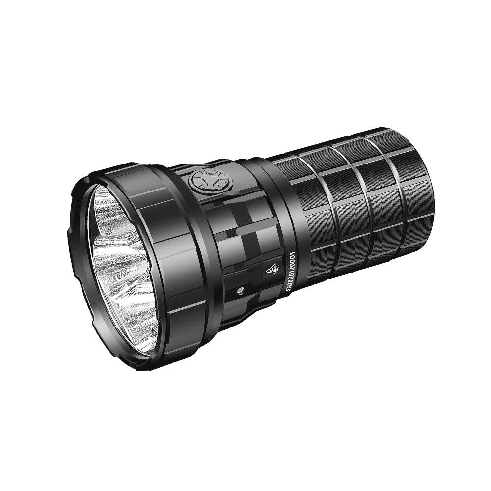

The Imalent R60C uses six SST70 leds with 6500K 70CRI in an orange peel reflector. It has more throw than the Imalent MS06 because of the smaller leds and bigger head. The SST70 consists of four SST20 dies together and is available only with 6500K. The flashlight uses three 21700 batteries in parallel and a boost driver to drive the 6V SST70.

Appearance
A green led at one side of the flashlight lights up when it is turned on. With a 3s long click it can also be activated to be on permanently. As it is not close to the switch I don’t see the point of having it on permanently.
The low mode is a bit bright and there is no moonlight mode available.
As I am used to side switches with rubber cover the side switch of the R60C feels a bit weird. It is made of textured plastic and rotates. It has a nice firm click. If you put it into a bag where the switch could be accidentally pressed, I would always recommend locking it out.
The battery tube has a rectangular knurling with some fine lines to provide better grip.
The R60C comes with a holster included. It is open at the bottom and has a belt buckle on the back. I would prefer a closed holster to protect the full flashlight. The holster of the Astrolux MF01S is a nice example and it would also fit the R60C.
The threads are square cut and very well lubed in order to screw smoothly and without squeaking.
The glass lens has a blue-purplish AR-coating.
