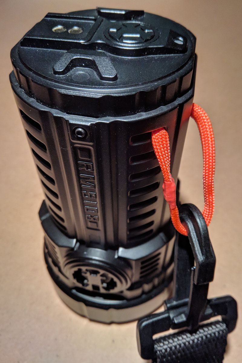

Heat Shield
Although the flashlight reduces its output to prevent overheating and damaging itself, it quickly gets pretty hot to hold. The solution: A “Heat Shield” made from plastic that is slid over the flashlight like a sleeve.
It also contains two little fans to cause some additional air flow. This doesn’t cool down the flashlight (it will step down in the same time), but makes the flashlight comfortable to hold even when it’s 80 °C hot. And it works very well!
To power the fans the heat shield has a small battery (not exchangeable) and its own charging contacts. That’s why there are two charging cables in the box! Charging takes about 1.5-2 hours at 1 A. When the battery is empty after about 2 hours, there’s no additional cooling anymore. Or: Is one of the batteries empty, you’ll have either heat or darkness.
The fans are controlled by a switch at the bottom of the heat shield. They turn on randomly in your pocket because the switch is exposed and there’s no way to lock it. If I had designed this thing: Contacts between heat shield and flashlight so that the heat shield can be powered from the flashlight itself. This also means that the flashlight can turn on the fans automatically when it gets hot.

Unfortunately there is nothing to add a lanyard (almost, see later), no clip, no screw hole. But you will get a holster.
It can be attached with a velcro loop or a D ring. The loop is too small for a belt (do you really want to carry 800 g on your belt?) and are more intended for a MOLLE style system.
The holster has a major flaw: The bottom is open. With the heat shield it fits perfectly, but without the flashlight will slip through the bottom (but not completely). Why not make it closed, this would also protect the fan switch from accidential activations.

Solution to the “how to carry” problem:
