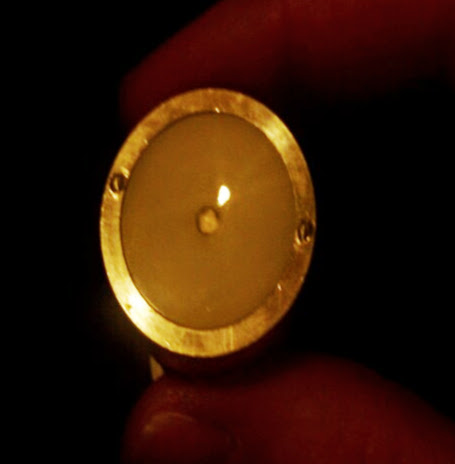

I took a few pics of it in the package, then started pulling it apart. Oh wait, no, before I pulled it apart, I looked at the front of the lens, and noticed that when I zoomed out (pulled back) the LED looked centered, but when I zoomed in (pulled out) the LED was off center. Hmm, that’s weird. Okay, on second thought, how about a test before cracking it open? Well, it was a bit disappointing. It has a zoom range of not-quite-spot to just-shy-of-flood. I didn’t actually take any beam-shots until after putting it back together, but, here, see what I mean:

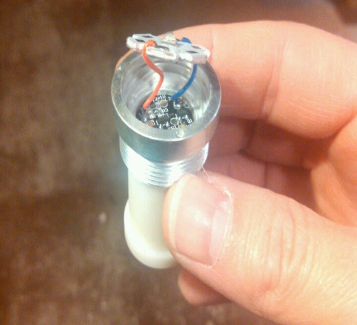

Finally now, we can talk about the break-down. I took the head off, and saw immediately why the LED looked off-center when I viewed it down-the-barrel earlier:
Yep, it was like that when I opened it! Here we have a CREE XP-G2 LED on a 20mm aluminum star, hanging out from the hollow aluminum pill that it is supposed to be resting on. There isn’t any kind of adhesive or epoxy or screws or anything at all to hold it down. And here’s what it looks like, when I’ve been able to get it to stay down long enough to take a picture:

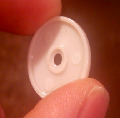

Yikes! Not much contact there! And, I think the centering ring is what is supposed to hold it down, actually, so here are a couple of shots of that marvel of engineering:
Here it is installed. Sorry for the dark picture.
