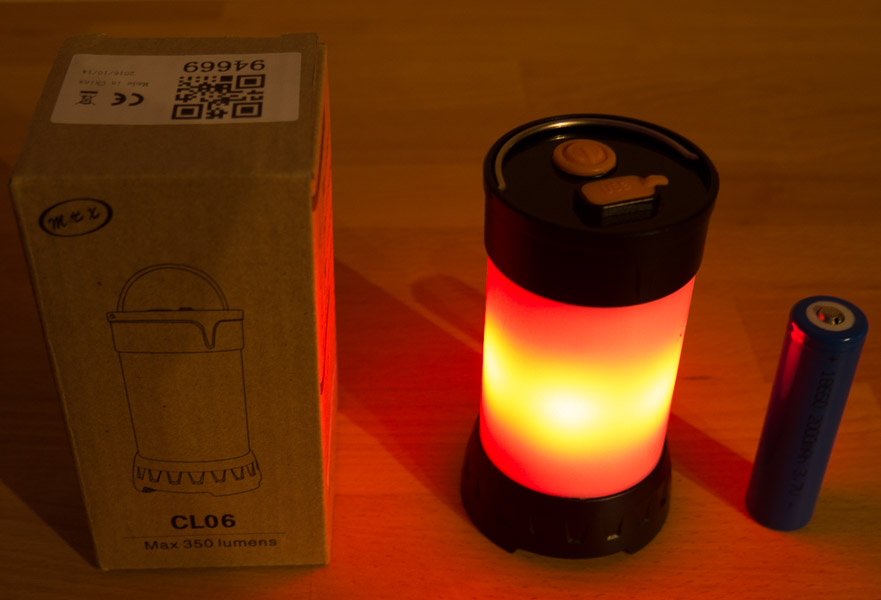

Bought this one on ebay for 7.99€ plus 2€ shipping.
The light comes in a small box.

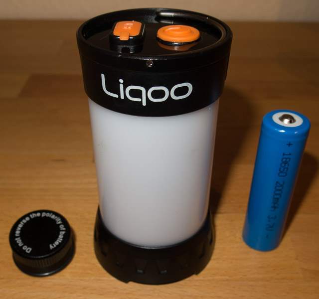

technical specs:
5 modes: High, Medium, LOW, Red light, Red beacon
Battery: 18650 with USB build in charger
Recharge time: approx. 3 hours with 2000mAh
Runtime: High: approx. 3 hours
LED Type: 24x2835 SMD(white light) a. 6x2835 SMD(red light)
Brightness: 330lm Light temperature: 6000 - 6500K
IP rating: 64 waterproof
Size: Ø 5,5cm x 10cm
Weight: 178g with battery, 136g without

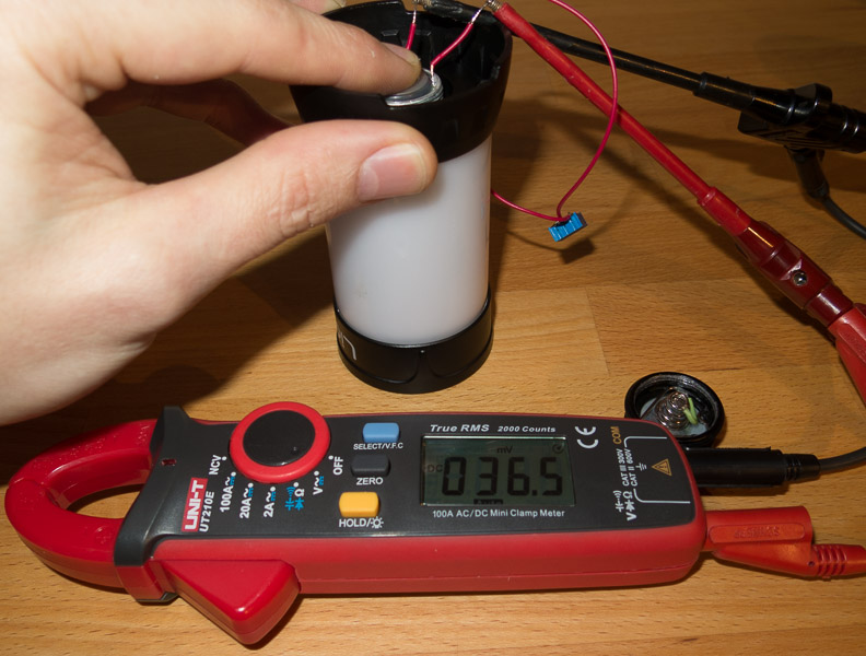

The highest white light drains 0.78A High, 250mA Med, 66mA Low, 137mA Red and 50mA Red beacon.
Lower currents meassured with an 1 Ohm shunt.
Standby current is 36.5uA measured with an 1kOhm shunt, so a 3000mAh battery lasts 9 years thats probably lower than the self discharge of the cell.

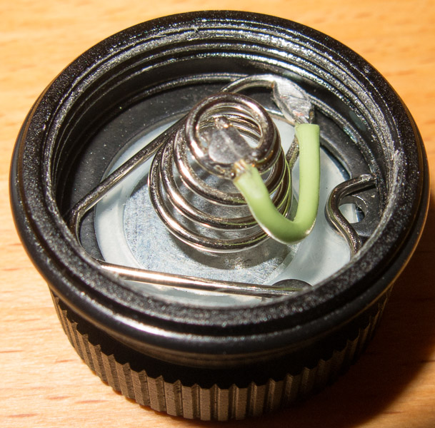

The Battery compartment is made from a blank aluminium pipe, no finish.
The pipe has a hexagonal shape, most likely with 6 light boards glued to it for heatsinking the LEDs.
The battery compartment cap has a strong magnet inside.
The outer side of the battery cap has an oring for waterproofing.
Both battery sides are got a steel spring make unprotected and protected cells fit.
The whole light is glued together, opening would destroy the light.
