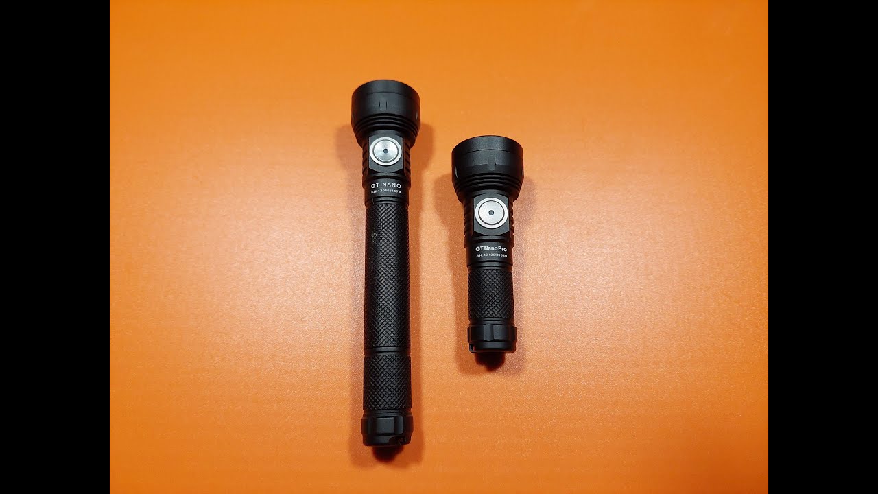

Recently I bought these 2 flashlights!
You may wonder “why both versions?” and I may reply “why not?”! :face_with_monocle:
The thing is, I guess these are better versions (in some ways) if compared with the previous ones!

Both flashlights are similar in user interface with memory mode for the 3 main modes, shortcuts to Moonlight (press&hold from OFF), Turbo (2 clicks from ON or OFF) , Strobe - SOS - Beacon (3 clicks).
Lock on/off with 4 clicks and enable/disable the switch light with 7 clicks.
Note that if you previously used Low, Medium or High, if now you press&hold to access Moonlight and then want to proceed in the mode progression, it will jump from Moonlight to that last used/memorized mode, unlike the Olight UIs, in which you can advance normally from Moonlight to Low.
The small battery 10280 (3.7V, 300mAh) and small tube are included in the pack, while 10750 (3.7V, 700mAh) battery and tube may need to be purchased separately (like I did with the GT Nano Pro).
The Nano puts out 700 lumens, while the Nano Pro goes up to 1600 lumens. Both get HOT pretty quick, since they are still small and thin.
These lights can be used as keychain or EDC flashlights.
They can also be used with the 10180 and 10440 batteries and even with 3xAAA batteries if you have the longer tube!
USB-C charging is a plus, and I only miss a lower Moonlight and the battery indicator from the Narsil versions!
The Nano V3 has some shift in the hotspot, which only bothers you if you are white wall hunting, and the Nano Pro V3 has 3 Cold White non-stated leds, which are CW but not that coooold to the point they freeze vision. Of course, High CRI 5700K Leds would be better :innocent:
