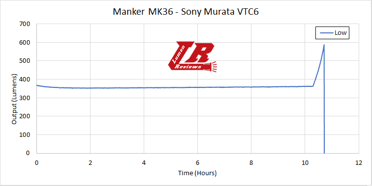

Output and runtime
Tested with Sony Murata VTC6 button top unprotected batteries.

The Turbo mode only lasts few seconds, but before the stepdown, the head of the MK36 measures almost 70C, according to my thermal camera.
It is impressive that such a small light can produce an ouput of 3000+ lumens with minimal stepdown after several minutes.
