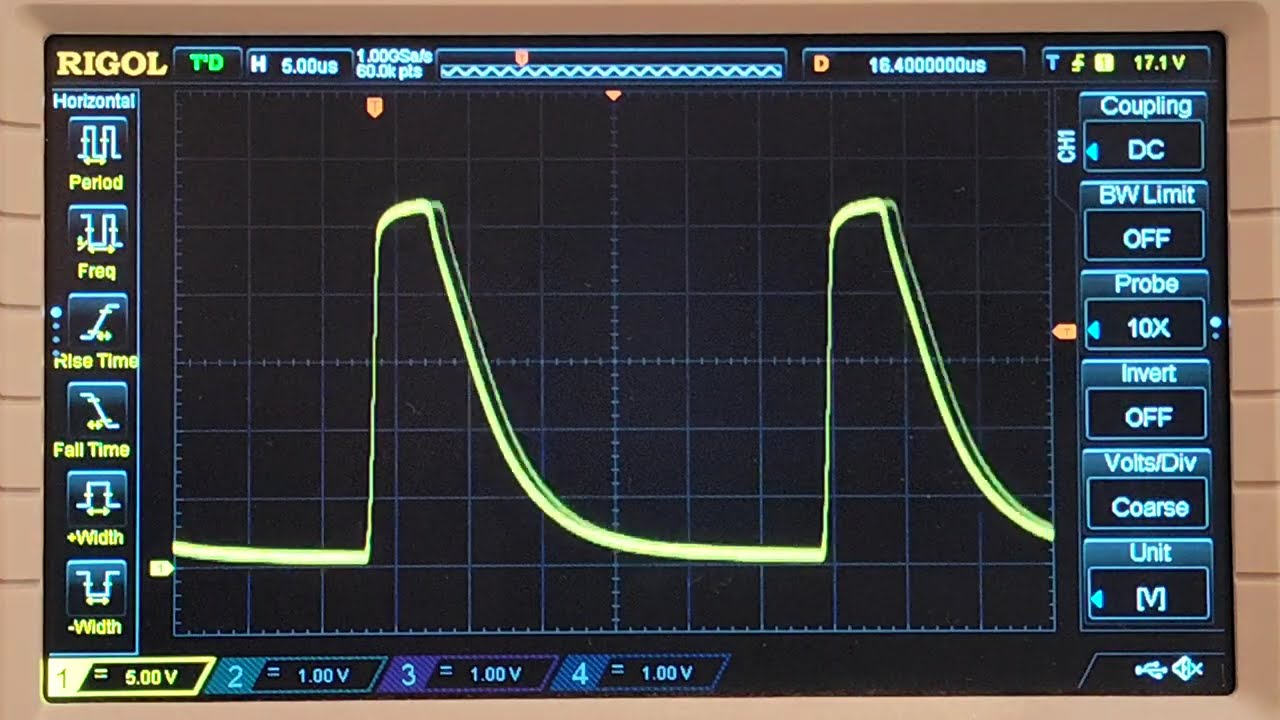

The brightness is controlled using PWM at 32 kHz. As far as I can see, there is no low battery warning. If the battery drops below a voltage of 2.75 V, the flashlight switches off to protect the battery from deep discharge. However, the brightness drops long before this. Apparently the LED has a high forward voltage.
