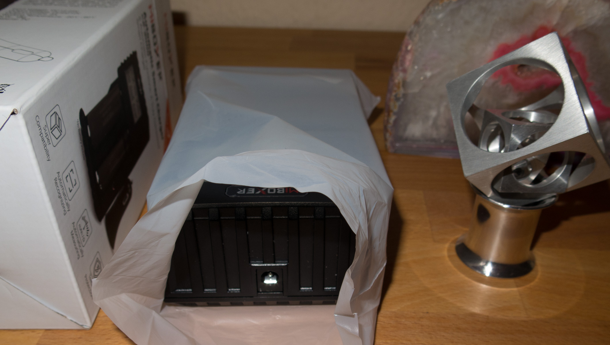

Packaging has improved for this charger.
The shipping is a lot more expensive than the charger build costs.

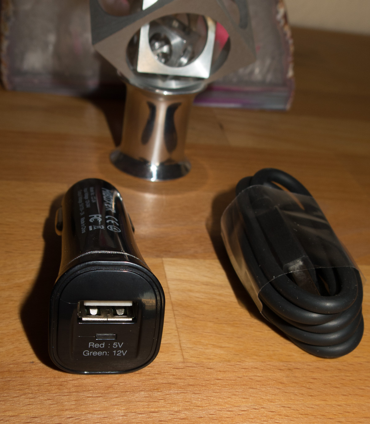

- Car power adapter
- USB to hollow plug cable

It comes with an USB cable it has also a 12V car adapter.
It is powered by the car USB adapter with 5 and 12V.

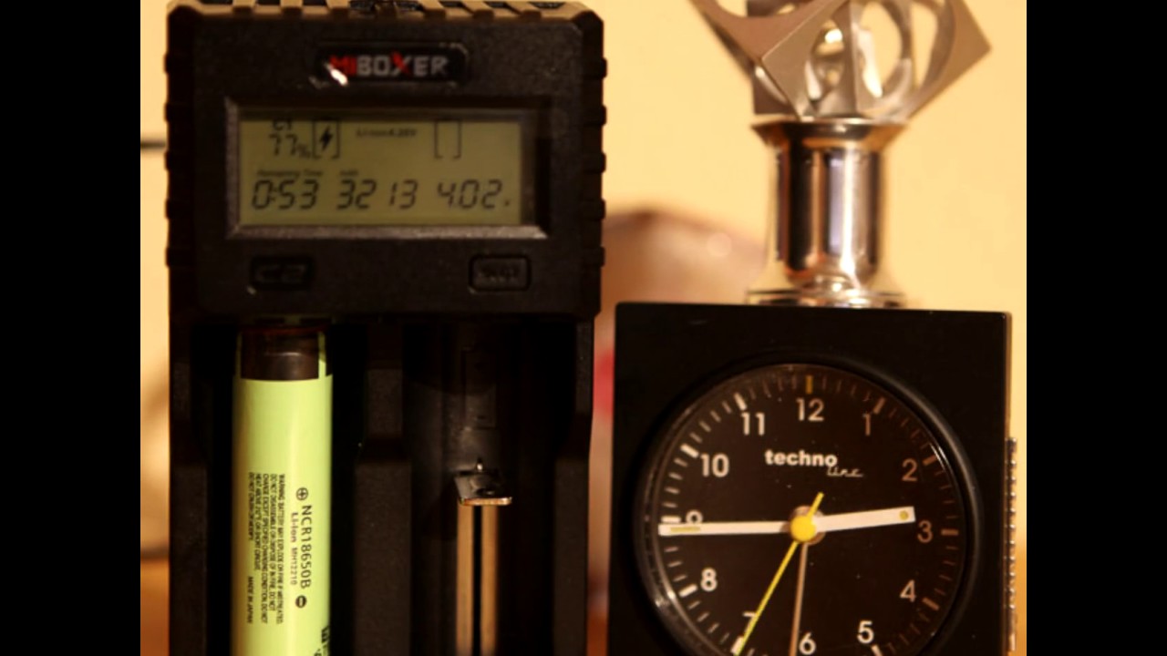

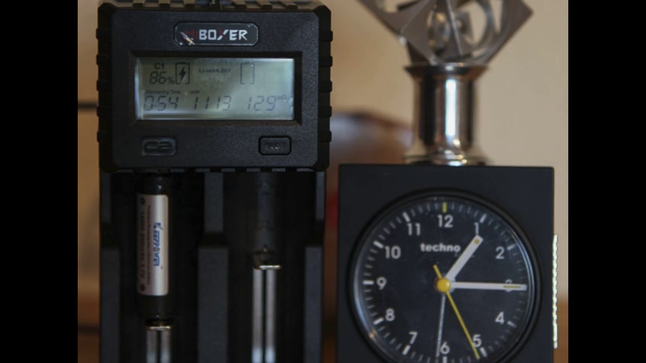

I did some time lapses.
You can see thast afer an initial charge it starts to calculate the total capacity.
Panasonic 1860B protected
was during day, so exposure does not fit when sun shined in the room.
Charged with 0.95A
Keeppower 14500 protected
Charged with 0.6A
The predicted capacity is was off, always too big
Klarus 18650 protected Sanyo 18650GA
Charged with 1.5A, the PCB is good and cell also
Eleloop AA
Charged with 0.85A
For all batteries I get about 5-6% less capacity in the end compared to my Klarus Charger
The charger saves up to 2 charge curves for your batteries to predict time and capacity,
if you got only one 18650 type and one 14500 type it should work better after charge curve saved.

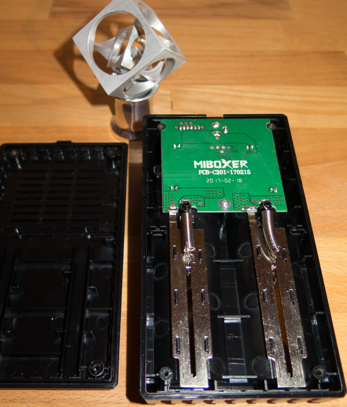

The first thing was opening the charger to look inside, how well it is build.

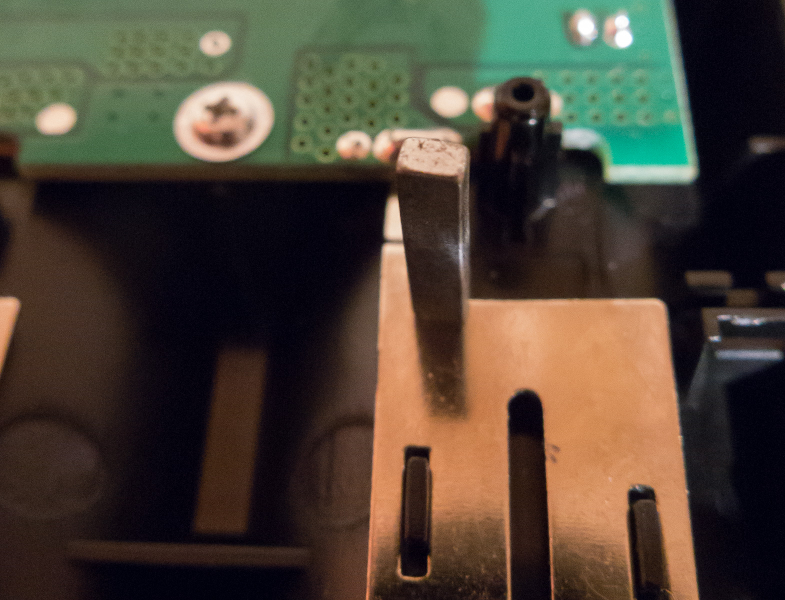

The charger uses rails with sliders to make contact, all contacts and rails are made of coated steel,
copper would be nicer but being steel seems not to affect the voltage readings much.
The sliders may lead often to wrong voltage readings like my Klarus CH4S charger had due to bad construction of the rails even if it was made of copper,
as there might be a bad contact between the rails and slider and the steel can have an increased resistance, which gets more important at high charge currents.
So first thing was to bypass the rails with copper leads.

The charger board is single sided the rails are directly soldered to it.

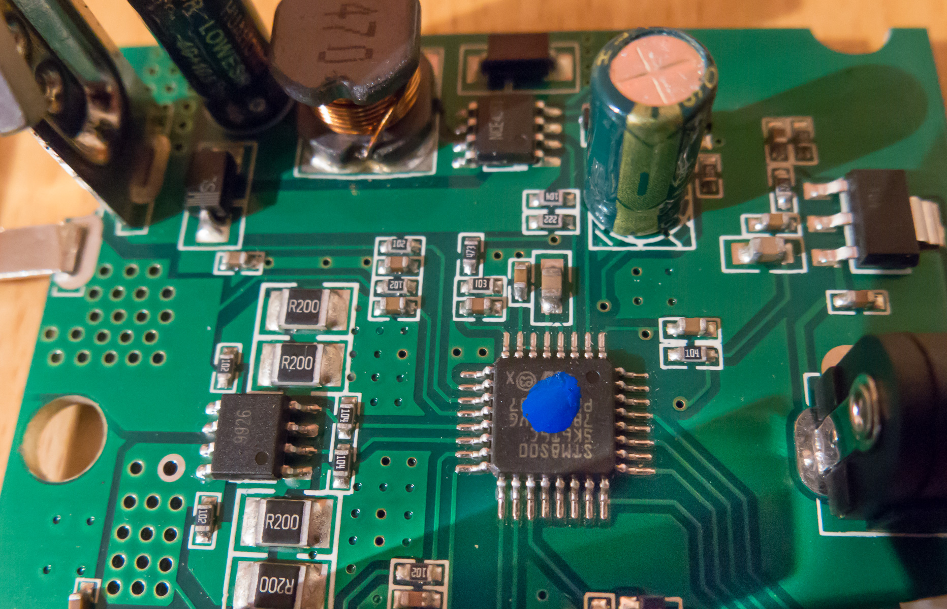

It has some nice inductors and 105°C capacitors.
The springs are not soldered like in many charger so there is no risk that they get loose.
The charger board is really clean the contacts are made of plated steel.
Both battery contacts have raised points to make contact to AA, 18650 and 32650 sized cells.
The contact design got changed from the first C4 sample, definitely better now.
The microcontroller.
