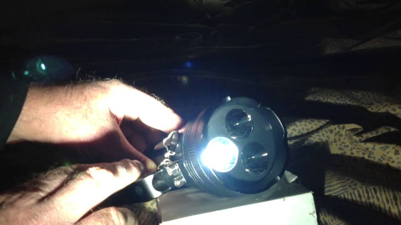

While its on my mind I just want to mention that I’m not sure if the lens is plastic or glass. When I removed it to take photos it felt kind of plasticky to me. I didn’t want to do a lot of tapping on it in case of scratches, but when I dropped it on some metal tools, it had made that glass clicky sound. I think I might have an AR coated lens here from CNQG that might fit.
Also you might have noticed a charging port beside the handle. I didn’t want to mention it, because it isn’t mentioned in any of the specs at any store. There is no charging circuitry on the driver, and it doesn’t come with any charging cables. I wouldn’t mess with it, it could lead to a big kaboom. I removed it entirely from my other build to make room for extra heat sinking. The plug that seals it has its own o-ring and I wouldn’t worry about water getting in. In a future build, I’d like to put a second switch there that would send it into DD or something. I’m going to have to send a close up to OldLumens to see if he knows what would fit there.
Seeing as the triple reflector isn’t really a reflector at all, but three small cups set into a rubber gasket. I was surprised at how bright this light is. A nice even flood. Actually, it is pretty close to my MT-G2 builds In its output and beam profile. I wonder how it will be after I stack a bunch of extra chips. But then again, I’m waiting on a 5 x XM-L reflector to see if it fits. Hell, I may have to order another host.

I like the idea of the 1-2-3 emitter start up as it would be great to start in low with a single warm hi CRI emitter, then add a neutral on med. and a cool white on high.
The bad part is it seems to have next mode memory…well…kind of. I found if I count to ten, it will go back to the single emitter low mode.
The slow rotating sequence of 1-2-3 is kind of neat. Just to please those people that don’t like the one emitter at a time Low-Med-Hi, the added another Med and Low that utilize all three. The SOS is very slow and spaced out. At least there’s no strobe!
I shot this little YouTube video for your viewing pleasure. If it seems that the output is not that bright, it’s because bright light shining into it just turns my iPad screen into a white hole. To compensate, I had to shine two MT-G2 flashlights directly at the front of the Nage in order to obtain balance.
