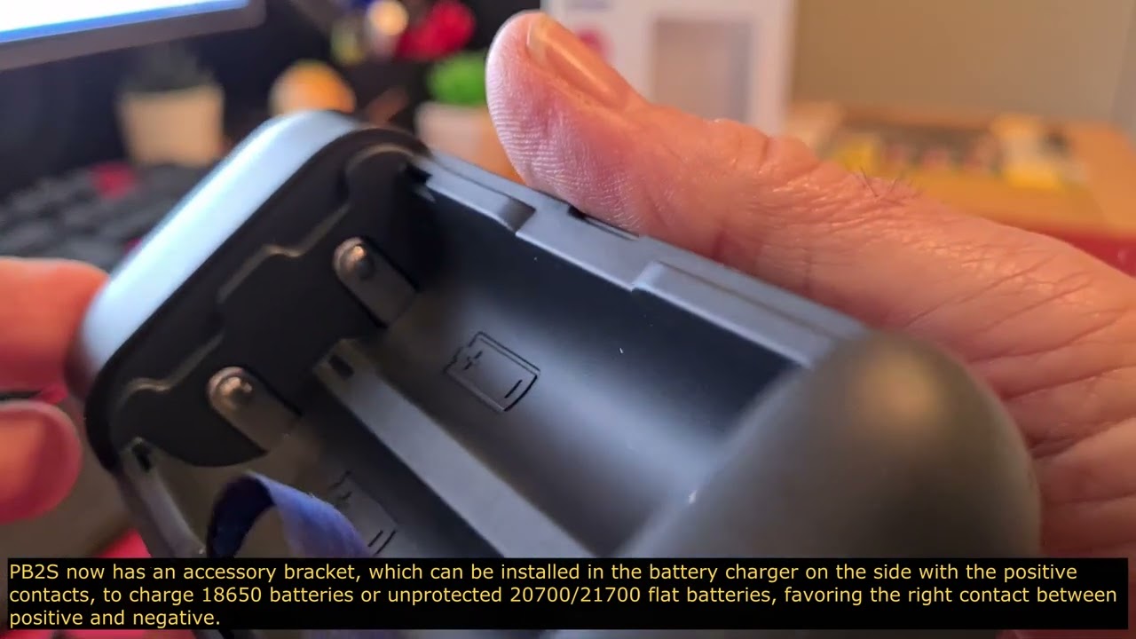

Internally the battery compartment is well done with the drawings for the correct insertion of the batteries printed in evidence.
Thanks to a built-in ribbon in the slot, it's easy to remove the batteries quickly.
PB2S now has an accessory bracket, which can be installed in the battery charger on the side with the positive contacts, to charge 18650 batteries or unprotected 20700/21700 flat batteries, favoring the right contact between positive and negative.
The negative pole of PB2S is made of metal material which has good conductivity and low impedance.
The magnetic top panel has a good hold and can be easily removed thanks to the two side recesses. In this new version there is a rotating buckle in the center to be positioned horizontally when charging batteries in 18650 format to keep these batteries in a fixed position without them being able to move.
