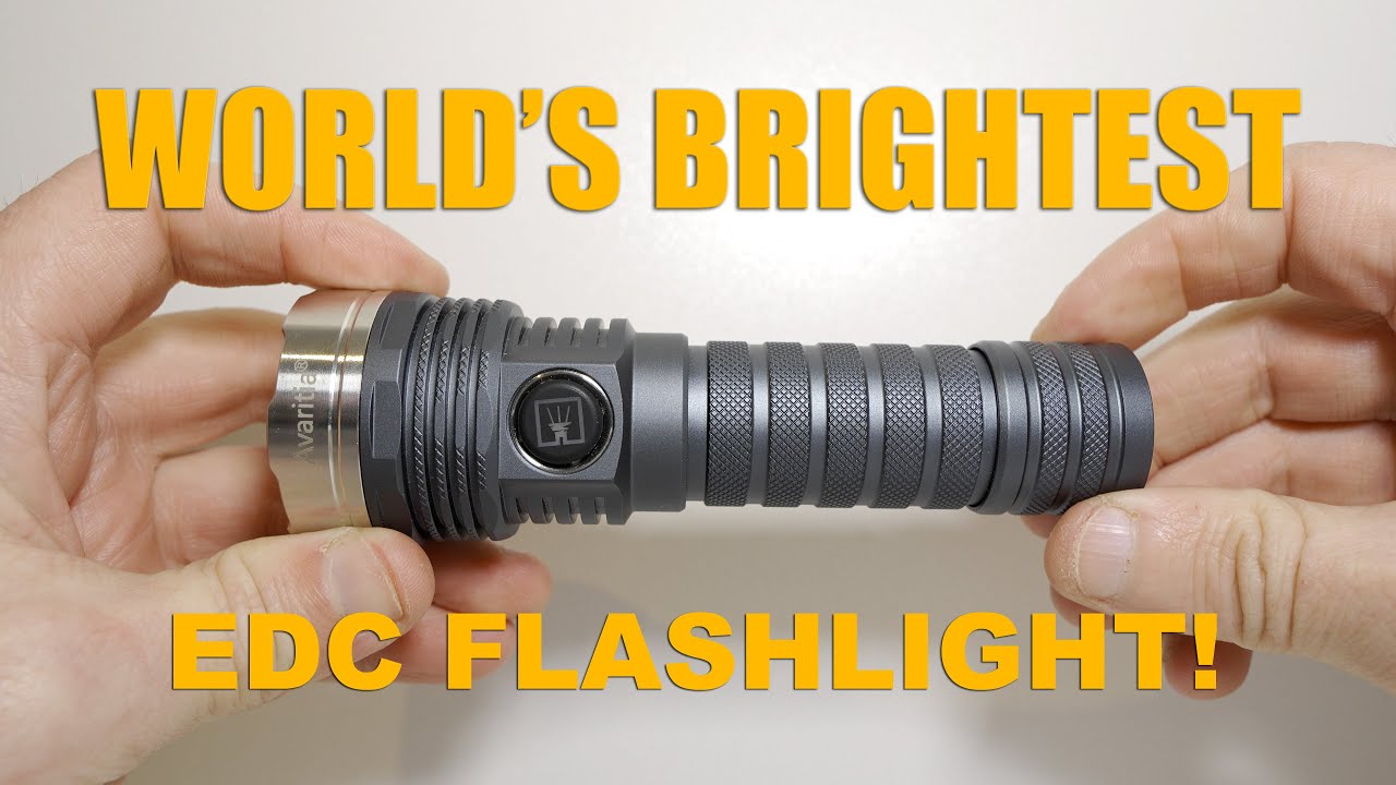

Nightwatch Avaritia A54U - 22,000 lumens EDC flashlight!!!
With a warmed up MOLICEL P50B, the Nightwatch Avaritia A54Ultra is nearly 4000 lumens brighter than the previous record holder, the CYANSKY P50R…

Nightwatch in particular is one of the worst worh fibbing specs. The A15 advertised 94,000 but i only got a hair over 60,000. The NI03S said like 17 or 18000, but i think peak was 13000 and some change (still, it’s still the brightest single cell flashlight in existence per my testing). Not surprising. I tested the A54u also and will have it ready shortly.

It pulled 49 amps at the tail, so probably a bit more than that. Output per my testing on the stock cell was just shy of 14,000 Lumens. 3v x probably 54 amps is around 85lm/w. That’s a rough estimate.
I can get hold of an Eve 21700, which should beat the P50B.
You’re right on. JP40 strikes again, my just-arrived A54U, with AM04 battery, a twin of the JP40:
Turbo turn-on, measured w/ Texas Ace lumen tube:
Molicel P45B: 15000 lm (about same as @The_Flashaholic’s number 14672)
AM04: 17270 lm

Yeah at least with my amateur testing of Turbo turn-on outputs, all 3 of my AM04’s are THE real thing. Consistently/repeatedly beat Nealsgadgets Mystery Lishen, Nightwatch XP45, and Molicel PB45 when tested with the most current-hungry single-21700 lights in my small collection: NS14R v2 (21300 lm) and now this A54U (17270 lm).
The latest rounds of defeated victims, now including 45XP:
Austin M. AM04: 17270 lm
Nightwatch 45XP 80A: 15650
Molicel P45B: 15000 (about same as @The_Flashaholic’s number 14672)
The test report has results for the other wrapped versions of the JP40, the LT22710A and Ampace-wrapped. They’re all very close, same cell after all, but the AM04’s were a touch worse at high power levels where any differences are magnified.
Try the EVE 40PL too…holds its voltage higher than the JP40 at 40A-100A after about 75sec - 20sec (respectively) in my testing. Under 40A or so the JP40 holds the slight edge.

EDIT - WARNING: The Nightwatch Avaritia A54U’s built-in USB-C charging system is badly malfunctioned. It continues to charge the battery after the battery is full, resulting in dangerous over-charged battery voltage. One of my AM04 batteries showed 4.65V during charging, two other AM04 batteries completely stopped working (now showing 0.3V on my DMM).
Xpost - fun moment the outrageous output was recorded. Sorry $39 cost was only during Xmas sale. For size reference, the light next to it is Convoy M21B (with fantastic Nichia B35AM 4500k LED).
