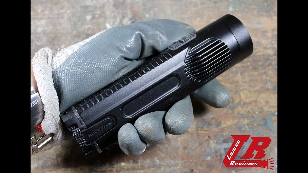

The light is well built and finished.
I have always been a fan of the “side to side” lights, because they make the light more compact and easier to use. The rectangular rounded body of the EC4GTS feels much better in my hand than a slimmer and circular one.
Also, the monolithic construction helps incredibly in the heatsinking aspect of things, as you can easily see from this thermal video. A light thus built is able to run for longer periods of time at higher output than a light made out of single pieces. You can easily observe this in other lights that have body and head as separated pieces.
