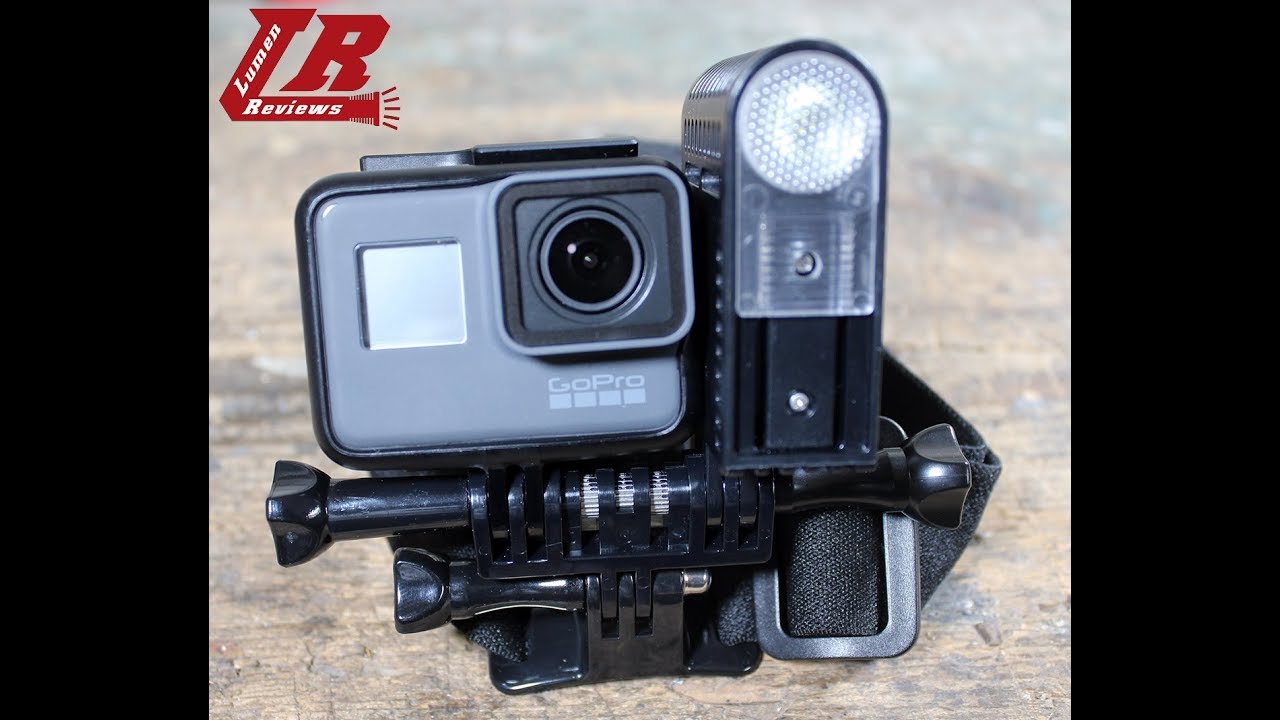

To be a good action camera light, you need to effectively pair it with the camera. This is done with the provided mount that you saw in the previous pics. Here’s with my GOPRO 5.
Here is mounted on my headband.
