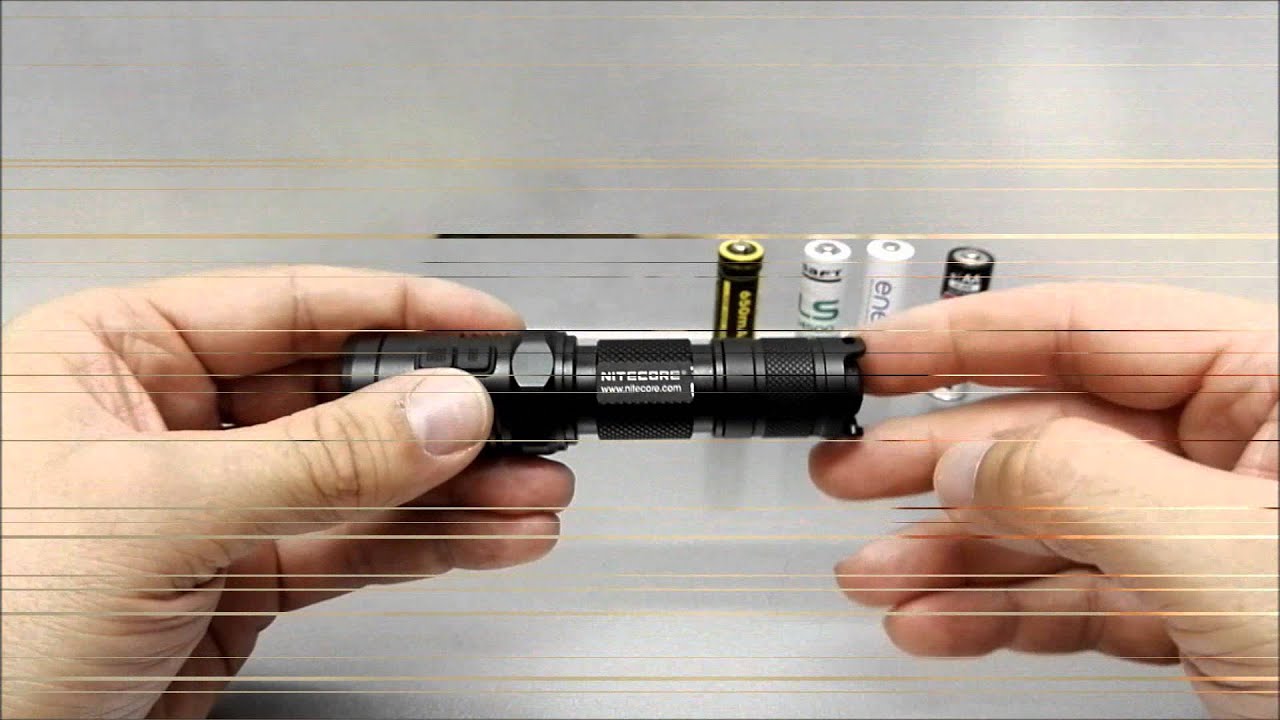

a size comparison:
Manker boney - nitecore EC11 - eneloop AA - nitecore MT10A - trunite Archer 1A - BLF A6 SE - Fenix PD25 TAC - a 18650 cell
the participants for Ampere / Lumen measures:
results (i cannot measure <10 Lm, all other corrected to "Fenixlumens")
