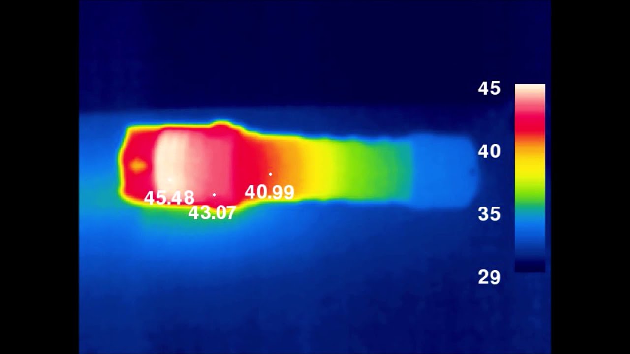

Thermal Video

The tested levels are well regulated and there is a thermal sensor that limits the output depending on the temperature of the internal components, and it works well.
I like that the P20iX is able to sustain consistent output without drastic stepdown, even when not cooled (this is very clear in the Higher/High plots). This is also due to the large capacity (5000mAh) of the included 21700 battery.
