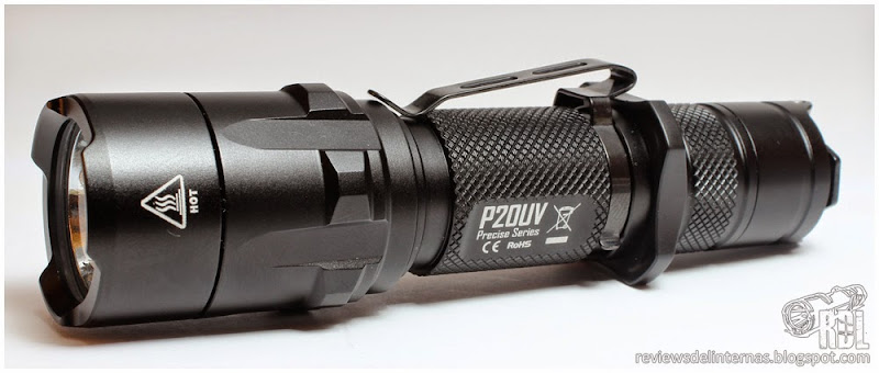

Except for the changes in the flashlight optics to provide ultraviolet light, the rest of the P20UV is exactly the same as the P20.

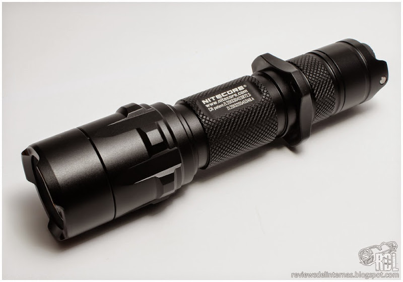

This is a simple and relatively compact tactical flashlight with a head diameter of about 32mm, and a total length of 135mm.
Made of black color anodized aluminum, the body of the P20UV has several laser engravings all perfectly defined and very easy to read with high contrast between white lettering and black background.
The head of the flashlight features a bezel, also in anodized aluminum, topped with three discrete crenellations. The neck is topped with a machining that prevents the flashlight from rolling when placed on a flat surface.

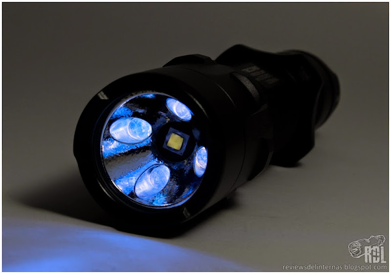

The optic of this P20UV is quite unique. In the center we have an XM-L2 perfectly centered by a black centering disc. Four equidistant holes house the small UV LEDs. The reflector now becomes textured, presumably to avoid aberrations produced by the holes for the UV LEDs on the beam for the white XM-L2 emitter. As always, optics is finished with glass lens featuring AR treatment, common in all the flashlights of this brand. Inside of the head we can see the circuit, which dispenses the spring for positive contact seen in other flashlights in this range, but still incorporates a classical mechanical protection against the installation of batteries with reversed polarity so that the flat top batteries will not function correctly.

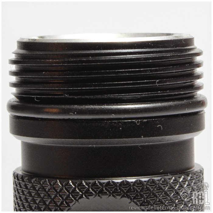

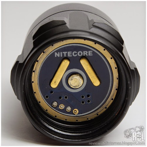

Head threads are trapezoidal head cut, and are anodized. The tailcap threads have triangular cut tailcap and match the ones also found in the P12, P25, MT2C, MH2C … so the remote switch accessory to use the flashlight installed on a firearm, is compatible also with this P20UV.

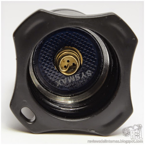

Finally, in the tailcap we can find much of the charm of this flashlight, and its user interface will discuss in detail later. This tailcap has as novelty a system Nitecore has now, although already seen in some Klarus tactical models, where we have two separate buttons on the same plane tailcap: We have a forward switch, with the design of the coating common with previous Nitecore flashlights, slightly off from the center of the flashlight. This switch profile protrudes, easily identifiable to the touch and quick access. Along with this, we found a flat lever with the inscription “MODE” for changing modes and “Strobe Ready” function. This lever acts on a small button hidden under it. Unlike as P12 with or similar to previous Nitecores, the P20UV switch is not removable and the circuit appears to be directly embedded rather than threaded. Of course, this flashlight can’t tailstand.

On the side of the UV light, and making it clear from the beginning that my experience with this type of ultraviolet light is scarce, I will say that I was pleasantly surprised when comparing the tone of the UV light of 365 nm versus cheap ~400nm alternatives.
The P20UV emits very little visible light, and the predominant tint in this is white unlike other economic UV flashlights in which the highly visible violet light predominates. Contrary to what happens with the Nitecore Chameleon CU6 with 3W UV powerLED and own full reflector in the P20UV UV light is for short distances.
Here is an animated comparison of the UV light on two distinct areas: a fluorescent (a large sheet of white printing paper) and a non-fluorescent (a wall of my house). You can see how there is a difference between the light generated, especially in the P20UV that on the white paper creates a beam of violet / blue light while shinning on the wall only produces little light, and almost all white .
The economic flashlight with 395-410nm light generates much more visible in both scenarios; absolutely dominate the purple tint on the non-fluorescent wall.
Difference in visible light, Nitecore P20UV • Uniquefire 602C-UV
The beam profile of the four UV LEDs is also surprisingly good, without the typical artifacts that one expects from this type of assemblies with integrated LEDs into reflective surfaces such as in the SRT range.
In this animation we observe that the wavelength of the UV LEDs generate P20UV lot less visible light, so the fluorescence effect is much more visible. On the 50€ note see how the fibers are illuminated in all tones hardly distorting the print color scheme of the note, which the budget 3W light fails.
